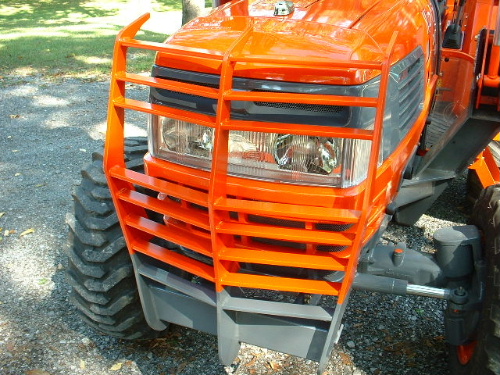

Didn't think the factory guard complimented the stylish DK40 so I made one with a few curves,I'll post a few pics....Mike

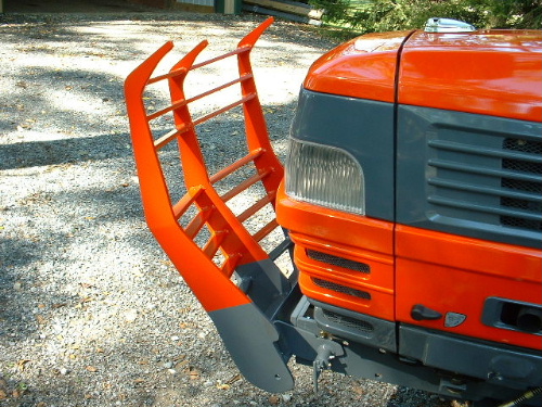

Here it is unlatched............Mike

Mike,
Very nice work. How did you cut out the 3 sculptured pieces?
Jack
   / DIY grille guard #4
Mike,
Where do I send the check????I need one of those for my DK40 too.Very nice.

Thanks Jack, My original plan was to have my son plasma cut the 3/8" stock but,he was out of town and I was getting antsy.
So I cut the pieces using 6" waffer wheels on a 4" angle grinder and a sawsall.
Only a retired guy(with lots of time) would use this Flintstone approach.............Mike
