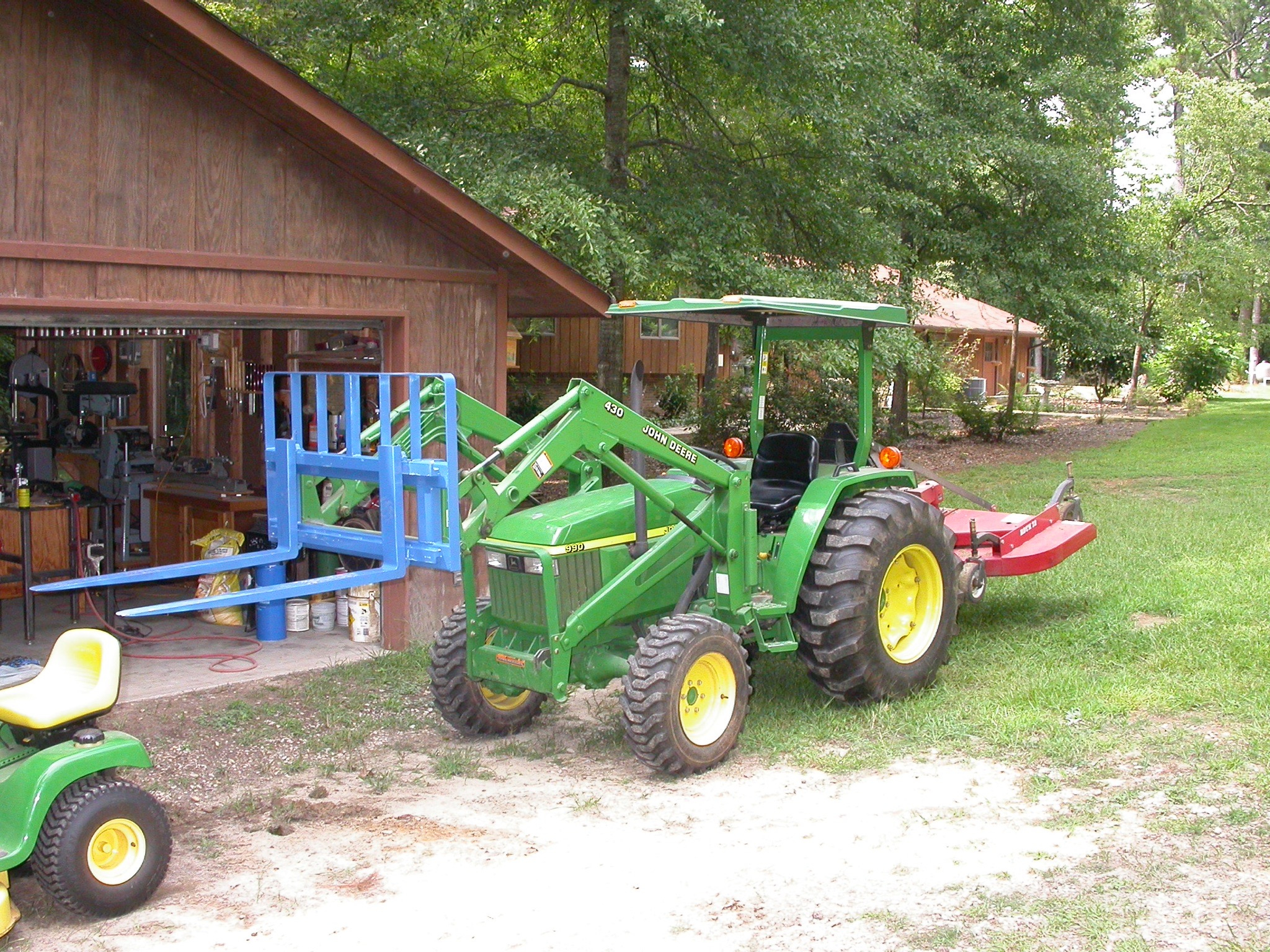

Built this set back in 2006. Still going strong in spite of criminal abuse.

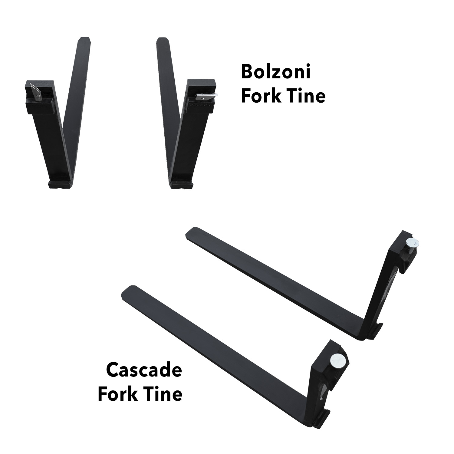

Interesting topic! We love to see your innovative ideas on making your own forklifts. If you are looking for something which is more robust, check out Artillian Attachments for pallet fork frames and forks.
Happy lifting!
-Curtis Industries LLC
