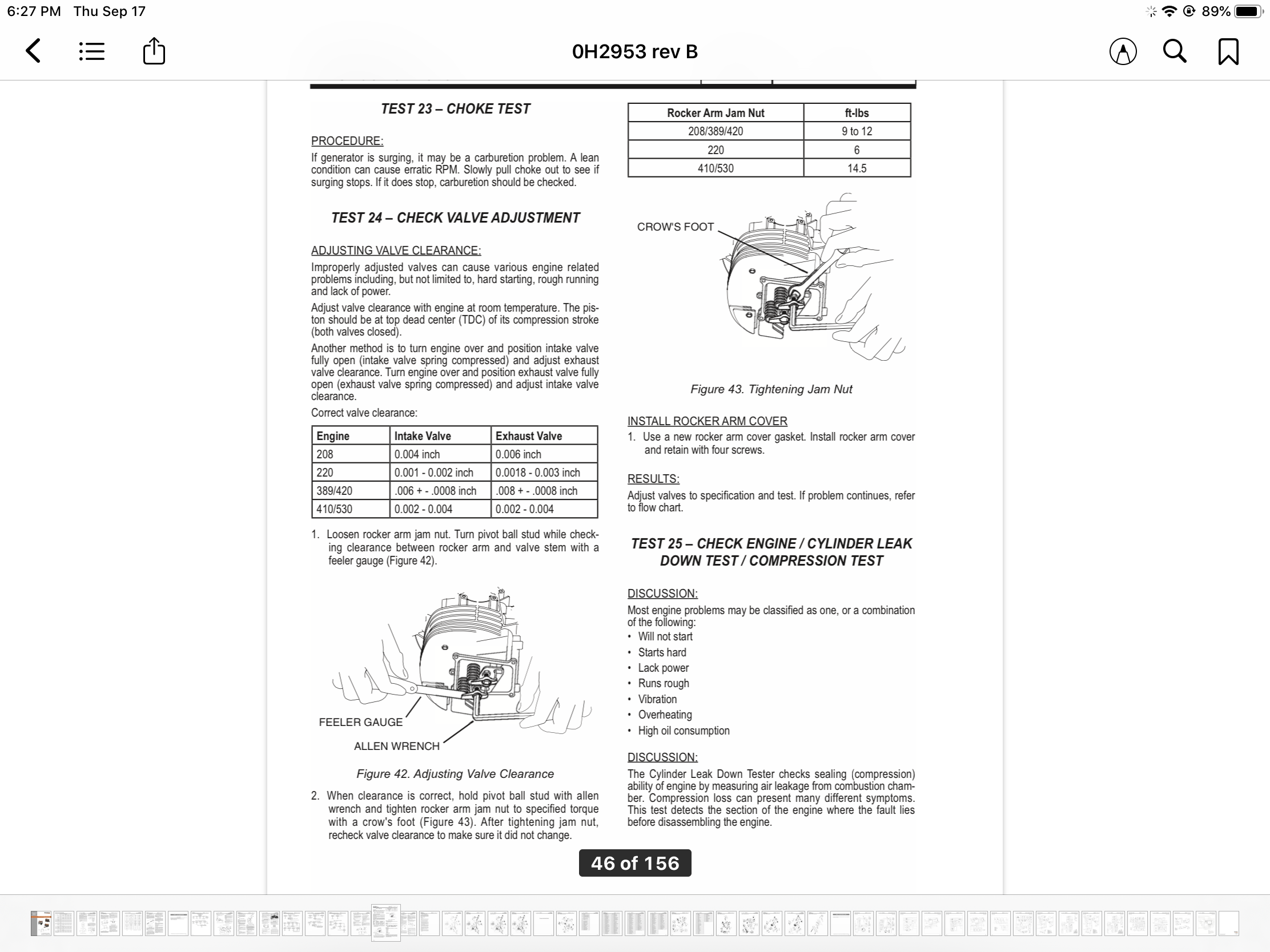

Before you pull the heads, you need to try a real set of compression gauges, and check valve clearances. Without knowing exact engine, its hard to, say what valve clearance should be, but generac generator engines are set to .002 - .004”. I just have no idea what yours should be without knowing engine. Generacs gas generator diagnostic manual shows the following for gas generators. Correct valve clearance:
/ Dixie Chopper with Generac Engine #5
