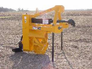

I know this isn't really what you were looking for, and I'm not aware of a 15' version - I have seen doubles though, but thinking about what you are doing, wouldn't something like this work? The rice farmers 'round here use them all the time to ditch the water where it needs to be.
Maybe I'm thinking too far outside the box.

I have 2 of those. They are trenchers, not ditchers. Used around here to get water off of crops. The Sidewinder version is really nice because the blade runs in the right tire track.
