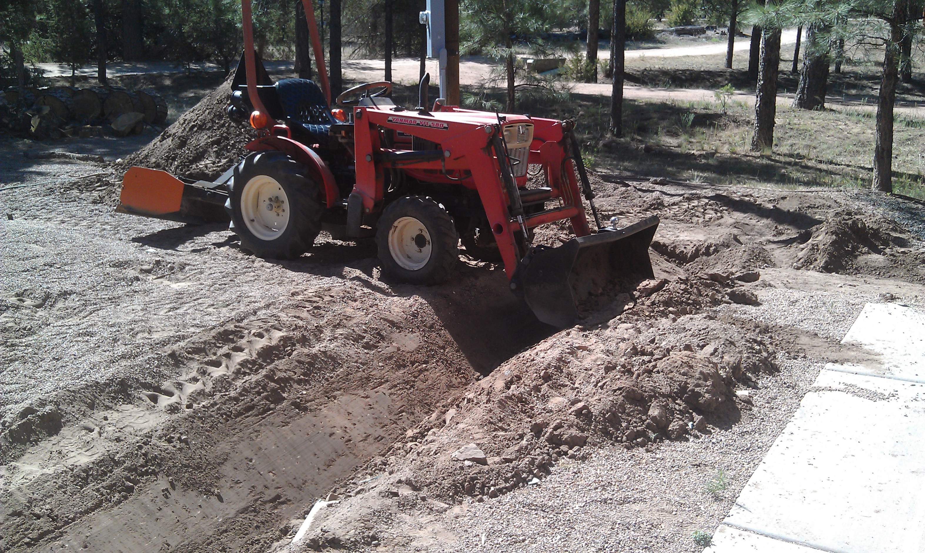

Here is a picture of a trench I cut using only the box blade. I actually put the tires in the trench to keep cutting deeper. I actually got down 22-23". Notice the box blade tilted in the picture.
Dave

That trench looks pretty good but if you are going to leave it open I would wan't less taper for good grass cover.

Good job on your ditch, we have done ditches similar to that, but for our swales, like jenkinsph, tapered them quite a bit more and planted grass. Our ditches tended to erode fairly quickly due to our heavy runoff.

If you noticed my text, I called it a trench. I buried a plastic water line in it. I only used the picture because it showed the angle of the boxblade and what you could do with it.
Dave

Pardon me for being so presumptuous. Yes, I noticed the trench, but didn't realize it was a trench to bury something then cover; only pointing out my experiences with trench/ditch/swales. Nevertheless, as I said, good job on your ditch, correction "trench".:thumbsup:
