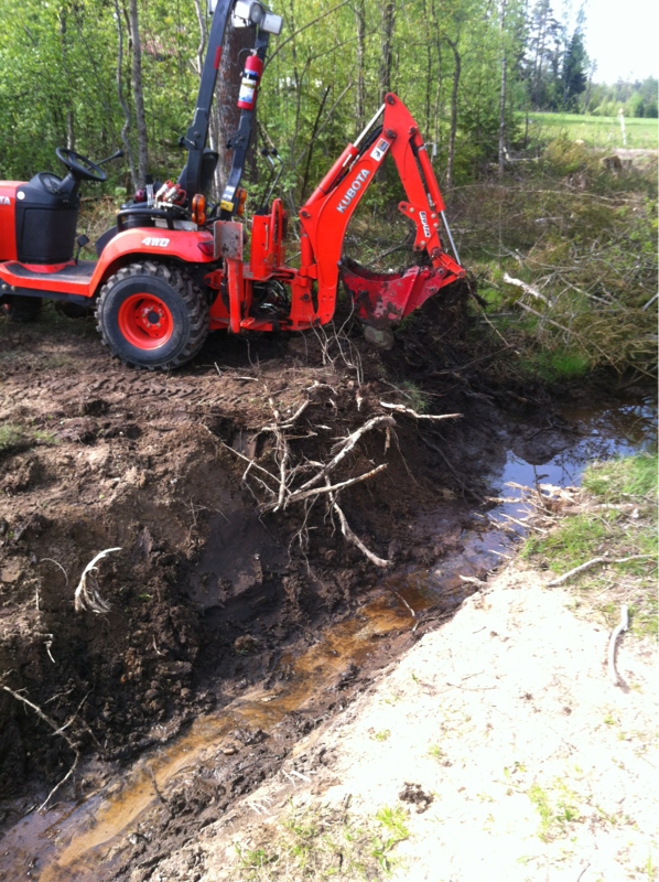

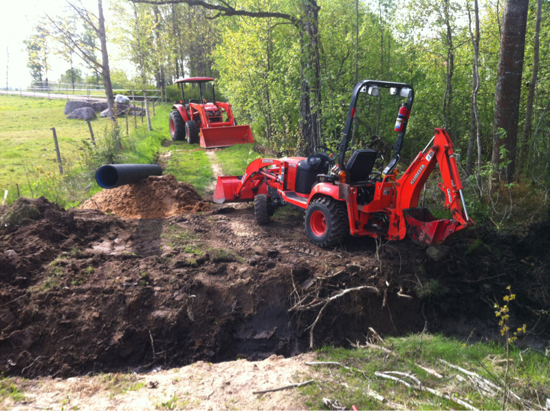

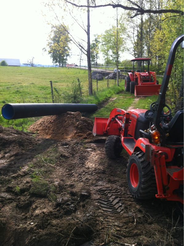

Hi. Because of bad water flow I needed to change and lower the old waterpipe with a new one. All rental escavator where all out, so I went for my BX . It worked well and I was impressed (again) what this little machine can do.
You need to plan more accurate becauce of the limited reach of the backhoe, but if you do that the BX works just fine.

Always good to see a BX in action!
/ Ditch digging with BX #3
I see his Big Daddy was there watching him work.:)
/ Ditch digging with BX #4
Looks great! You are correct on the limited reach though, extra planning is needed.

Jepp! He cant be alone in the woods...;)

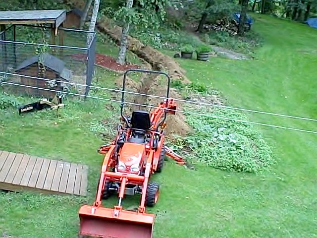

You are right about the BX's being great for ditch digging. My BX25 dug this trench for underground utilities. In your neck of the woods, it was over 50 meters long.

how was this? i'm about to embark on something similar in the next weeks and am wondering just how long it's really going to take. need to dig about 200', 40" deep.
as you were moving along the trench were you able to raise the bucket and scoot the tractor along with the backhoe, or do you need to actually drive forward.
/ Ditch digging with BX #8
you can use the bh to push you along. Sometimes you do have to get off and drive the machine forward, like if there is any rocks holding you back.
one thing is because of the BX's small wheels, crossing a trench can be an exciting experience. Using the bh to lift the rear over sometimes works, but due to the limited length and strength of the BH it is iffy at best.
If you have a trench where you can drive away at the end its best.
A 200' trench will take some time depending on your experience and ground. The BX bucket is small. Several weeks ago I trenched about 75' to a depth of 2'. With the sticky clay, rocks and roots, it took me half the day. And I know how to run a backhoe pretty well.
