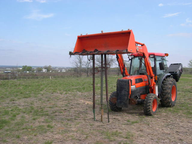

Well, I put a pipe sheath, closed on one end, over the posts... keeps bent posts to minimum.... and, for me, rock can be maybe 1 to 4 inches down... so hard drives DO happen.

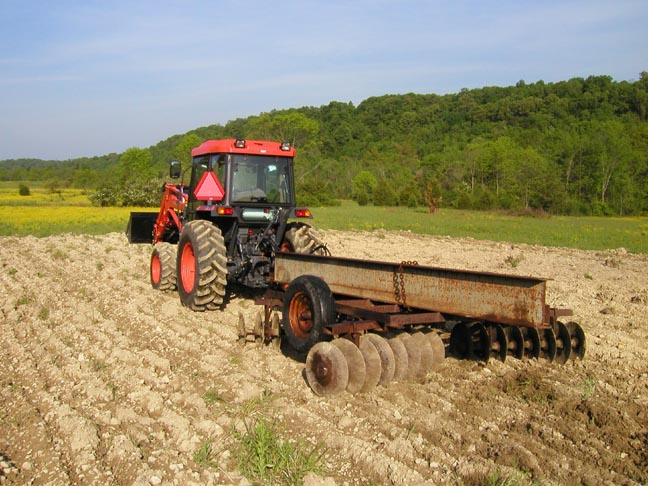

I am pulling an old 11 ft transport disc using a 45 hp 4wd tractor with no problems. Our ground is heavy, flinty sod. The disc has a big steel I beam on top of it for weight.

that's cool and a good idea, gonna guess that you bent a couple and talked to the mother of invention? :D :

good example of how the ground makes a difference. Tha disc with all the weight isn't getting real deep into the ground looking at the pics.
But in sandy loam my lightweight 5' disc is burried to the axle. In this soil it doesn't matter the disc size. They will all go up to the axle and have to be feathered a bit to keep from burying the tracor.
