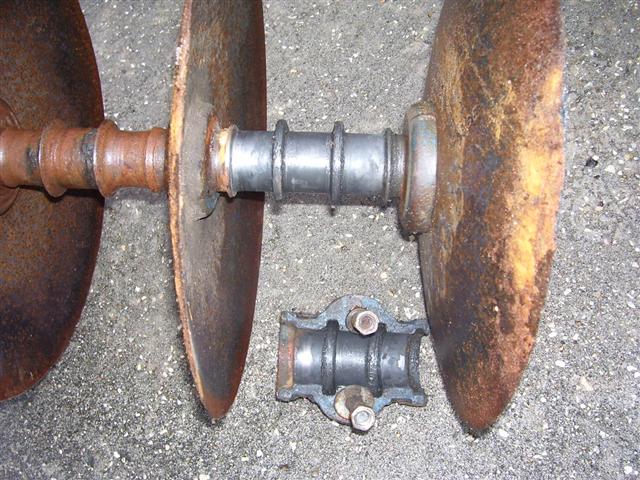

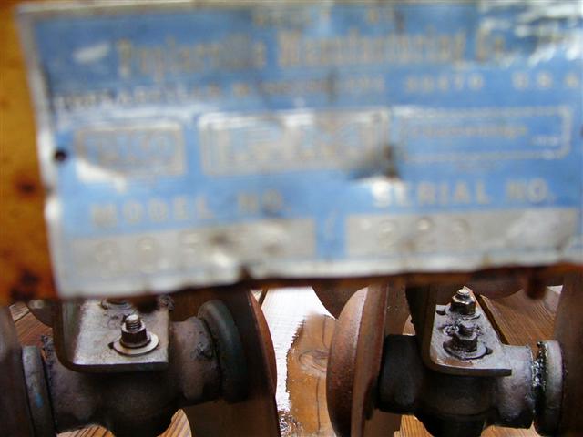

My 5' disk has the box type bearings. I learned after posting here they are also called gray iron bearings. They do wear but you can get new ones. As someone mentioned it would depend on how much you use it. If you are doing a lot I would get the so called sealed. Around here with the sand they will last a few years, they are pretty easy to change out and aren't that expensive. TSC carries them. When I looked the heavier disks had the sear bearings. For light duty stuff my $200 disk works fine. But I will note that when using it in the late summer last year the gray iron would heat up...even as slow as i go.
Rob
