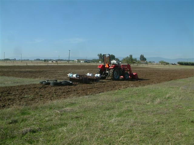

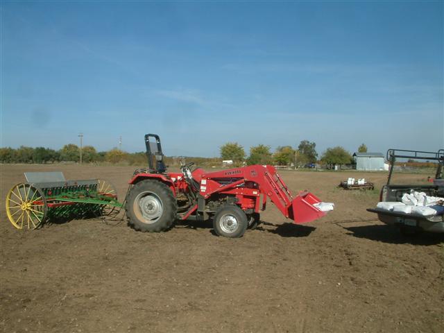

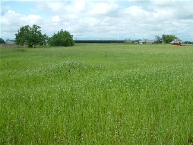

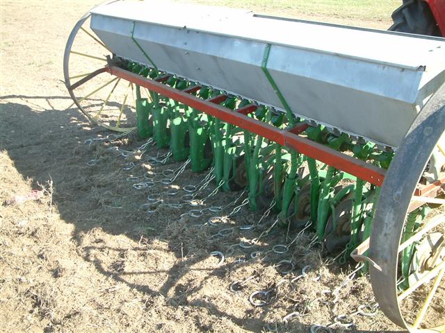

Plant what? Last Oct I planted Kanota oats on my 5 acre hayfield. Flat pasture land that hadn't been farmed in decades. I cut the weeds with the brush hog, ran the 7-ft offset drag disc over it twice in criss-cross patterns and planted with my restored Minneapolis Moline P3-6 grain drill (10 ft wide, 20 drops). I'll be mowing, raking and baling in 3-4 weeks.
My soil is gravely and thin, so plowing is out.

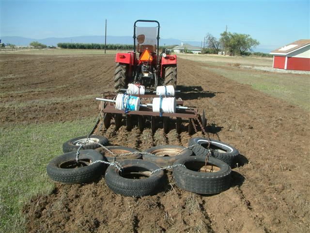

Find yourself a used 6-7 ft wide disc and a broadcast spreader. That's all you need for a food plot. Drag a log, steel pipe or tires behind the disc to break up the clods and smooth out the soil. Then broadcast your seed.
My neighbor gave me my 7-ft offset drag disc, another supplied the tires free and I bought the grain drill (actually two drills) from my neighbor for $275 plus about $100 in parts to refurbish the drill. Spent about $160 for seed.
You don't need to spend a lot of bucks to do food plots if you shop around for used implements and free stuff.
