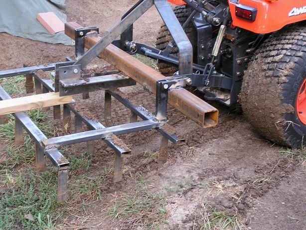

You could make a row or two of teeth similar to what I built as a harrow.

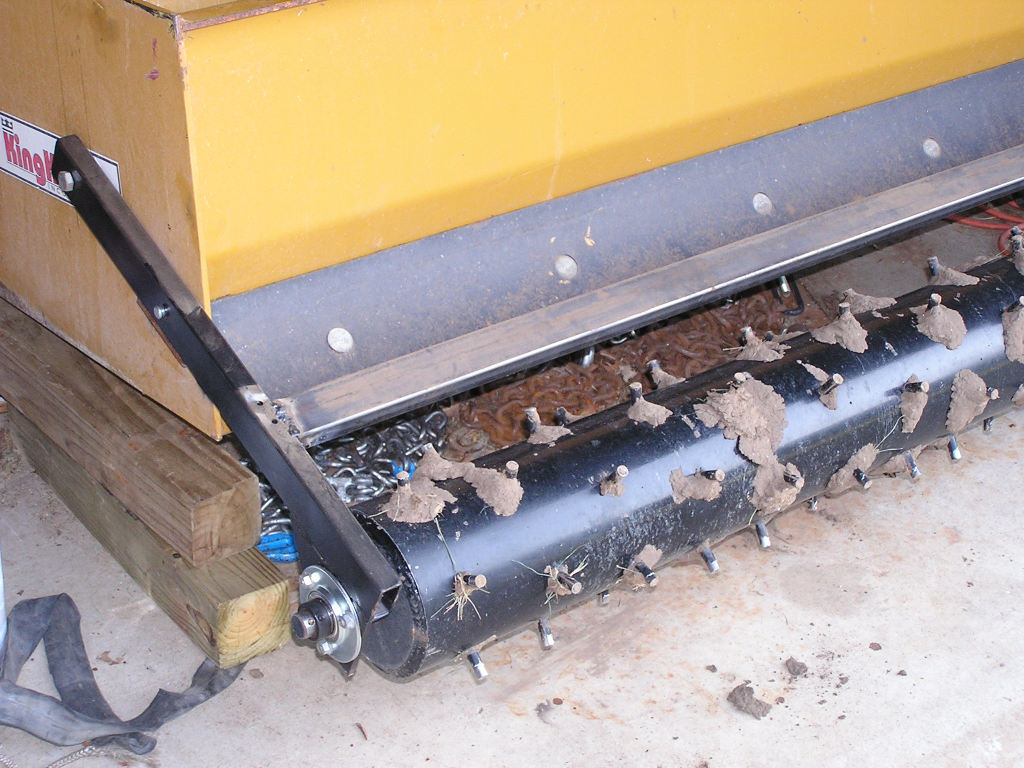

Or, like I added a pulverizer roller to my box blade for seedbed prep. When I use the roller, I don't engage the bb.
Post a pic of what you do pls.

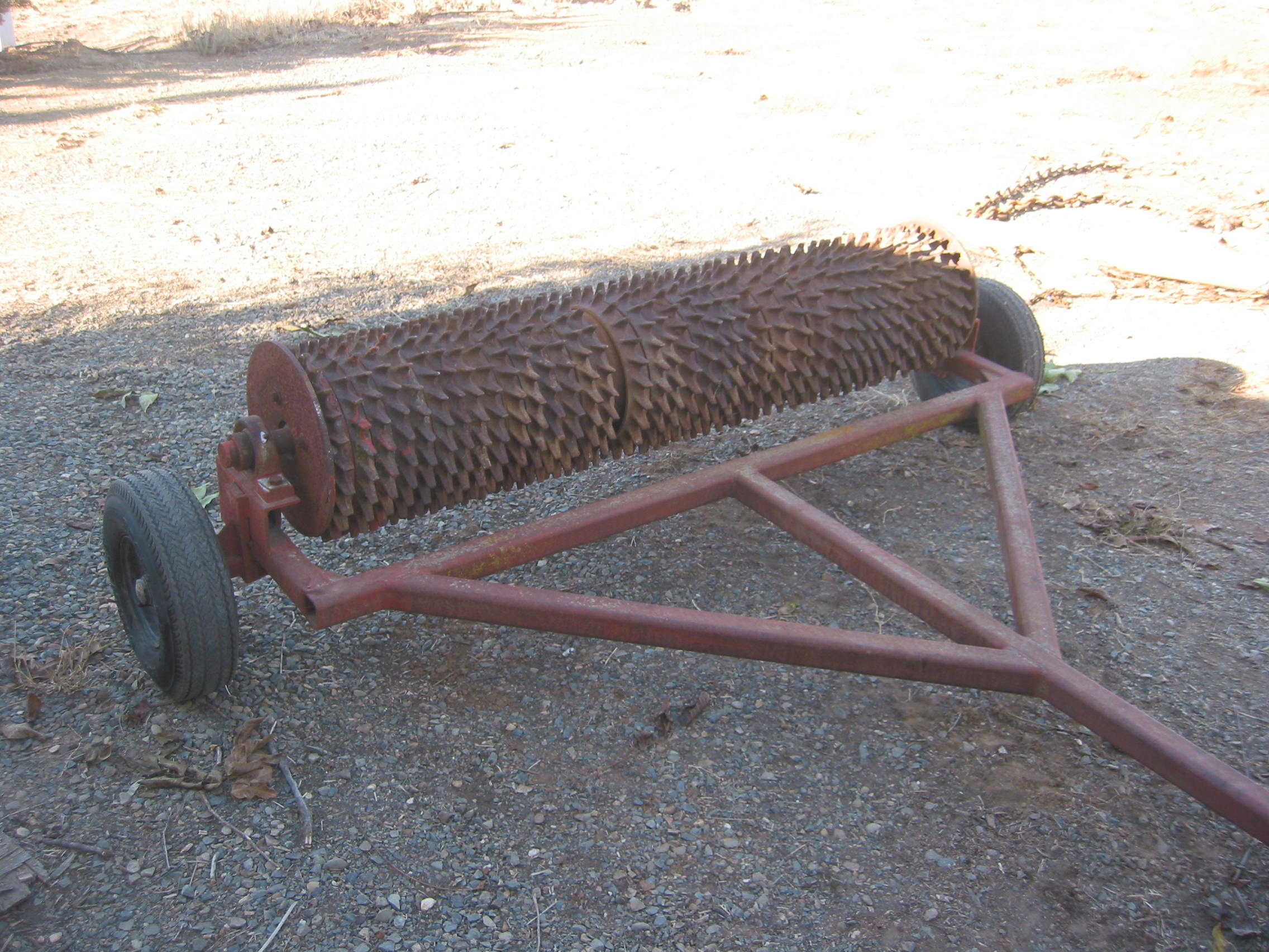

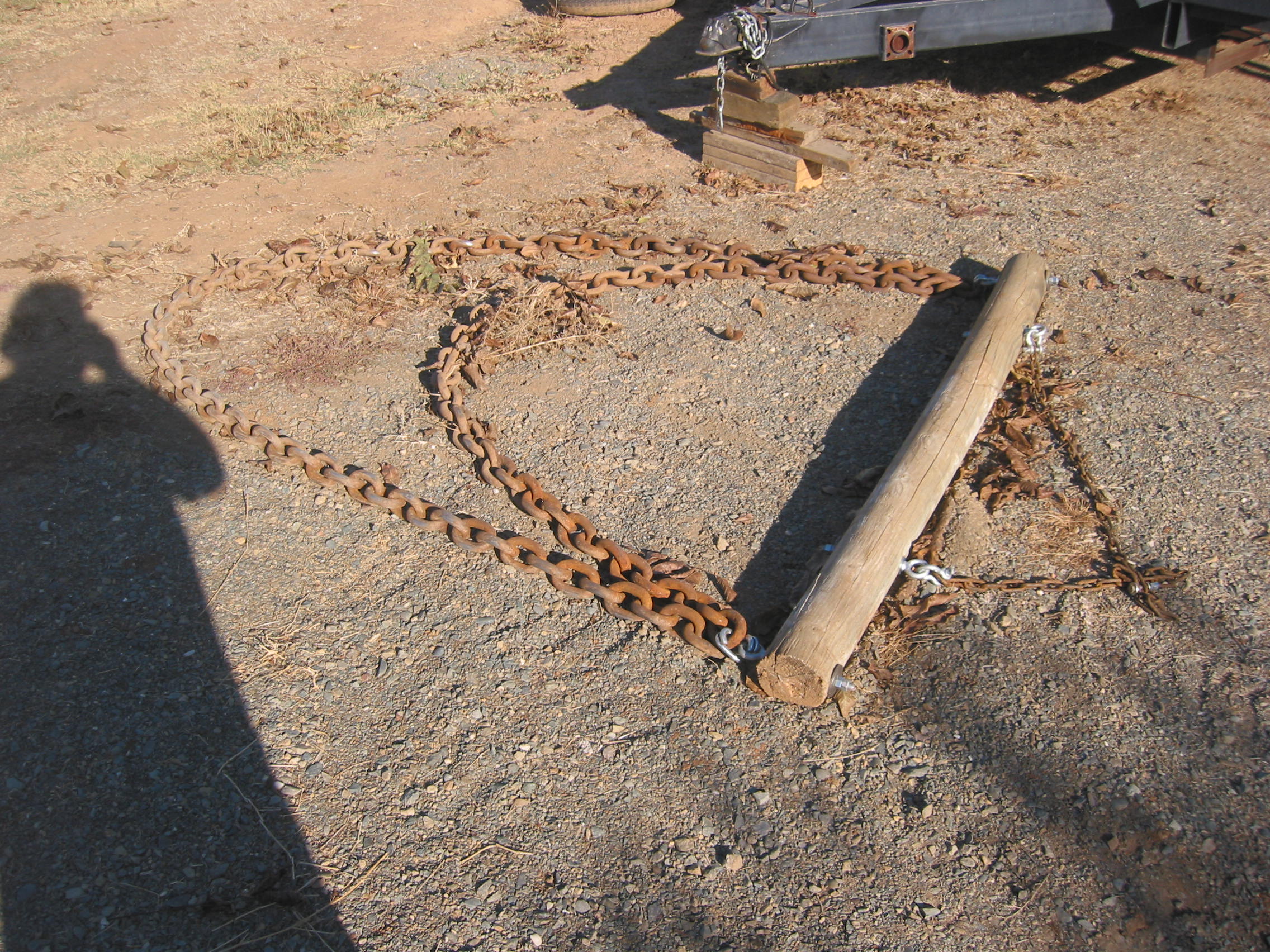

I have a drag with fence posts and some 5/8 chain (added three more posts and three loops of chain after photo) that works pretty good (mostly use it for finish smoothing and breaking/spreading horse droppings) but the ring roller really does a good job breaking the clods up and setting seed.
