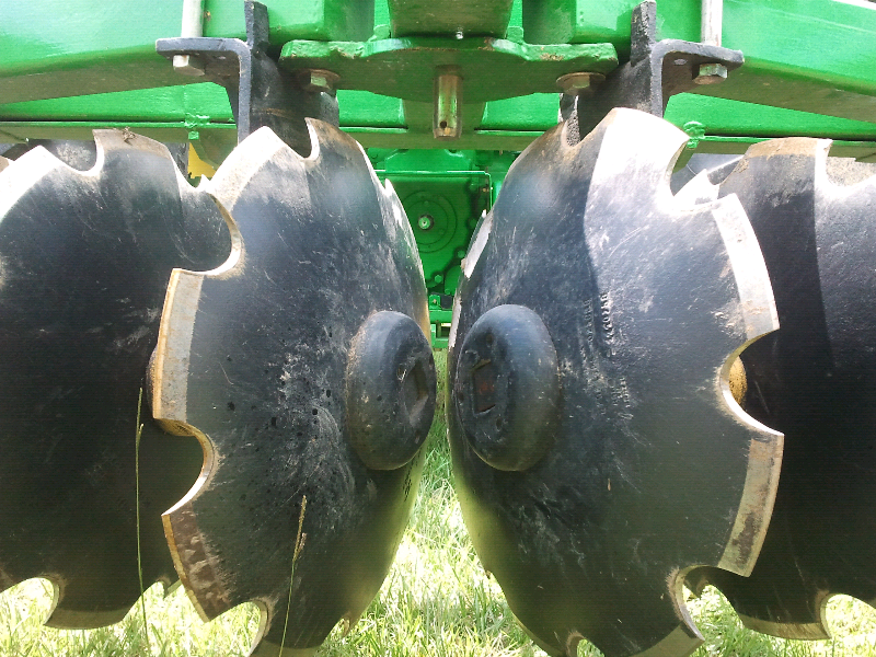

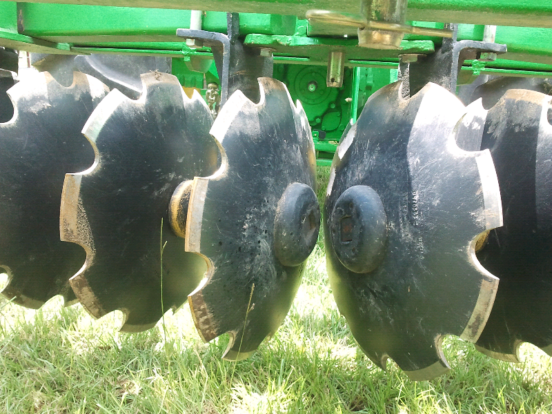

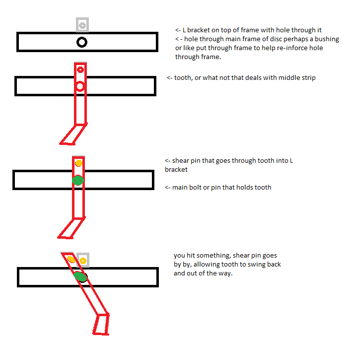

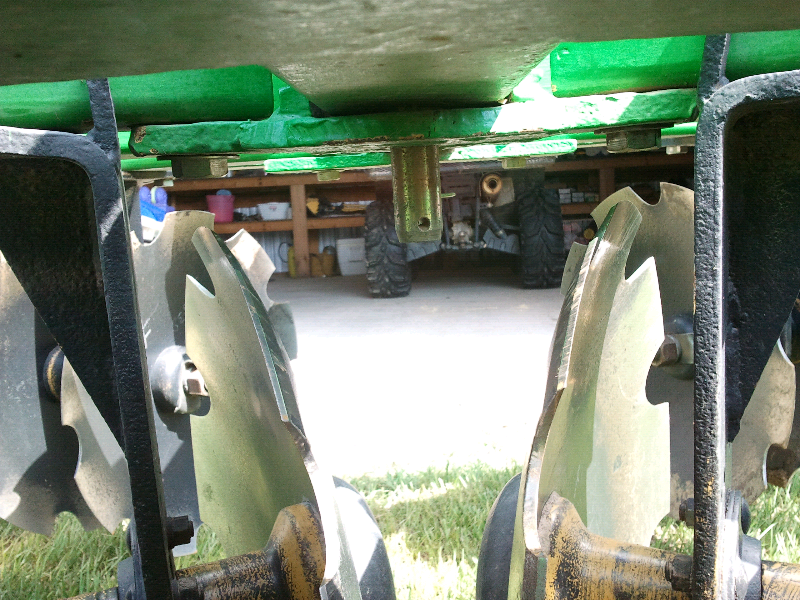

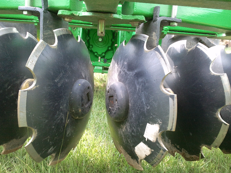

might suggest the middle buster, or cultivator shank, or even a tooth for a box blade, modified sub soiler. be placed between front and rear gangs. so if you hit a rock and it bends , it does not take out a gang of discs and in that also any sort of bearings in the end one of the gangs.
i would imagine, you are looking for something that has higher grade strength of metal. that has more of a thicker metal. so when it is in the ground and you take a turn. it turns to vs getting bent and twisted.
what ever you do use, think about any sort of hard dirt or large rock it may hit, and the middle piece of metal bending downwards as the tractor keeps pulling along, causing disc to come up off the ground, as this middle piece of metal bends and twists or breaks off.
what ever you are discing, do you fell like you need to make a second or third pass over the ground. to help break things up and flulff the dirt up some more and also get discs to cut in a little deeper on second or third pass?
are you looking at plowing and then discing and letting ground dry some, and then hit things one more time with a disc before planting?
are you looking to say disc the front yard. to help remove some ruts, or un-evenness within the yard. and then tossing some grass seed out. and using disc, to get grass seed under some dirt?
are you running something before hand like a plow? or tiller or something else? were middle strip really does not become an issue?
what about after pulling a disc, is the planter, or chain harrow or harrow, does it have anything to deal with middle strip and not a big deal?
