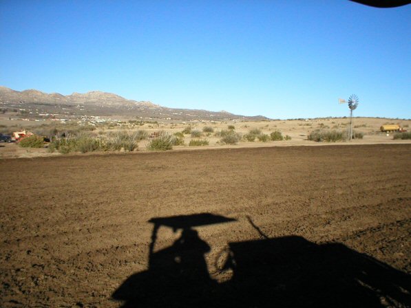

Almost all of the land I work with is irrigated fields which haven't been turned over in twenty years or more. I use an S tine field cultivator first followed by a rotary tiller. The S tine cultivator is good for finding trash buried in the field such as wire rope and other things which would wreak havoc with the tiller. After two passes with the cultivator I can till up the fields with the rotary tiller and have a good seedbed in 90% of the cases.
For most owners of compact tractors with hydro transmissions a rotary tiller is the ideal tillage tool imo. Since the transmission isn't under load because the tiller is pushing the tractor forward you can then utilize all of the pto power for the tiller. That removes most of the hydro transmission losses that would be experienced with high draft loads. A common argument here would be that farmers use discs in most cases and rarely use a rototiller. That is true also but these same farmers are not using compact hydro tractors for field work either.
With a 100 hp tractor properly set up you can have several choices for tillage. Which choice is best depends on the soil conditions and what you need to achieve.
