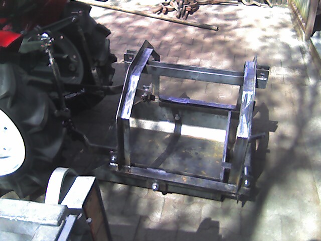

I am somewhat hesitant to post such a simple and common item as a dirt scoop when in this forum have been some really great machine work extravaganzas like a rotating back blade. However, I am happy with the result so thought that I would share it.

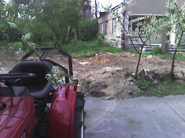

I need to move some sand around our church property which was left by the previous owner when he dug the septic tank, and is where I want to put a parking. I bought a month ago a Yanmar 1510D which has a tiller.

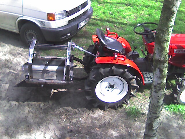

Since I cannot find implements or 3pt parts for cat 1 locally at all. I will have to make everything. At first I was not sure that I could make it work, but I am happy to report that it did work and well. I have a few bugs to work out yet, but I believe it is a success. (the bugs have to do with the sway links on the lift arms.) Now just paint is necessary. hmm? what color?
I examined all the pictures and examples that I could on the web and studied KK and Howse dirt scoops and tried to copy as best you can from a picture. The results may not be as faithful a copy as I would have done had I ever actually seen one or had the measurements for one.
I had to make everything for the 3 pt. Lift pins were made from bolts that I cut the heads off. lift arms are steel flat stock that I bent like the pictures in the parts manual on Hoye's site. The side links I made from pipe and flat stock. Well you get the idea.
The scoop is an attempt at copying the KK scoop. I do not have any dimensions so it had to be an eyeball guess. But I am happy to say it works.

Thanks all for the kind comments. I got to give it a go today and I am very happy. Well mostly anyway. my lift arms should have been 2 inches longer to keep the scoop out of the tires when going forward. I have orderd some real replacement ends so when they come and I weld them on I will lengthen the lift arms a bit.
I managed to cut through some tough roots and even hit a buried concrete ring that stopped everything in its tracks, but no damage and everything worked great. I took some pics, but am just too tired tonight to get to them. Tomorrow I will try to get them up. I made arrangements today to get it powder coated red!! Yanmar red! I also bought some special mix paint for the yanmar grey/green for the lift arms and side links.

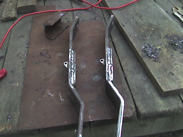

Well It worked so very well. I have most of the sand relocated that i waned to relocate at the church. I had one big pile left. I eased into it and hit what felt like roots, gave some throttle and lifted up the 3pt and the next thing you know one of the lift arms is doubled over.:mad:
I took it all apart and straightened the arm on a press that my friend has and back to work--first pass and again the same lift arm is folded up.:eek: My friend was not home so I took a big hammer and straightened it out, but this time i welded in a second layer of metal about 6 inches long where the side link attaches. 3rrl also bent a lift arm and I remember how he put a T back on it, but I did not have room for that, so I simply added a second piece of steel. So now in that section the lift arm is 60 cm (2 3/8) wide and 2 cm (3/4+) thick! I gave it a go this evening and I think that will be good now. But I lost my phone/camera--hope I can find it when it get light tomorrow I took some pics, but for now they are lost.:eek:

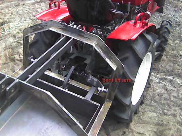

I found my phone/camera where it had fallen as I talked to a neighbor who came over to see what I was doing--great. Sandman--no rain here in sight--it is SOOO dry right now. This kind of soil probably looks mighty familiar to you--nothing but sand!!
Here are pics of the bent arms and the strengthening that I gave them. We will see if it is enough, but they are 2x as thick as they were in that one 6 inch section.
What I tried to scoop which bent the arm was a section of cast iron drain pipe buried in the sand.:( Well as scrap it will help to pay for the piece of metal that I added for strengthening.

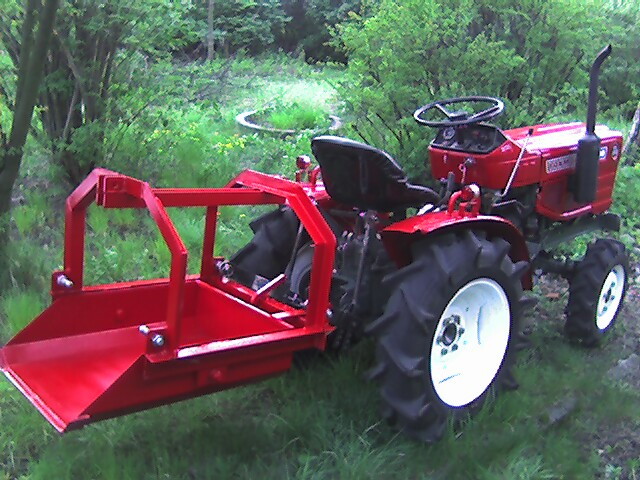

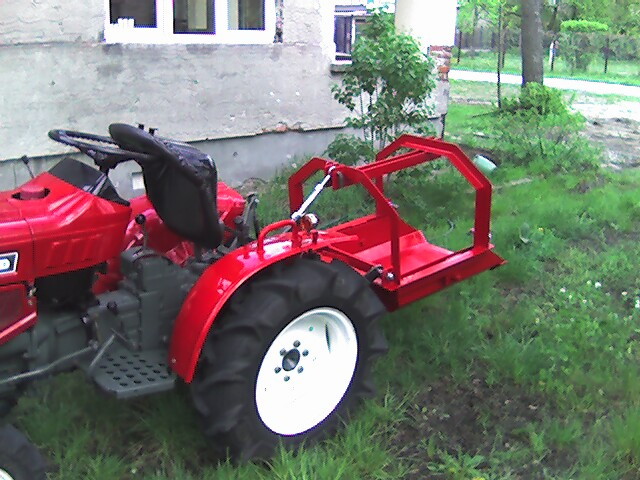

Thanks for the kind words Harvey, Czech et al. Yesterday I had a chance to spray some paint on the scoop. Now it matches the Yanmar. I thought about giving it a yanmar model number maybe YM 75 (75 is centimeters in length or 30 inches). That would look good in off white on the top element huh? Maybe Yanmar would not want to claim it.:eek: Oh well--I had several people ask me why I was painting it only to scrape the paint off again--maybe they are right. This I do know that I spent more time preping this thing that it deserves--you would think that I was painting a Ferrari or something--well the color is not too far off.

Very nice job. Looks factory to me. That will help if you ever need to sell it. Then you can buy materials and build something else.

In all of your pictures the scoop shows to be in the reverse mode. Or, in other words, you load it while the tractor is in reverse. If you made it exactly like the Yanmar, then you should be able to turn it around, and you should simply because of what you have already done to your lift arms. When you turn it around, you are pulling on the arms, and not pushing against them. They tend to bend a lot less frequently with the tractor in a forward gear.
I have pretzled several bush hog uprights learning that lesson, but fortunately no lift arms.
David from jax
   / Dirt Scoop and 3 pt as first project
#18
Sandman,
I have turned it around and used it that way too. But what I was doing most was digging in a pile, which I did not want to climb over. When it came to clean up I switched it around, but I cannot lift it quite as high because it will get into my tires. I made my lift arms a little bit short I think. However, I have ordered some proper rebuild ends for cat 1 lift arms and when they get here and I weld them on I will lengthen the arms a bit.
I know that lift arms were made to pull not push--well mine were fabricated by me so I believe my modification cured the bending problem, if not then I will modify again.:D
I bent the arms when I hooked something with the one corner of the scoop, was lifting up and at the same time pushing back. If I had not been pushing I would have easily picked the front end off the ground. Something was going to give and that time the weakest link was the link arm. (what I had hooked was a section of cast iron sewer pipe buried in the tangle of roots.)
I was not as satisfied pulling the scoop to level things out. it would dig in too much or just float too much (depending on top link adjustment). but with the scoop back wards the flat back side of the scoop leveled pretty well. So I decided that for final leveling I need a box blade--new project and new implement.:D Now if I could only find a source for scarifiers.
