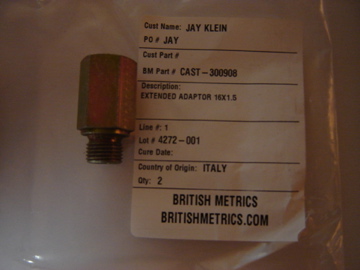

As you fellow Caroni owners know without the extension the flail will bubble gear oil out of the breather hole. I just purchased an extension from British Metrics. There was a minimum order requirement so i had to purchase 2 of these. If anybody is considering buying one just P.M. me and i will sell for $18 inc. shipping.

Yep, you gotta love TBN. I was looking to find out how to fix the gearbox leak issue and there is Jay's thread. Talk about lucky timing! Sweet thing about it we both win.

Jay part number is 300908. Currently showing out of stock the following link is where it is currently showing. Needed one myself.

You might want to check with a napa store too as they handle Parker Hannafin Hydraulic Fittings and
the metric fittings they make would be Identical.
Another option is an Aeroquip hydraulic fittings dealer too as the fittings would all be the same(metric).
Another option would be a Canadian Aeroquip or or Parker hydraulic fittings dealer as they have all
metric parts north; bless them and thier sanity for using only metric.
