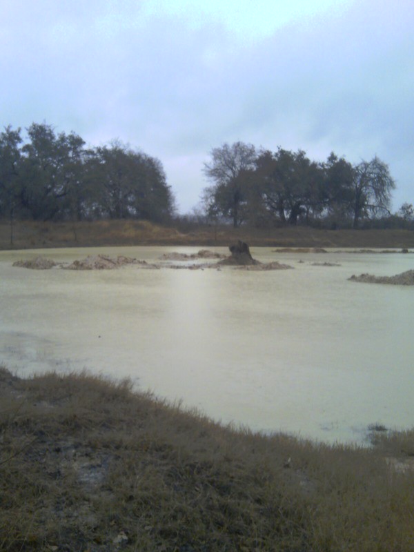

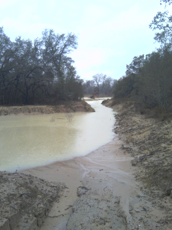

Crazyal,
I'm not sure when a pond becomes a lake :confused: but everytime it rains just a few inches it takes me 2 whole days with 2 large gas pumps to drain the areas that I am currently trying to finish. It sure can slow you down. I also have to dig connector creeks to connect the 3 largest areas of the pond so it will in the end be one body of water. You can see in these 3 photos what just 2 inches of rain does and it receives no run off :(

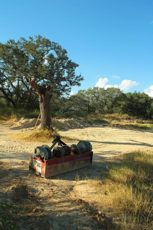

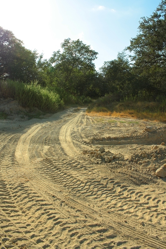

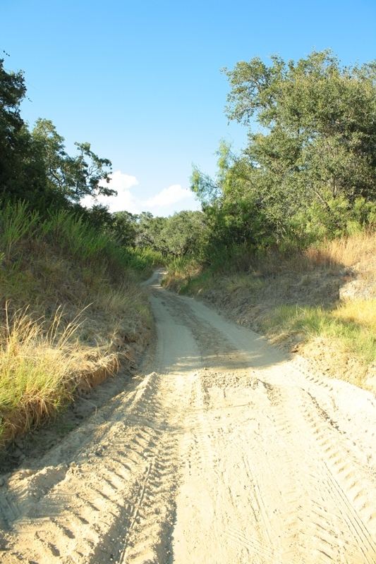

It takes a lot of extra weight on the box blade to penetrate the clay but after driving around over it for a while it will pulverize most of the clay chunks into almost like a powder where the dirtpan becomes like a broom pan. You just sort of drive around and sweep it up with no resistance. After about 20 passes you can see this powder in one of the connector creek areas. It looks almost like regular sand.
I started this thread in the hopes that I could share 3 years of experience with smaller (B26/L39) type tractors and large excavation projects. After trial and error I hope to show other members who have smaller equipment and are on a limited budget, like myself, that you can tackle large projects. All you need is patience and the enjoyment of seat time and picking at it here and there when you have time and feel like it. Yes, I have had dozers, large backhoes and skid steers on different projects but sometimes I guess you just like doing it yourself.

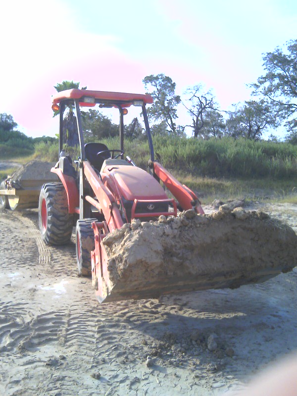

For those considering a Kubota 4 n 1 bucket for doing a lot of digging compared to a Kubota HD bucket here is what I have found. The L39's 72" HD bucket has a 15.5 cu ft capacity heaped where as the 72" Kubota brand 4 n 1 has a 13.3 cu ft heaped capacity. You can see from the images the HD bucket because of the taller lip on the top of the bucket will carry that much and then some but the 4 n 1 heaps pretty good also because it has a longer lower lip. The difference in the two buckets is when you are actually scraping, digging, and pushing into a pile or peeling a layer of clay...the design of the 4 n 1 is far superior to the standard bucket. So it is basically a trade off. If you actually need to dig, the 4 n 1 is a good investment besides the advantages of being able to grapple. But if you are hauling a lot of loose piled up material the standard HD bucket...being 200 lbs lighter and holding a couple more cubic feet is a better option.
