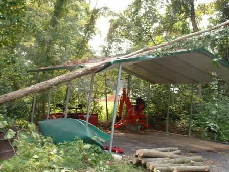

Be careful cutting down dead trees. I was cutting this one down a couple seasons ago and the root ball pulled out of the ground as it was falling, it spun around and tagged the corner of my carport. I was lucky, it could've easily taken out the garage. Ive never had a rootball pull up before so I never worried about it. Now I do.

I leave it one piece as the top's weight/leverage will greatly aid toppling it and pulling up root ball. If you do cut it, leave a long stump for leverage.
