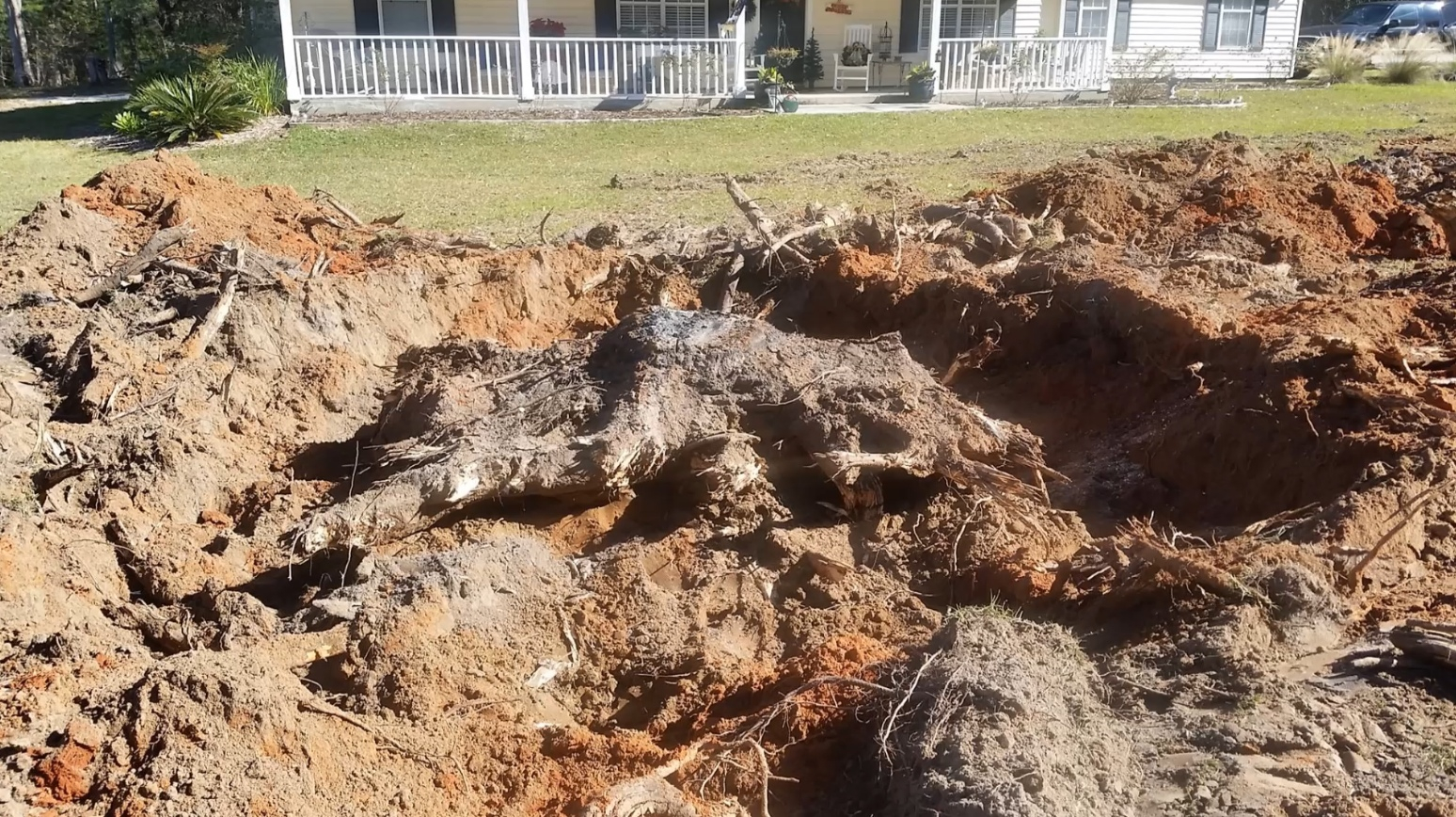

Just dig on one side, cut the roots on the non hole side, push the stump in and bury it in the hole.
/ Digging stump techniques #22
Then you will be left with a sink hole.
I typicaly move them to the woods and sit them upside down so the rain washes the mud/dirt off then burn them in a few years.

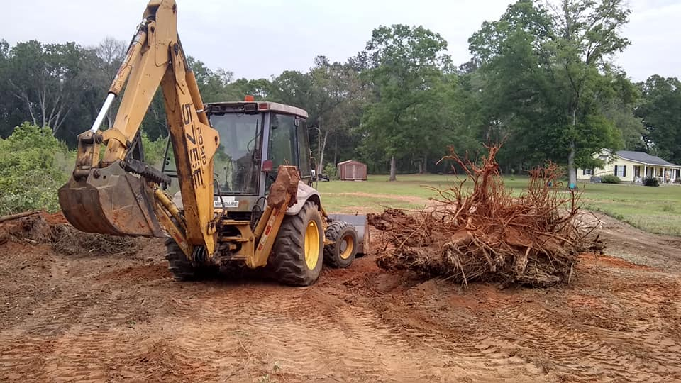

My suggestion would be to use the narrowest bucket you have. The machine will only put out so much power, regardless of size, so you might as well concentrate that power with a narrow bucket. The idea is to bust the roots, not necessarily dug a big hole. But, sometimes, a big hole is what it takes.
/ Digging stump techniques #24
If it’s like a sweetgum I’d rather be kicked in the balls by an angry horse than try to dig it up with a TLB.
I resorted to a D6 with a ripper after a full day for 1 stump.

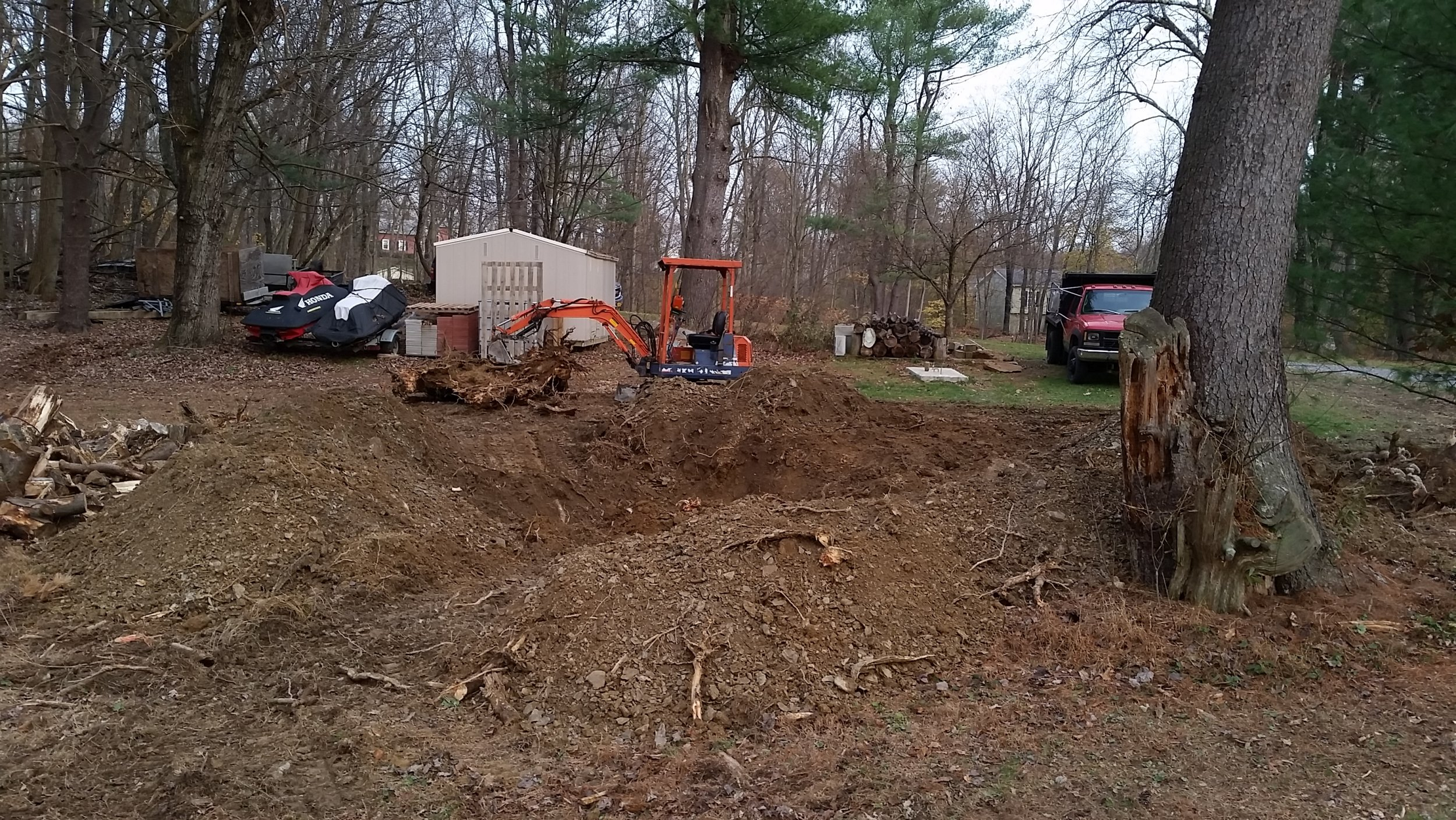

I have a little 3,500lb mini ex that I have dug far to big so stumps with. A few times I even had to build ramps to pull/push/drag the stump out of the hole. My longest stump removal was 6hrs on a stump that would have been under my cabin foundation. Once we got that one loose I couldn't flip it to get it out of the hole.
You need to get into the stump deeper. This usualy means digging 90* off to the side of the stump.
Now my preferred method is to dig the stump out with the tree still on it. Makes pushing the stump over far far easier and you can use the weight of the tree to your advantage.
Digging the stump out with the tree standing is also my preferred method. I dig out the side of the tree with the lean first, cut roots, then work my way to each side then the back of the tree.

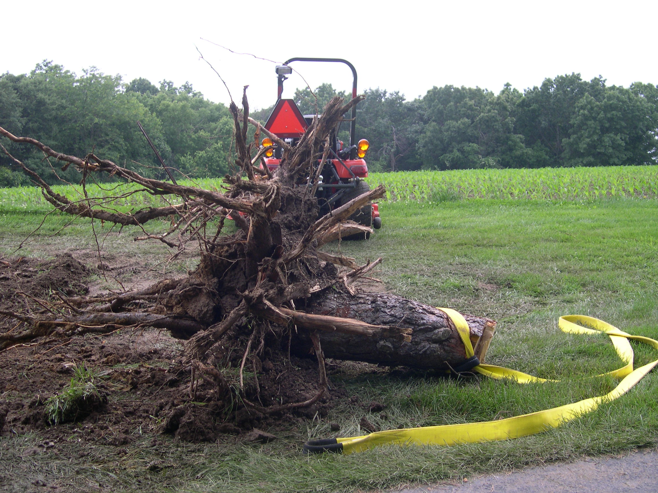

I have a couple that I would like out in my yard, from blue spruce trees, that were about 12 inch diameter. I am going to try the truck rim trick, where you stand it up against the stump and loop a chain over the top. Wrap one end of the chain around the base of the stump and attach the other end to your tractor draw bar. The rim gives the chain a more effective upward pull angle.
That is a variation of the old wood wheel "stump puller" that was developed in the early 1800's as they were clearing the way for the Erie canal. They were used with teams of horses and oxen.
