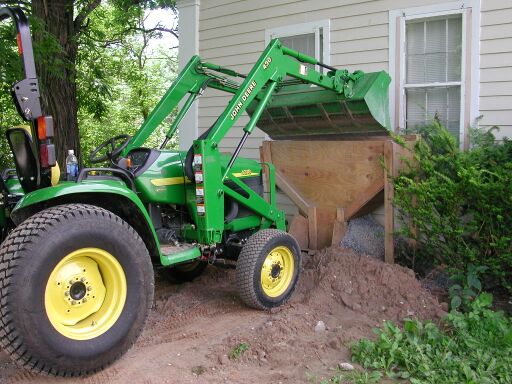

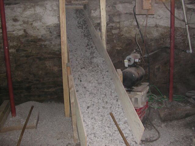

I really like your batch plant! The funnel/chute, it is well thought out! Are you attempting to level out the floors supported by the beams? How did you choose the size of the gravel? I'd think smaller stuff would be easier to smooth/level.

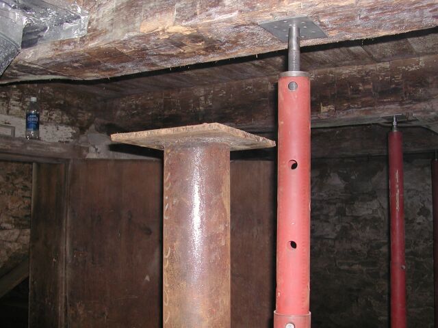

Well, Mako, we did pretty close to the same thing. Just bought our place three months ago. It was built around the same time as yours. We're lucky, though, in already having a basement in there. Including under the addition that was added within a couple decades of the first house! I don't know when the cement was added to this floor, but there's an opening around the primeter that appers to be about a 2x4 width. I'm suspecting that that's what they used as a 'drain' should there be any leakage.....There are several jackposts helping out the old beams here also. Beautiful homes, they are.

Slamfire
I am indeed leveling the floors as I go. They will never be perfect, but then nothing is ever level or square on these old houses. The gravel is #1 and #2 stone. I had a load of each delivered for various projects. I have read that the #2 is better under concrete (less chance of settle/cracking of concrete). However #2 is a pain to shovel!! /forums/images/graemlins/tongue.gif So I've been mixing it with #1 to make things a bit easier.

I suspect that you do have a perimeter drain under there. Is there a sump in the basement? I put mine in not so much because it's wet/damp, but because we have a creek in the front yard that tends to flood in the spring. The previous owner said that the water started to perculate up into the basement from below during the worst flood back in 1996. I just want to make sure the water has a place to go if this happens again. I have heard of one new basement floor buckling right up from the water pressure during a flood. /forums/images/graemlins/shocked.gif

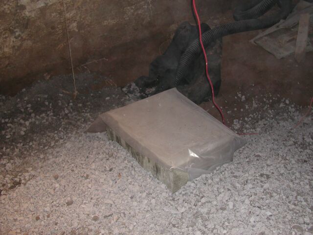

To answer your question, I plan to have a contractor pour and finish the floor. I would like to have poly sheeting, wire mesh and about a 4" floor poured on top of the 8" of stone I put down. The pads will be "insulated" from the floor so that the floor can move (hopefully not much) independent of the pads and vice versa.
