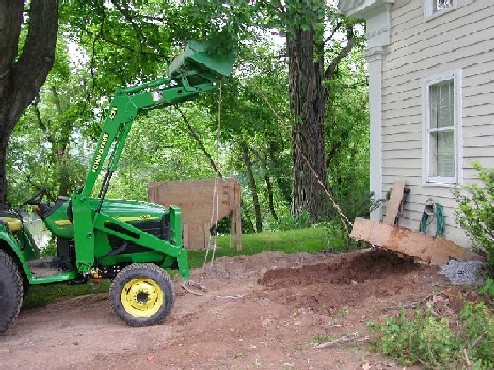

#2
Here is were the tractor came to the rescue. A rope attached to the cart was used to haul the cart loaded with dirt up and out of the basement.
I had started this project before I bought the tractor using a wheelbarrow and a ramp up the cellar steps. About 5 loads of dirt up that ramp was enough for me. I decided it could wait until I had some help !! /forums/images/graemlins/smile.gif

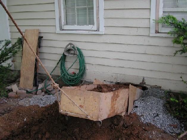

   / Digging out the basement
Here is a shot of a cart load of dirt coming up and out the coal shute. This job was kinda like working in a mine. It all had to be dug out by hand, and hauled out one load at a time. The cart was dumped and rolled back down the ramp for the next load.

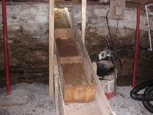

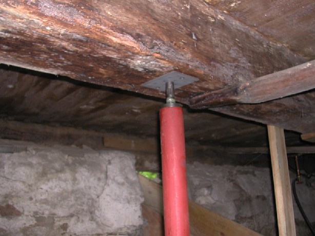

Now for the next phase. I had to work this in sections because I was also pouring new pads for the support colums. The beams that span this section of the house had been poorly supported over the years and had some sag to them. This makes for some crooked floors above.
I dug down about 2-1/2" feet for the areas that needed the pads poured. The remaining area was dug down about 8-10". Then it was time to bring the stone in. If you look behind the tractor in this photo you will notice a large "funnel". This was placed into the ramp opening, and the stone was loaded into the funnel. I have some better pictures I will post next time.

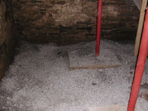

Ok, so far it has been dirt out and stone in. Hre is a pic of one of the new pads and colums. The pads are about 14" thick and 16" x 22". This is major overkill, but thats the way I tend to do things.

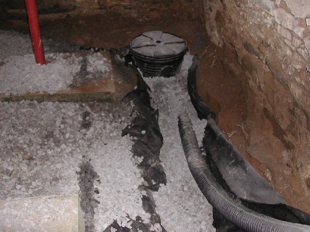

In addition to new support colums, I deciced it was time to get some perimeter drains and a sump installed. This is a bit tricky, because I am digging next to a laid up stone foundation. I have to be very carefull not to dig to close to the foundation and risk having it come down. I have dug a trench about 3' deep for the drain pipe. Filled the bottom in with about 1' of stone. Then laid down a geotextile material to keep the silt out of the drain pipe. Stone is then added to surround the drain pipe. Its hard to see in this photo, but I left plenty of extra material to "wrap" the pipe and stone. This was then covered with more stone.

Here is one of the beams with the new support in place. These are big hand hewn beams

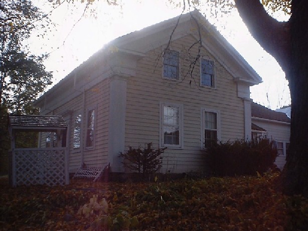

One last shot for today. This is a picture of the house when I bought it last fall. There is a ton of work to do on this old one. It is hard work, but very rewarding.
