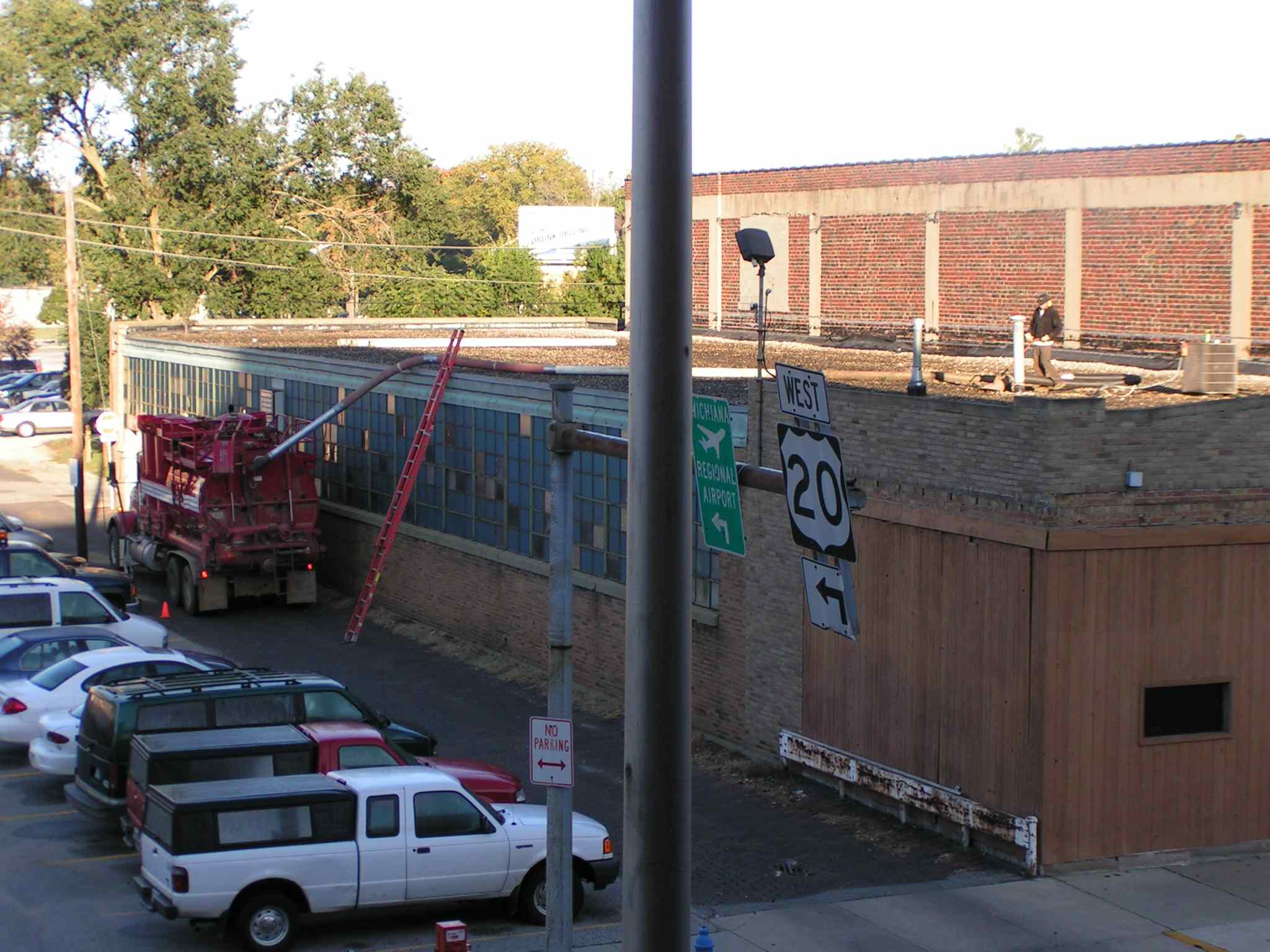

As someone mentioned, a vacuum truck will work. Several commercial roofers in this area took old sewage VACTOR jet rodders and just added hose to them. They sucked the 2" rocks off of our 4th floor roof this summer. Last year they did a one story roof. I think it was about 50' wide by 150 long. One guy did that whole roof in one day.

I found a picture of the vacuum truck sucking rocks. :D
