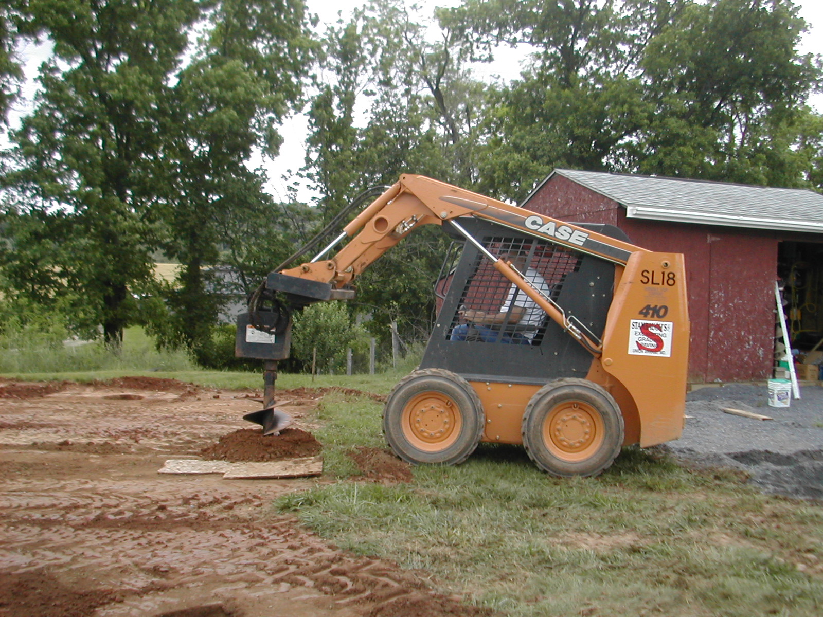

1. 6 by hand in good soil isn't too hard, and good exercise.
2. A TSC PHD does not have an 18" auger option. I researched this when I had to dig 22 20" holes for my pole barn.
3. You can buy an 18" auger, and you can buy them with special tips for rocks, but it is several hundred $$$, and if you have rocks, won't work on a TSC PHD because their's doesn't have down pressure.
4. Do like I did, go and rent the auger on a skid loader. You'll have fun doing it.
You just wanted to run the skidsteer. I see that auger in your shed.:eek:
/ Digging footing holes - Advice needed #9
BUSTED, lol
You're right, that is my TSC PHD with a 12" auger on my 20HP massey tractor. I don't have down pressure, although I did pick up a new TSC catalog yesterday and the PHD they now sell does have option for down pressure. I didn't want to enlarge 12" holes to 20" by hand. And that skidsteer was really fun.
