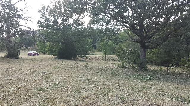

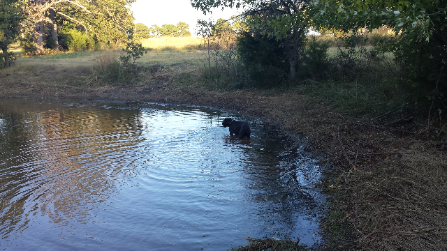

   / digging a pond with kubota bx
#27
Here is a pic of were I'm going to put the new pond. It will be down hill of the small one. You can see the bank that was build for it. And there is a pic of my boxer in the small pond. It ground is rocky but this pond holds water great it never dries up I don't know how deep it is but I've never seen it more than a foot low
