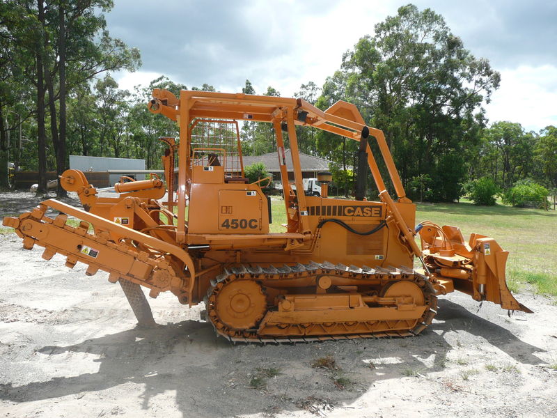

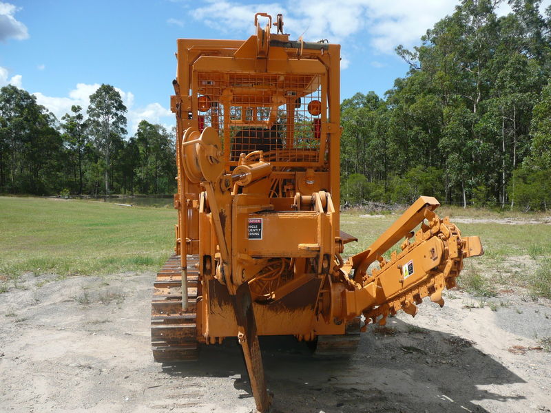

I'd way up the cost, equipment wear & "pucker"/risk factor carefully before tackling what appears from your description a large & risky job.
We bought this dozer in the photo's for a similar on farm task & use it regularly for cable/pipe laying & contracting, the trencher (with rock teeth) & vibrating ripper plow handles most rock without drama (cable drum mounts on a blade mounted bracket & spools out across the top of the cab to the plow )- if there's optic/data cabling in your region there's bound to be heavy dozer based tracked trenchers around ...........using a small BH or excavator to trench the distance you're contemplating is long hard work: digging the trench is only half the job, manually laying the cable & backfilling will take equal or possibly more time, & you'll be left with a "spoon drain" from the greater ground disturbance by using a bucket with more potentential for water erosion.
Yes you can use a compact backhoe for the job & it's your machine/time..etc., afterall the chinese have built huge dams using only a heap of people, cane baskets & picks/shovels..but I'd suggest there's easier ways.
