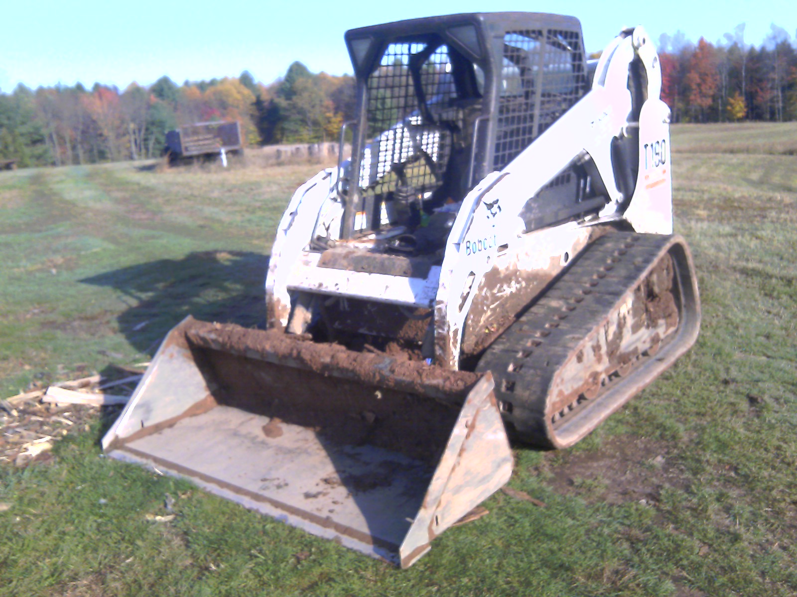

This past fall i dug my pond deeper, mine is kinda the shape of a cereal bowl, about 60 feet at the top in diameter and 20 feet deep in the center. I started out with about 2 inches of water in a puddle about 3 feet across. Its iced over now and about 40 feet across and i expect it to do well this year. My question is how come your tractors are so clean? Heres a pic of by bobcat 190 TSL and it wasnt clean. Must have did something wrong . . . .John

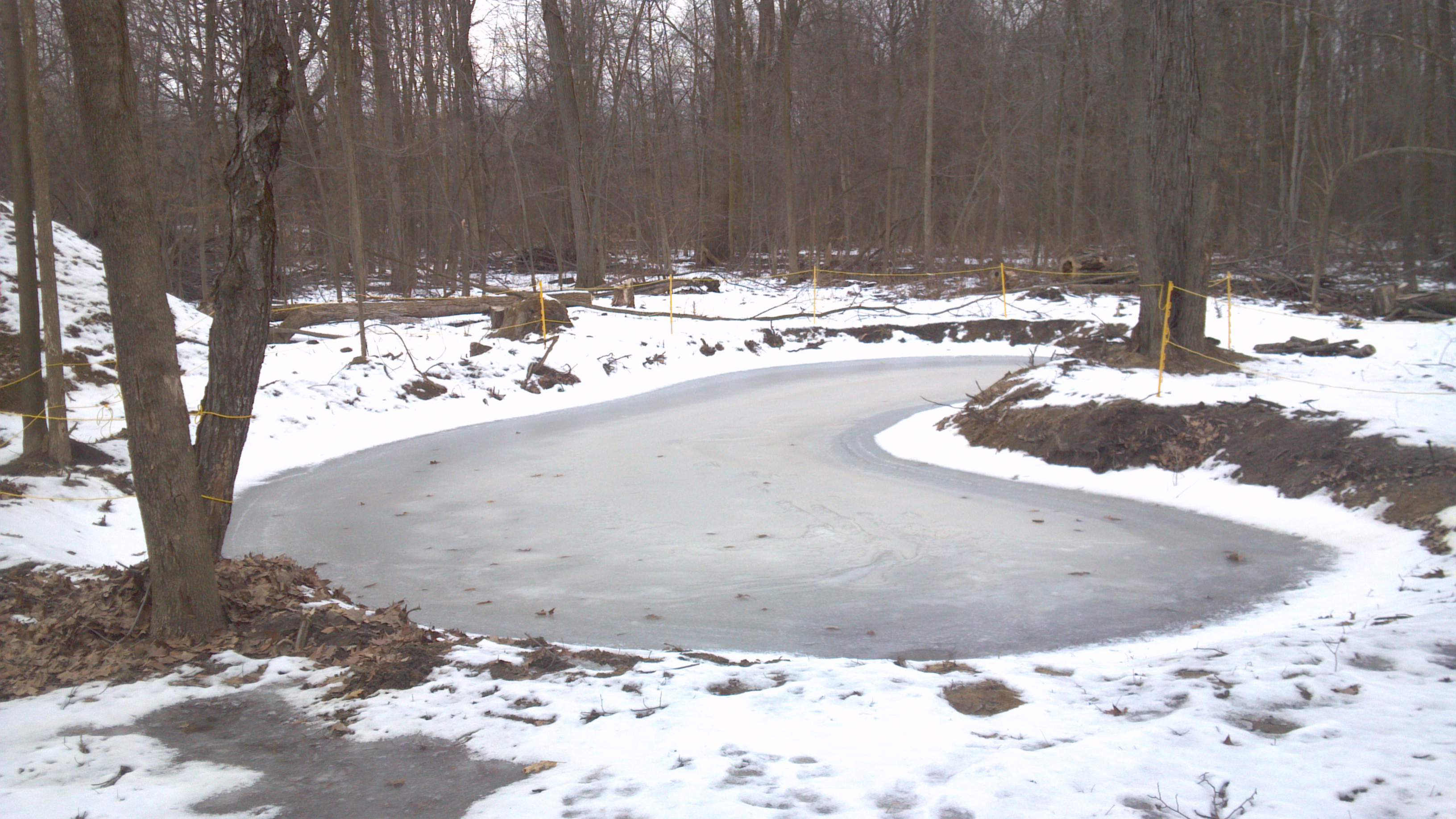

The pond is nearly full already - the deep end is probably 7' + by now!
I'm very pleased with the shape - I think this year I'll spend some more time contouring the yard toward the pond and tapering the banks a bit more, maybe clear a few more trees around it to cut down on the leaves.

I am impressed with how full it has gotten. This is a ground water pond, is that right? No inlet stream and no outlet stream? It will be interesting to see how the level varies over the course of the year.
My pond, similar to yours, is full in the spring and half full in August. My pond was dug on the edge of a 5 acre swamp (wetlands for the PC) and has a 22 acre drainage basin, but if it doesn't rain much in July Aug it gets pretty low. I use it for irrigation.

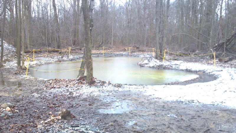

I just might, not much bigger tho. It will b for irrigation where I want to plant some things, but still mapping everything out.
Here's an updated pic... Definitely full now (over full actually, yesterday it was running over on the back)

Around these parts, folks install an overflow pipe that leads under the dam to a low spot outside the dam. I've seen 4-6 inch PVC and also copper (older dams). There is usually a slot cut in the pipe about 6 inches below the top for gradual draining before the water reaches the overflow level.

That's exactly what I'm planning to do this year, along with re-routing my sump pump drain into the pond. I just have to find the appropriate location to route the drain
