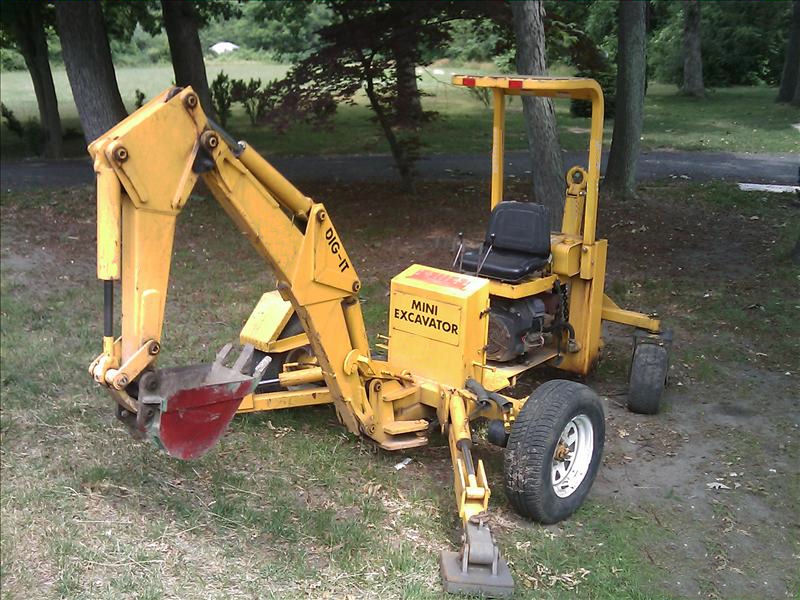

Ok got some more time working on the dig-it today.. Here's a quick run down of where it's at
I got it running again and it purrs like a kitten at idle and roars like a lion at 3600rpm.. Runs smooth at all throttle settings as well. Had to purchase a new carb, it wasn't an exact match but was 52mm Walbro and had all the proper settings. It works very well and no modifications were required to fit it. Also had a bad fuel pump, it was leaking fuel past the diaphram into the block also so between the stuck float and the bad fuel pump there was no way it was going to run well. But the block has now been completely washed out :rolleyes: I cranked it over for quite awhile with out spark to make sure it was well lubed again before starting it. Appears no damage from the two times the case completely flooded.
Got the rebuilt bucket cylinder installed no real big issue there but all of the bushings were shot for the bucket so new ones of those are on order.
Will start the complete flush of the hydraulic system next. I think the process I am going to follow is drain the reservoir, clean and refill. Then remove the return line, start the tractor and run it with the wheel controls pulled forward until the fluid runs clear. This should purge the recirculating portion of the hydraulics. Then I'll pull all the lines at the cylinders and run each circuit clear. Then, cycle each cylinder by hand to empty them of old fluid before reconnecting. This should give me the maximum amount of fluid flush I can do without extra machinery and systems I dont have with only the small cost of having to deal with some air for a little while.
Also we have solved the weight debate. By the scales it weighs in at 2762 pounds. Thats with about a half tank of gas..
I am still on the fence about deciding just a functional refresh or do a complete restore.. will decide that once I get the bushings replaced and it out of the garage digging again.
More to come on this soon.

Haha. Awesome. Its almost ready to go back into service. I found new original air cleaners and they actually beat the bushings and pins to the house. I am hoping the bushings and pins show up tomorrow so I can start the process of putting it back together tomorrow.
The only problem I am struggling with is now that it is running so well, do I leave it alone? Or tear it all down and perform a ground up restore on it. I know thats probably more money qnd work than it is worth but its an ingenious piece of hardware that I think would last near forever if I knock the rust off, blast it clean, and repaint it proper.

Awesome.. I owe an update here.. I literally just got it running and back in service again yesterday, although that didnt include fixing the tow bar yet. found out there is more of an art to digging with a backhoe than a brute force attack the ground thing?. It was fun to actually use it. I've got a few more tweaks to do and I think I need to replace the main mount pin due to it seeming loose there.. but it works!

Hey guys. Ran across this thread when I was looking at one of these 158's on craigslist. Ended up purchasing and giving it some love. Its a 1978!
It has a Kubota D722e diesel motor on it. Anyone know how many GPM's were on the orginial pump? Having some wheel power issues and im leaning towards low flow, as the pressure is good elsewhere. If anyone needs any info on these... got a pretty good knowledge base in the 'ol noodle and a manual :cool2:

That rebuild looks amazing.. Not sure off the top of my head how many it had but I also am having some drive issues.. It eventually gets going with enough stick work.. I am not sure if the problem is supply or if it is the valve bodies themselves.
BTW where did you get your pins? Mine has a lot of wear and the pins are running over $100 each.. but yours looks fantastic now for sure. Mine still looks like the one in your first pic :) I have replaced those pins necessary to keep going but I would like to find a cheaper supplier for the remainder of them.

I got pins/bushings from power king(Power King Tractor Replacement Parts and Accessories). You have to have part numbers to order. The big pin ran me $50 some bucks, short one $45-ish. Bushings ranged from $4-15/pc. Im picking up a lathe this winter to make my own.
With your wheels. It dosnt have enough power to pull over bigger obstacles? I adjusted the relief valve and it helped but it still dosnt have the power I would like. I know its not the motor as I had to replace one. Had a busted fin thing inside of it. Both have even pulling power
