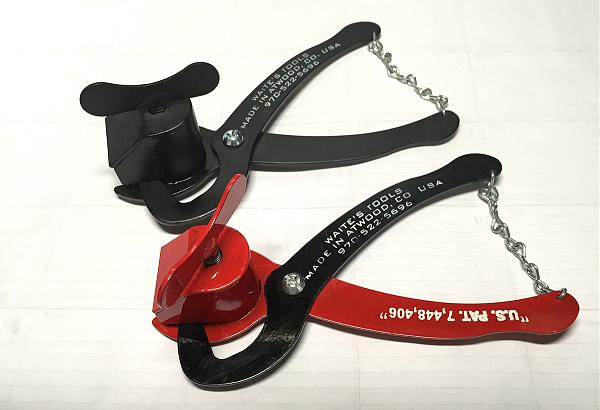

Waite's Tools in Atwood, CO makes a great hydraulic pressure relief tool. My brother gave me one as a gift. I can't find a web site for them, but the tool works very well.
That is the only tool I had seen in my search that sells for a reasonable price (at least what people say it costs in forums) but I could never find a way to order it other than calling them up. I've seen around $30 mentioned and I assume with shipping that is going to put it right around the cost to make one. That is kind of why I never gave them a call to price check it so not sure what it really costs. Thanks for mentioning that one John_Mc. I had completely forgotten about them because I did my search awhile back but that picture you posted reminded me.
So yea, to the OP, that is the most cost effective solution that I had seen in my search short of building your own. The others solutions I found were ridiculously priced.
