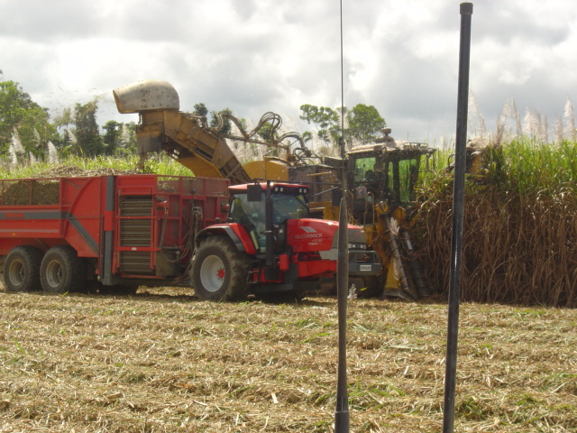

The second one is a McCormick XTX with the front axle removed and a trailer mounted to the rear in an articulated design for sugar cane haulage. These are set up this way as they travel up and down the field in fwd & rev and are used in the wetter areas to keep the balance of the machine correct.

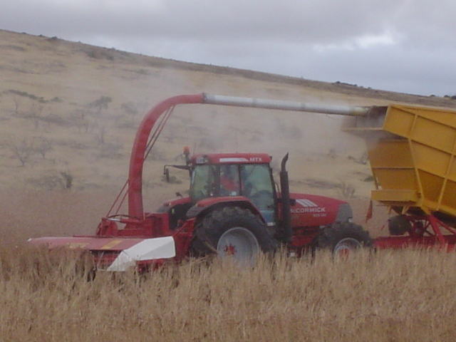

The third one is from a few years ago of a McCormick XTX set up with reverse drive configuration for harvesting poppy seeds for cosmetics.

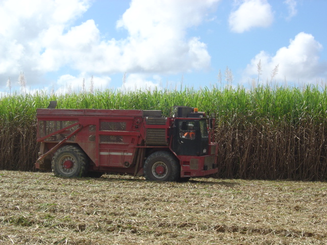

The fourth one is of what used to be used for sugar cane haulage before the articulated units became available. It was a locally built hydrostatic drive unit and Cummins powered.

Rob took the words right out of my mouth. Please explain the McCormick with the front axle removed a little more please. I couldn't stop staring at it. I don't know if I was looking at it like a pretty girl or a train wreck.
/ Different Applications #5
Thanks for posting those pics. That McCormick sugar cane hauler is one of the strangest rigs I have ever seen. But it looks like a very efficient setup.

No Probs with more info.
I have only that one picture that shows too much of it working. But basically it is a standard tractor that has had the front axle and 3pt hitch removed. The trailer is a locally built tandem wheel unit. There is a mount point built to attach the traier too and then the rear wheels become the front and the trailer becomes the back of the tractor and the weight holds it all from tipping over on it's nose. When the unit is full, they haul it out to a train and the deck lifts up and then tilts forward. There are unloading conveyors on either side of the and these are then at the correct height to unload into the train wagons as they drive forward.
There are air operated brakes and due to the flow required for quick unloading, there is a seperate pump and reservoir run off the tractor PTO.
This configuration is used in the wetter areas and also is like by the growers as the tractor dirves forward up the feild when loading and then reverses back down the feild again. In a normal tractor - trailer configuration, the tractor has to turn around and this damages the plant stalk in the ground at the ends of the rows which means replanting those plants each year. With this type of set up, they revese along and dont screw around on the plants causing less damage.
When loading, they are traveling at around the 10 - 12 kph.
Normal running weight unloaded for one of these units is in the 16 tonne mark and they can carry about that again in product when fully laden. They are fitted with 50kph trans, but the tractor driving wheels are smaller than standard and manage around the 45-47 kph.

We have tree forwarders, basically powered wagons with a grapple here that are constructed the same way out of Case backhoes. The front axle is removed and the hoe replaced with an articulated and driven wagon.

Slowzuki, would that be the ponsscee (sp?) machines? I saw one go through on a lowbed awhile back and couldn't help but think "that's a case backhoe " as it went by. Makes sense really; Solid frame, powershift trans, plenty of hydraulic power, semi bi-directional cab...
The old Iron mule forwarders were Ford or Massey tractors without a front axle and the wagon added on the back much like the cane hauler above.
