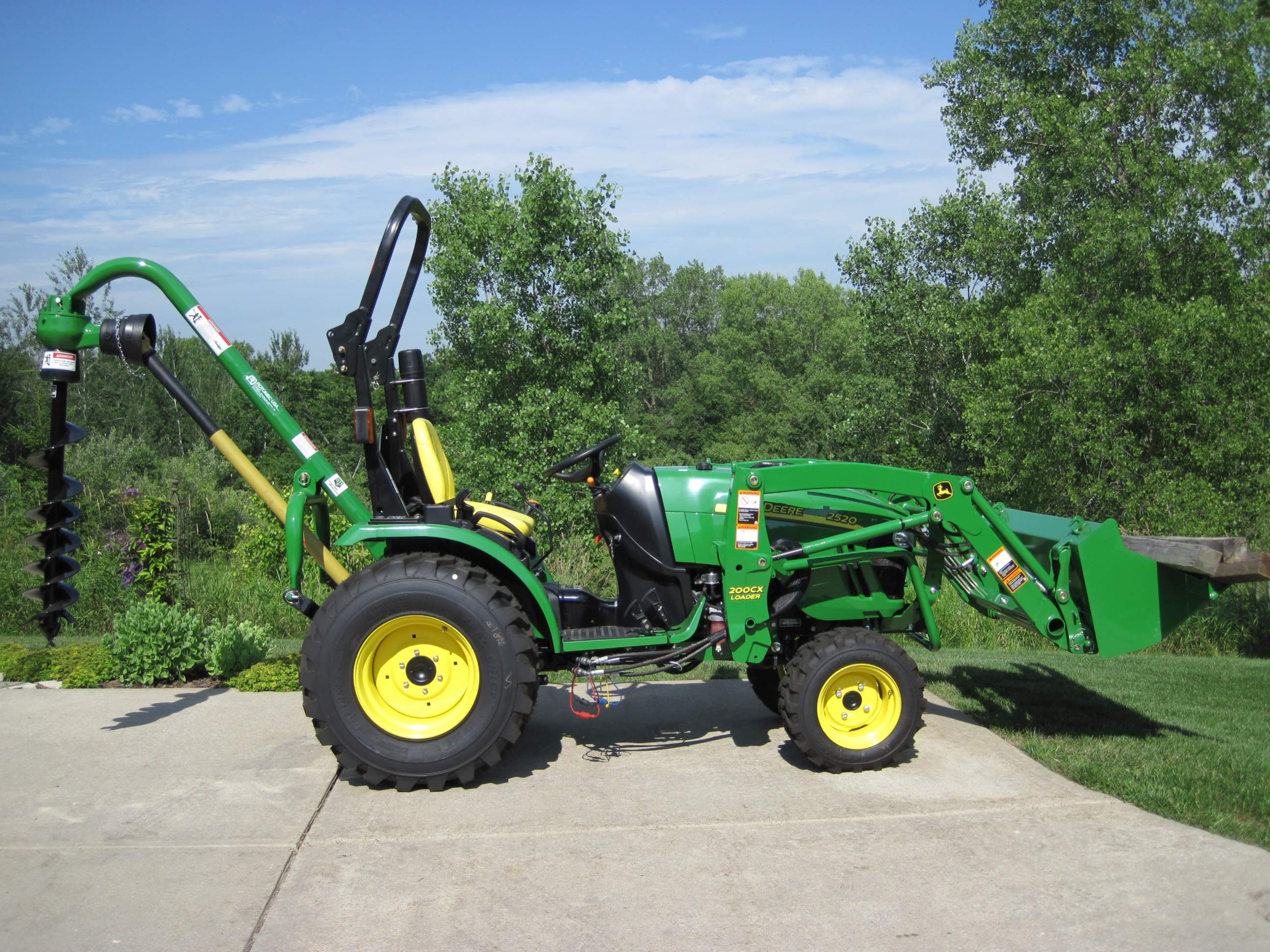

Silly me, I was worried about a tiller
   / difference btwn '07 2520 and '11 model #8
Not a difference on the 2520, but I do like the decals better on your 200CX than on the new ones.
