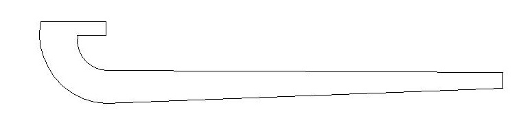

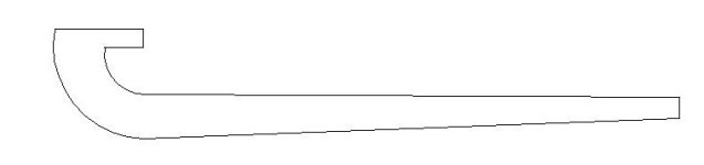

this type of wrench might be the answer... not sure what the name of it is. easy enough to make though.
