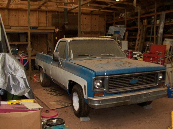

This 73 Chevy has 3/4 ton 7 spring rear suspension installed, manual trans, and a rear axle ratio of 2.73, with taller tires to give a calculated ratio of 2.51. It gets lightly loaded on the highway 21 mpg with a 350 c.i. V8, Quadrajet 4BBL carburator, torquer intake manifold gaskets, and dual full flow exhaust system. Runs on regular pump gas. Rear lowered 3.5" to aid in loading. Synthetic oil, greas used, turns 1500-1800 rpm mostly at highway speeds of around 55mph.

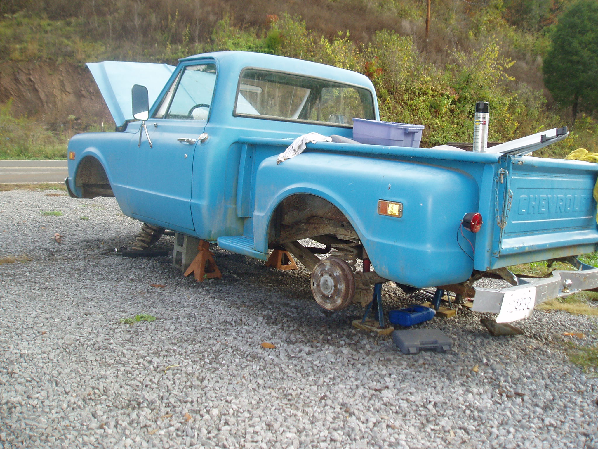

IH, i have a '72 250-6 three on the tree work truck, but it is only a 1/2 ton. A '68 short step that i am building for "cruizin", so it won't even geta trailer hitch. Since i am partial to the '67-72 Chevys, a '71 or '72 C-30 dually flatbed would be "perfect" for the farm. I've been keeping an eye out, and sooner or later i'll come across one at the right price. When that happens, the '05 will most likely have to go. It's amazing how simple and functional those old truck are.
