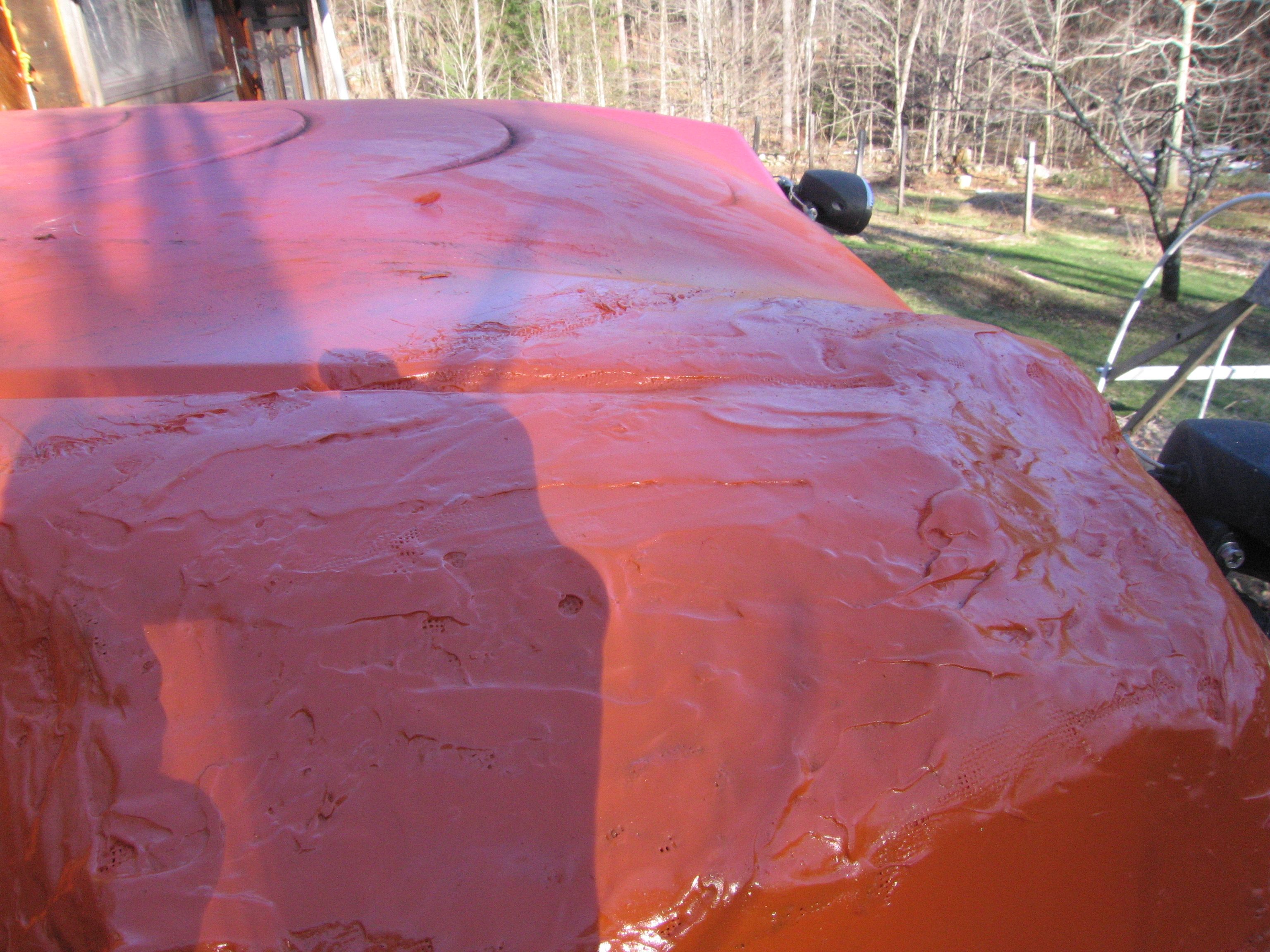

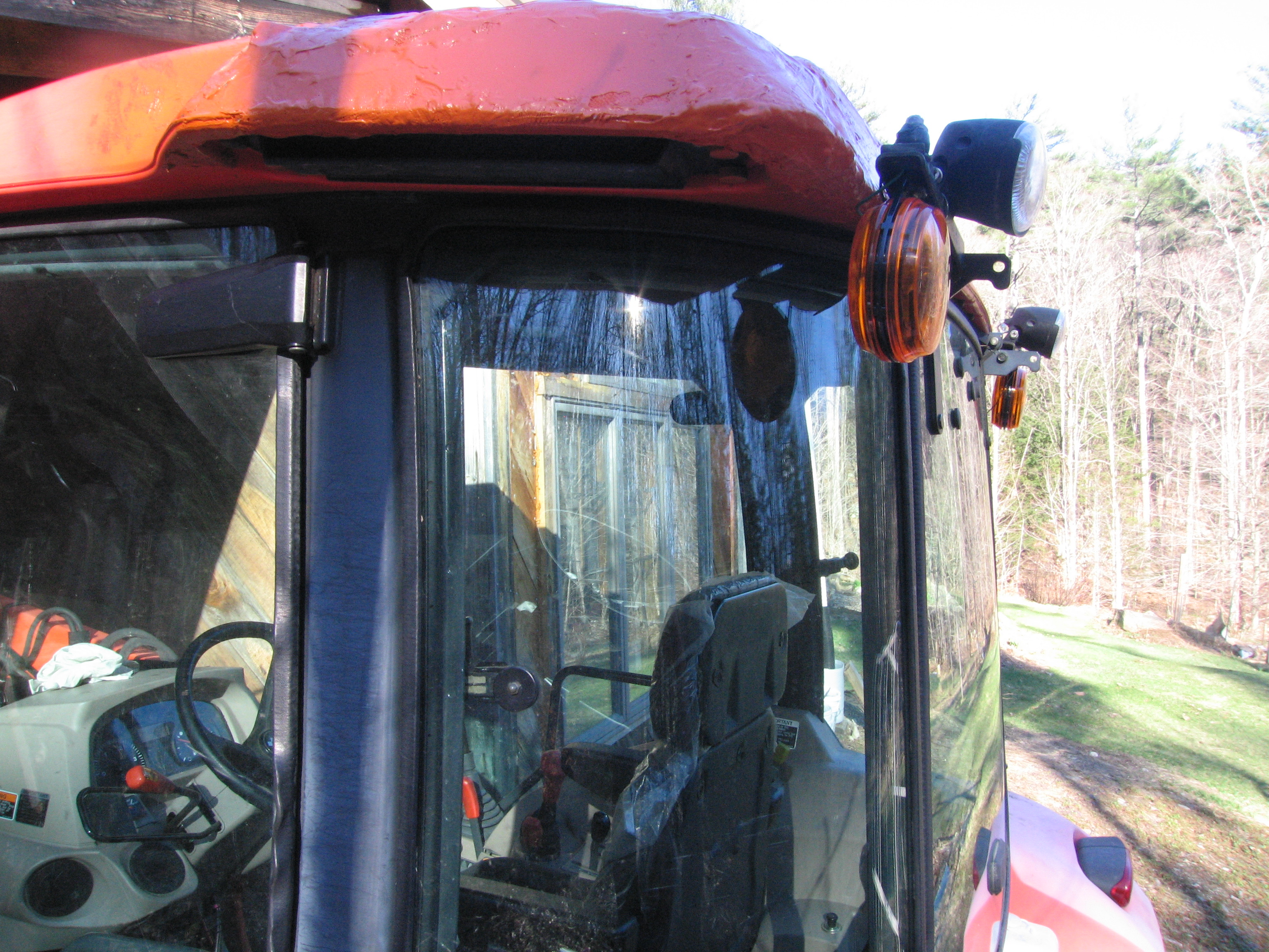

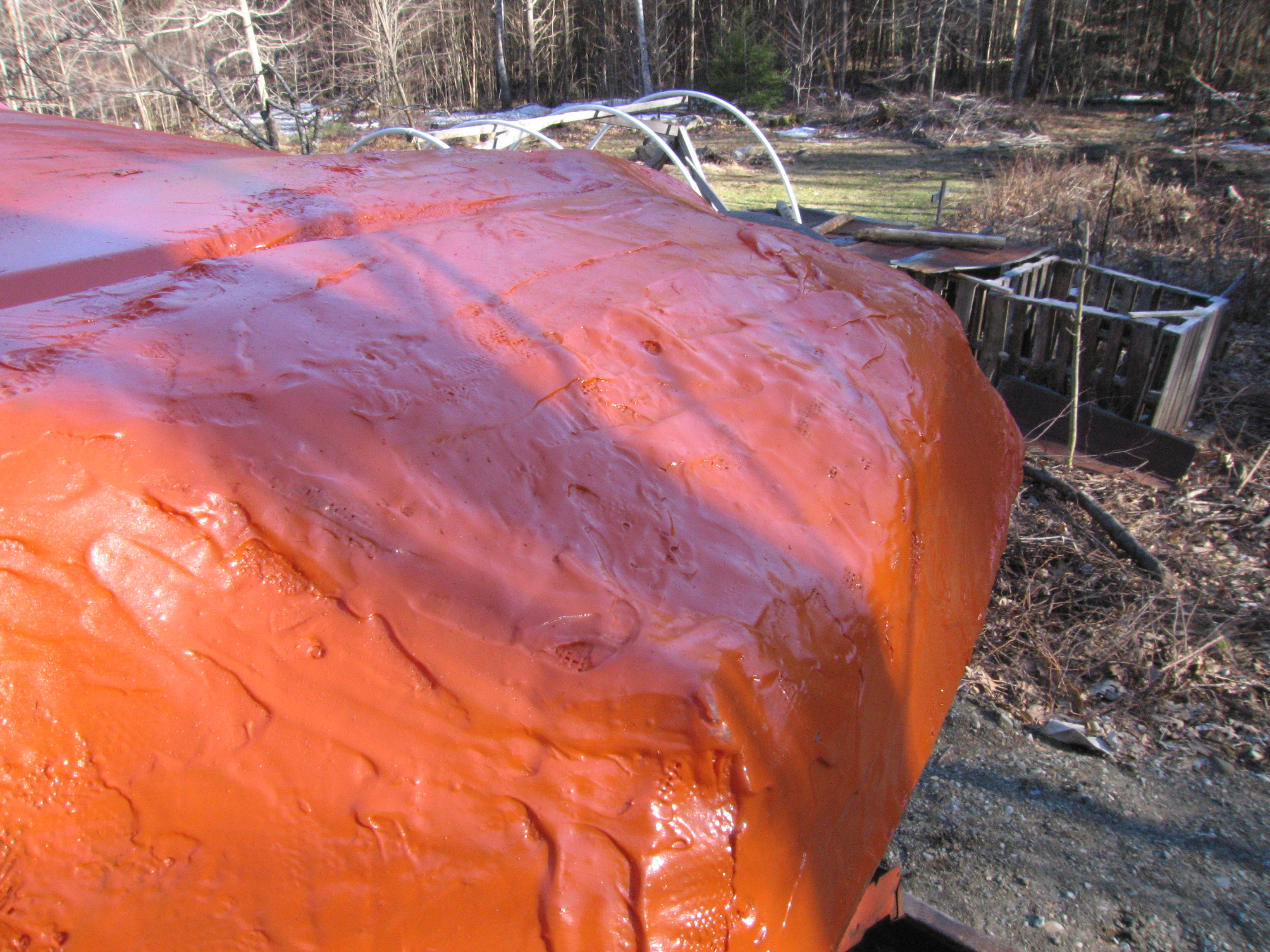

I smashed a large ragged hole in the M's cab roof and it is definitely some kind of plastic.
I repaired it with West System 2 part epoxy and fibreglas cloth. Pricey . An effective, though ugly fix [my body work experience is pretty much zero]
Been through 2 winters with zero problems.View attachment 661978View attachment 661977View attachment 661976
I hate to agree with you so readily ...but that is ugly. I'm suggesting to anyone with similar problems to go to an auto body shop where it should be an easy ( and nice looking) repair. These stories are a partial explanation why I felt I could not use a cab model tractor. Going under limbs, fighting debris often, etc. I'd tear the thing up in 2 days usage.
