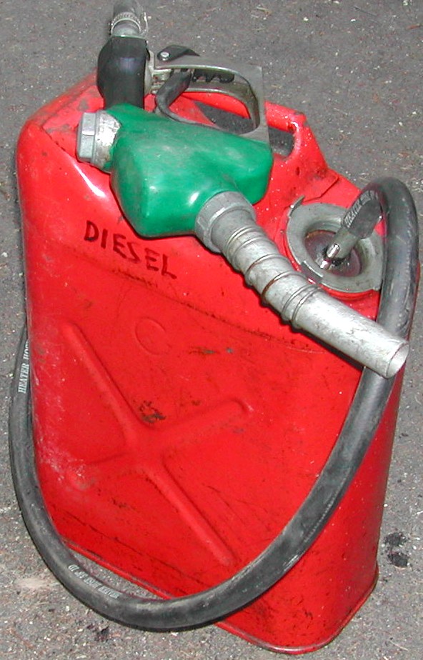

I don't buy a lot of fuel, but I learned years ago that I hate to
lift fuel cans and pour then into the filler on my tractors. I have
seen several threads about this and how tractor users preferred
to do it.
My current solution is not ideal, but it is a great improvement. This does
not apply to you guys who buy LOTS of diesel, of course.
What I did was take a Jerry can and make a cap with a welded-on
tube so I could use air pressure to fuel my tractor. The cap also has
a schrader valve stem with the core removed. Finally I bought a used
fuel nozzle at the flea market, and I removed its anti-overfill valve.
I can now stick the nozzle in the tractor, lock it ON, apply air pressure
with my air hose, and put almost 5 gallons in the tractor in about 10
seconds. No more lifting and spilling.
I can easily lift and carry a full can to/from my truck whenever I need to
get more.

im fairly shure your heater hose isnt going to stand up to the desiel fuel for long..... But nice idea!

Air??? Air compressor, or extra air tank? How do you get the pressurized air? It works for you and that's all that needs to happen. I'm just curios is all about the amount of equipment needed to get the pressurized air. bjr

As the link states in some of the responses! Pressuring up a non pressure rated vessel with air could be a disaster in waiting. :( :(
