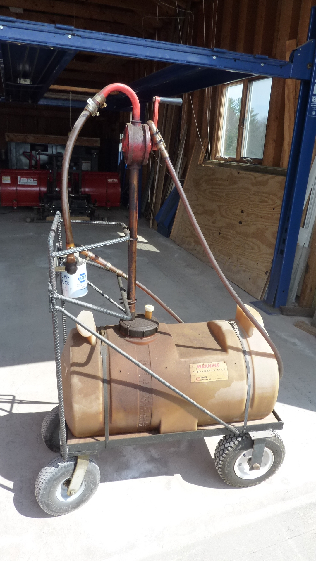

I did something similar with parts I had laying around. I put an old 26 gal poly ag tank on a cart and rigged a hand pump:
I rolled it up a ramp or used the FEL forks to put it on a trailer to fill.

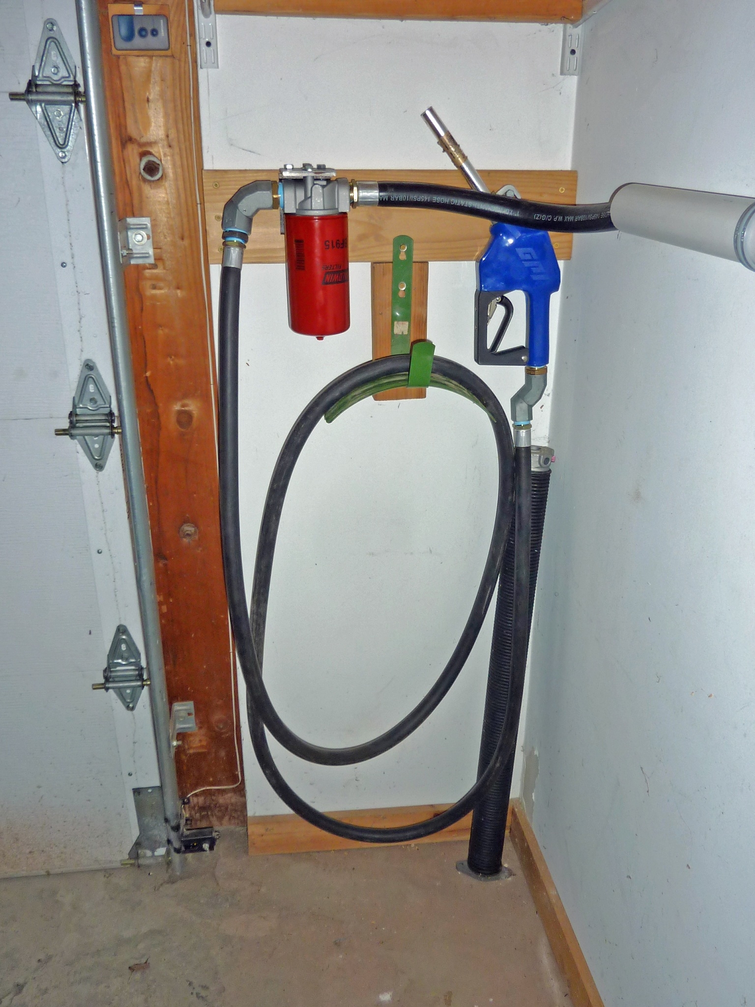

As my tractors got bigger and the fuel demand increased, I installed a pump to transfer heating oil from my 1000 gal storage tank.
