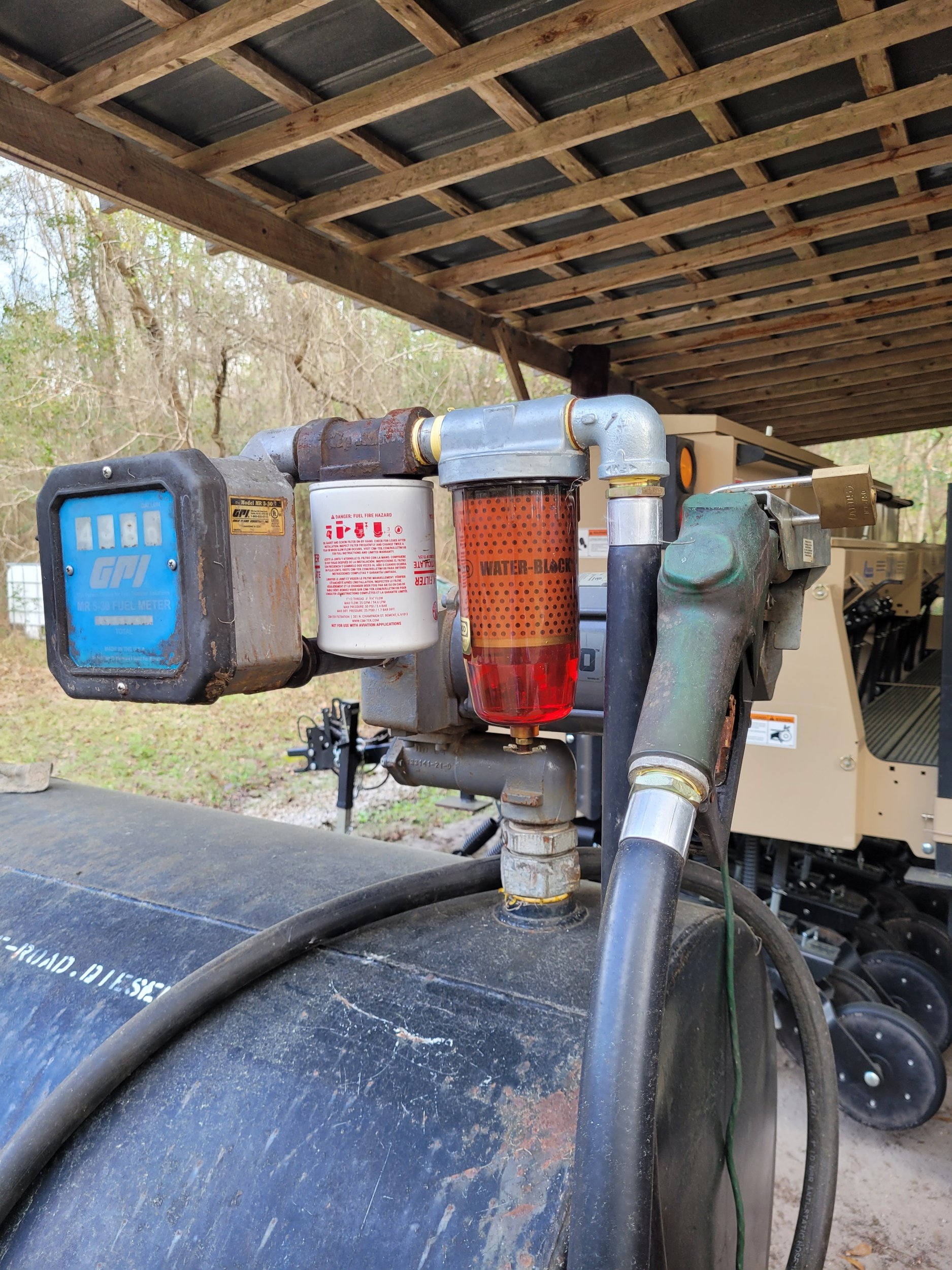

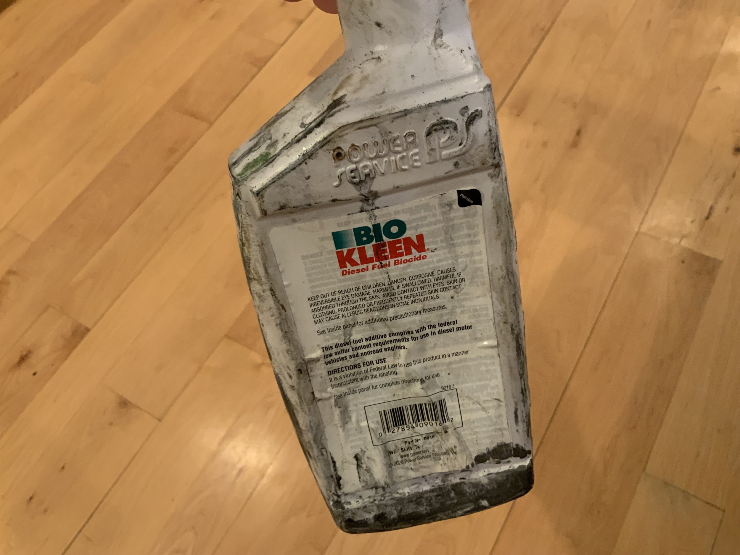

I always use Power Service Bio Kleen diesel fuel Biocide in my 500 gallon bulk tank and have never had any problems, I also double filter coming out of the tank, one water block and one particulate filter

I always use Power Service Bio Kleen diesel fuel Biocide in my 500 gallon bulk tank and have never had any problems, I also double filter coming out of the tank, one water block and one particulate filterView attachment 869917
Thanks, I think that's what I have used before, but I couldn't remember, and couldn't find my old receipts. I've got a water block, but not a particulate filter on mine. Maybe I should consider adding a second. Mine is gravity feed though. I don't know if it would work as well without a pump.

I use Hot Shot in the winter. Really helps. I use this biocide in the summer.

When my 300 gallon diesel tank was outdoors water was in it. I moved it into my equipment storage building and there has never been water in the fuel since. Also on the tank is a fuel filter and water separator. After filling the tractor or other machine I open the bottom drain valve of the water separator to drain a few ounces of diesel out even though no water is visible.
