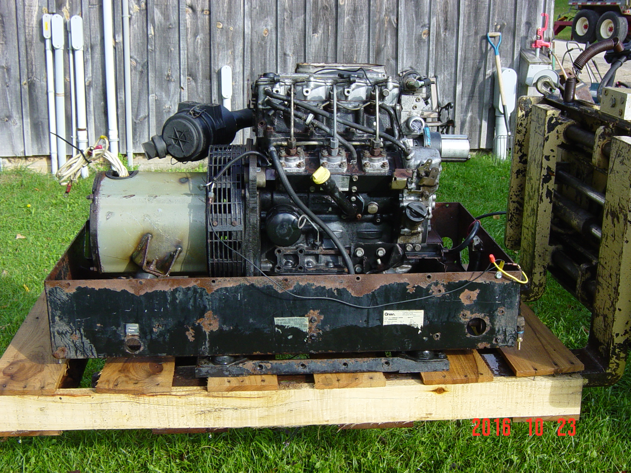

This is what is mysterious about the little gem Izuzu diesel engine driving my 12.5 kw generator. It appears to be an injection engine virtually identical to the Yanmar. Yet, it really emits no diesel-like shudders (in the cold) nor any clatter. If you were around when it is running, you'd never know it was a diesel. You MIGHT possibly pick up a very faint hint of diesel for about a 1/2 second at startup after that glow period. No smoke; not much smell; certainly no real diesel smoke smell. It's a honey.
Really would like to hear from tractor owners that have Isuzu engines in them or maybe past Isuzu pickup owners when they had diesels.
Ralph

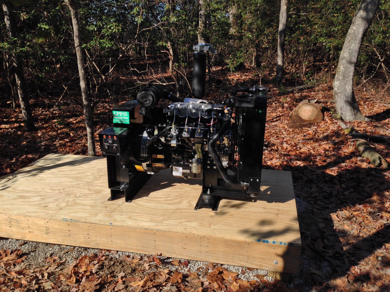

Here's my 21kW Isuzu! Had it for 6 years, never needed to use it yet (knock on wood). Just gave her a maintenance run yesterday.
