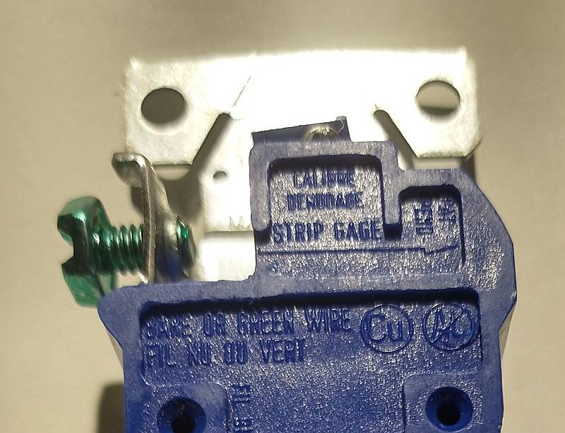

Not really because not all outlets have the wire strip gauge or stripping feature, It is brand specific and no all outlets have those features....
Found on Easton and Bryant brands, but not on Leviton and Pass & Seymour and GE Brands...

Did know that, but in 30+ years as an electrician I never used either.

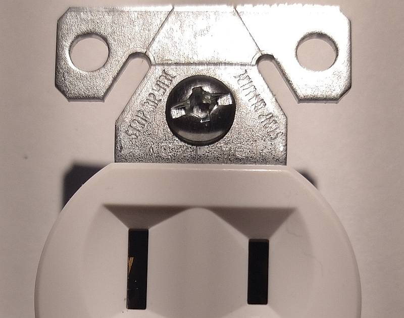

Second one doesn't show up well in this picture, but the left says 'Strip #12 Wire' and the right says 'Strip #14 wire'. No veedeeooo required.
