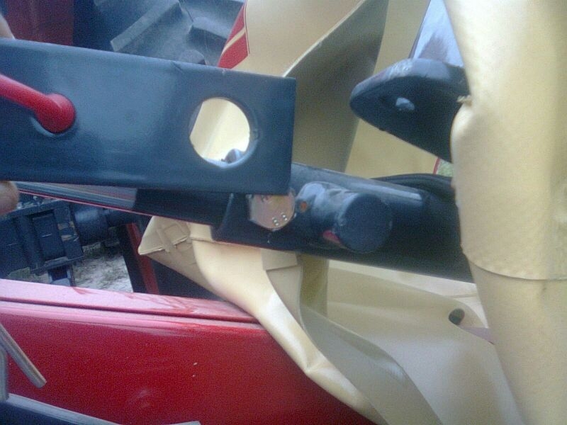

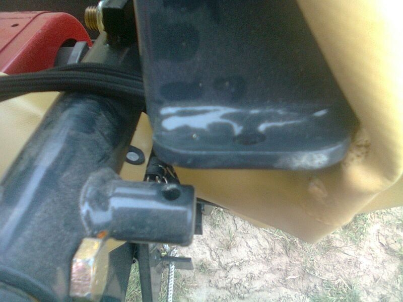

Thanks,I will take off around 3 and try it. Now I have another issue the cutter will not fold all the way over its hitting another piece of the 3point,I am trying to get photos sent to wife so she can email them to my computer. Man I am glad I tried everything out before I really needed it. It something that should miss cause it hits and the cylinder will not go all the way in allowing the cutter to fold back more behind the tractor.

This is as far as the mower goes up cutter up all the way.JPG before these two pieces hitcant get pinned.JPG and here is a close up on the two piecesthese 2 pieces hit.JPG:confused3:

This is as far as the mower goes upView attachment 264656 before these two pieces hitView attachment 264655 and here is a close up on the two piecesView attachment 264657:confused3:
Okay I'm not familiar with your cutter ... I'd say in the second picture the arm that has the hole slides onto the pin and a lynx pin goes in it for transport ... Is that a rope I see? Some mowers you have to pull the rope to to release the other locking mechanism.
I'll study them closer ... what was that cutter Mfg name?

Vicon CM2400. Yeah I pulled the rope,un-locking it making it able to come up,but its past that part and you are right about the part were the piece with the hole is suppost to slide in the other. The thing is if i go up anymore to get it closer the other part hits so I couldnt get it on anyways with it in the way. Thanks guys for the help,I have sent photos to my dealer but kevins been in meetings...

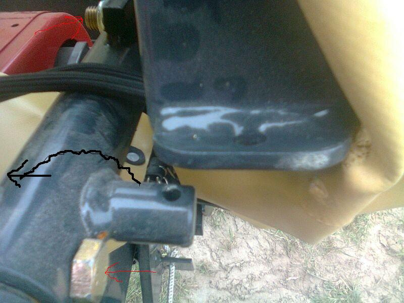

Alright Blueriver,the only thing I can come up with is maybe they installed it wrong and I should un-bolt it and roll it over to the other side.Also the black what look like lines are just bungie cords,they need to be run under not over the top or they are gonna get cut....
The red arrows are the bolts I could remove.
The black arrow showing were I would roll it over and it would be pointing towards tractor.
I know my coloring sucks:laughing:
I wish I was more help ... just not familiar with that cutter. Does the owners manual show anything?

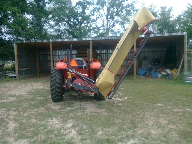

FE, it's hard to tell from your pic's what the trouble is. My drum cutter is a bear to fold and unfold by myself but it swings straight back, not up. What HP tractor is that thing on??...... it looks a bit undersized for a 10'er.

Its on a 46pto HP,its a 8ft. The thing will not go up anymore,cause them two pieces are hitting. I have looked threw the manual pictures suck,I also e-mailed photos to dealer yesterday and they havent got back to me. Good thing im not in any hurry to use it,I would have been in bind...
