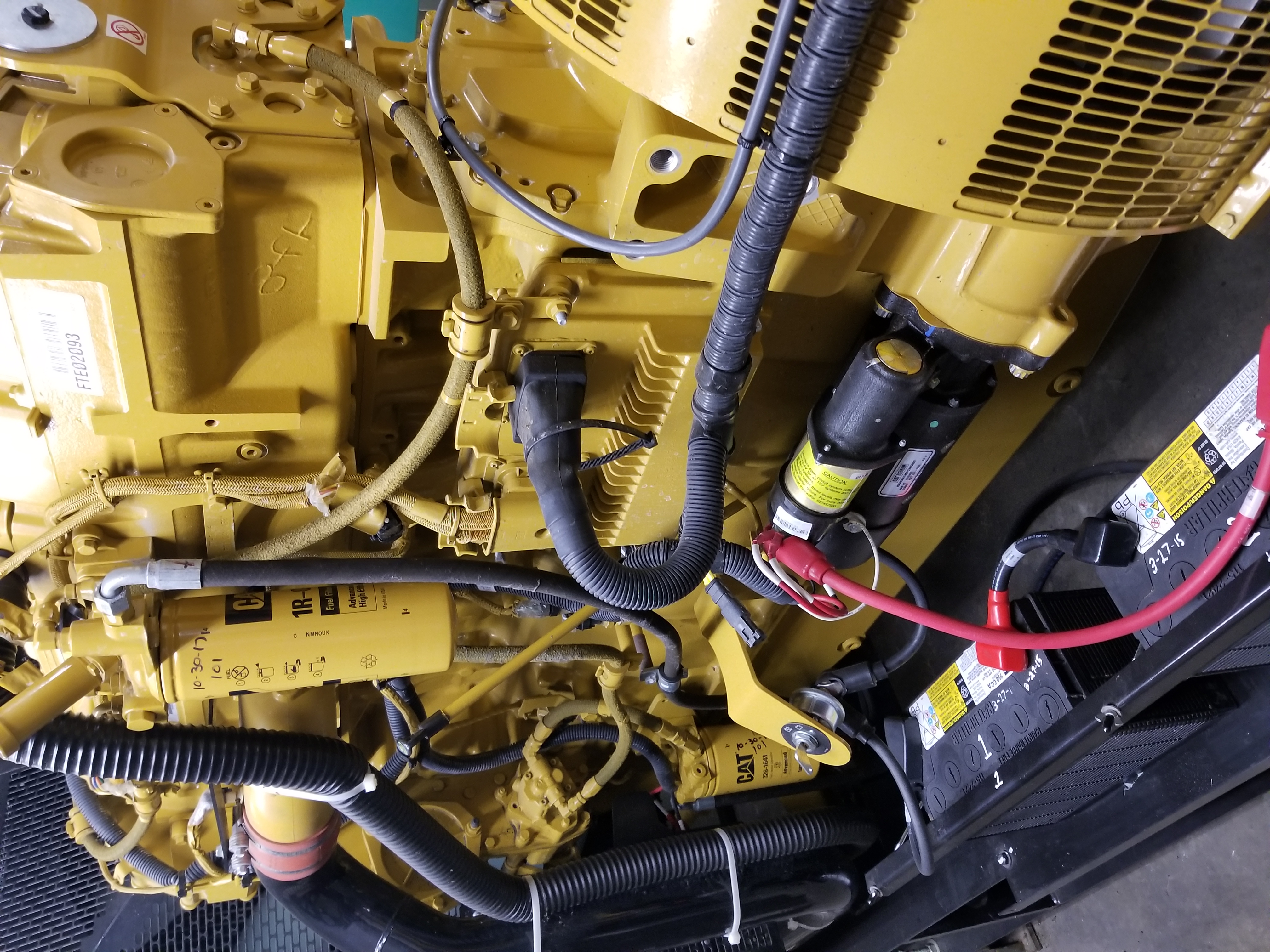

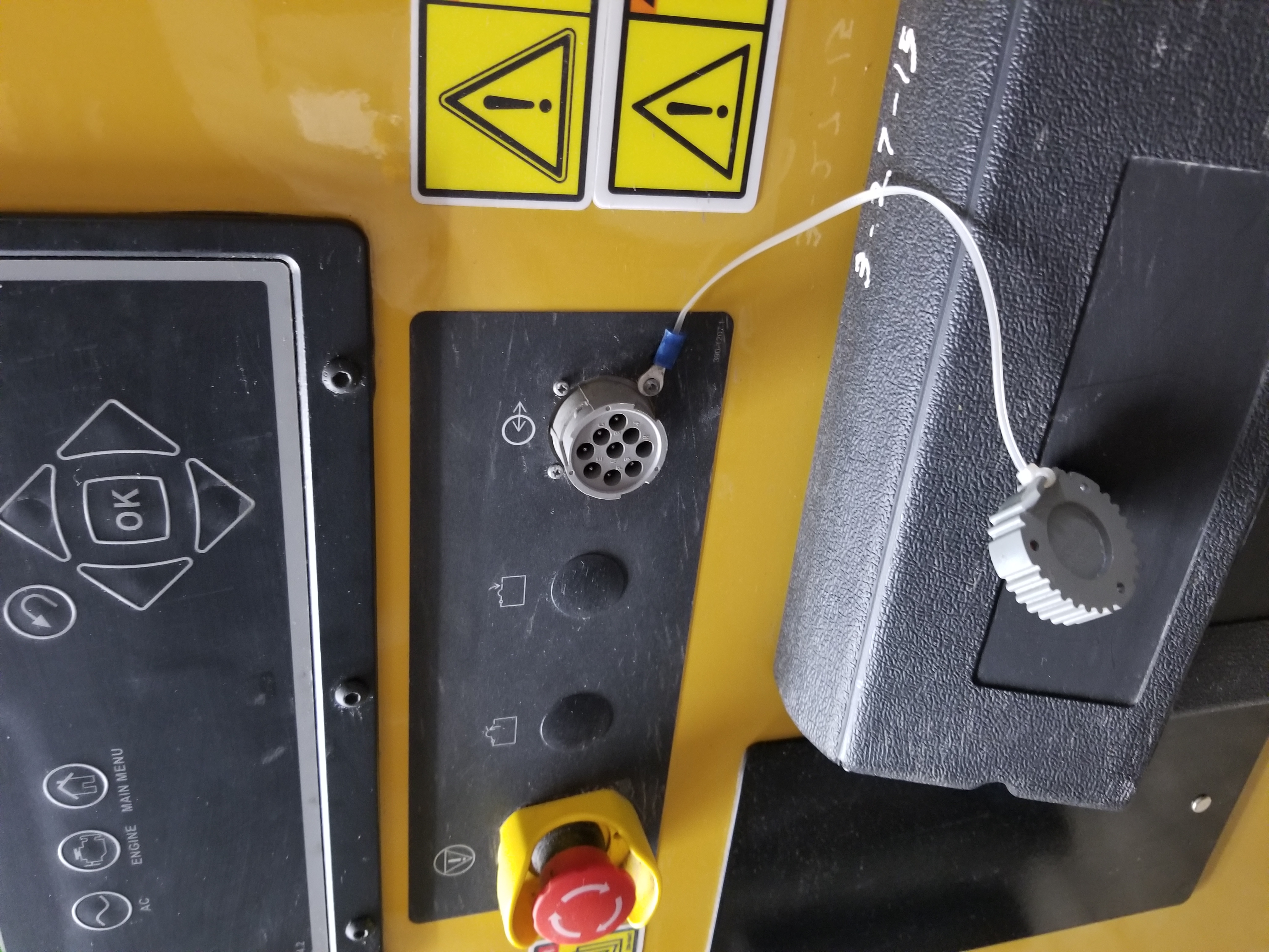

Another fine day at work , same diagnostic plug as LS tractor
/ Diagnostic code reader
#70
Unkeyed 9 pin same as LS Tractor J1939
