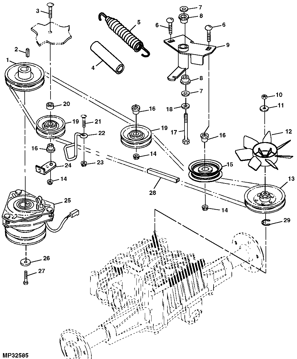

On the GX series the Trans Belt is rotating all the time the engine is. So most likely one of your 3 x idlers is failing.
If the noise goes away (I know you say yours is constant but for anybody who finds this thread in a 'Search') if the noise goes away when PTO is engaged the bearing failing is the one at the bottom of the PTO clutch.

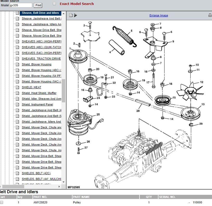

You can go to jdparts
John Deere - Parts Catalog
and see schematics of the parts by putting in the model #, then browsing the alphabetic listing. Here may be a shot of your parts.

Well Moe, You're not doing the drive system any favours by continuing to run with a damaged belt.
Changing belt requires:
Deck off.
Release big covered spring tensioner (# in my and Beenthere's pix above)
Remove PTO Clutch - Disconnect wiring at plug. Remove centre bolt. Unit should come off with 'gentle persuasion'.
Pulley above should drop down similarly.
Couple of wire-guides on the belt to loosen and allow belt removal also.
Idler bolts are of the Square Shank type which will stay put as you undo nuts to remove idlers.
Note PTO Clutch has an Anti-rotation 'Peg' located in one corner. Ensure you refit in correct orientation.
Strongly advise against continuing to opertate with a damaged belt. Causes excess wear on tensioner plate etc.
