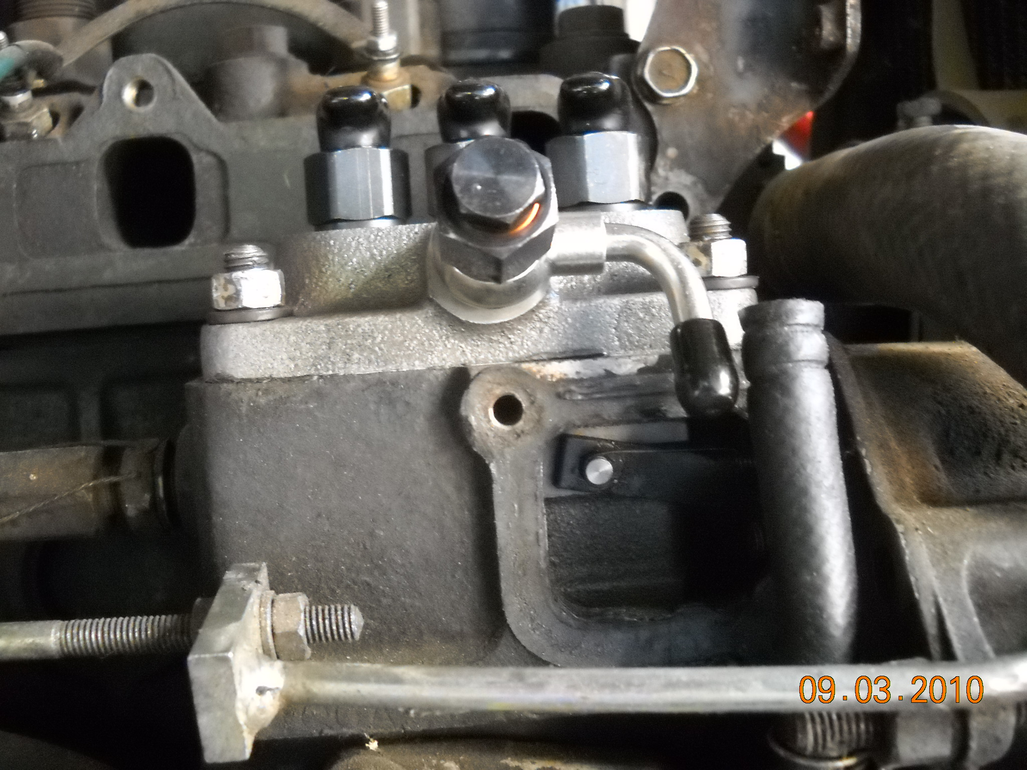

I payed just a little over $600 for a brand new injection pump. Now, How does the fuel spirt out? Mine has small spirts and with the injection lines removed the fuel will spirt up 2-4". Rebuilding it just cant be worth it if you can get a new unit for the same price.

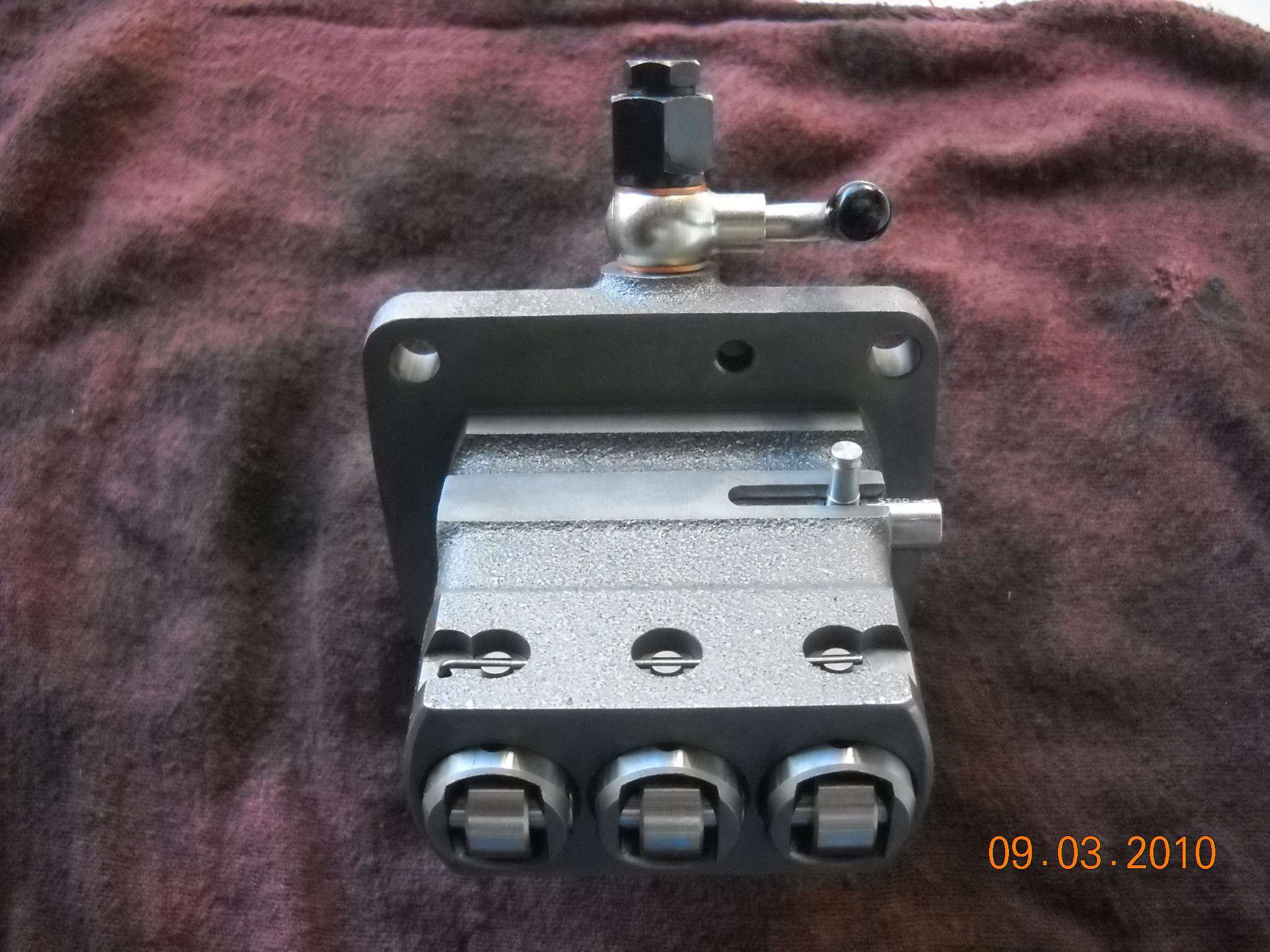

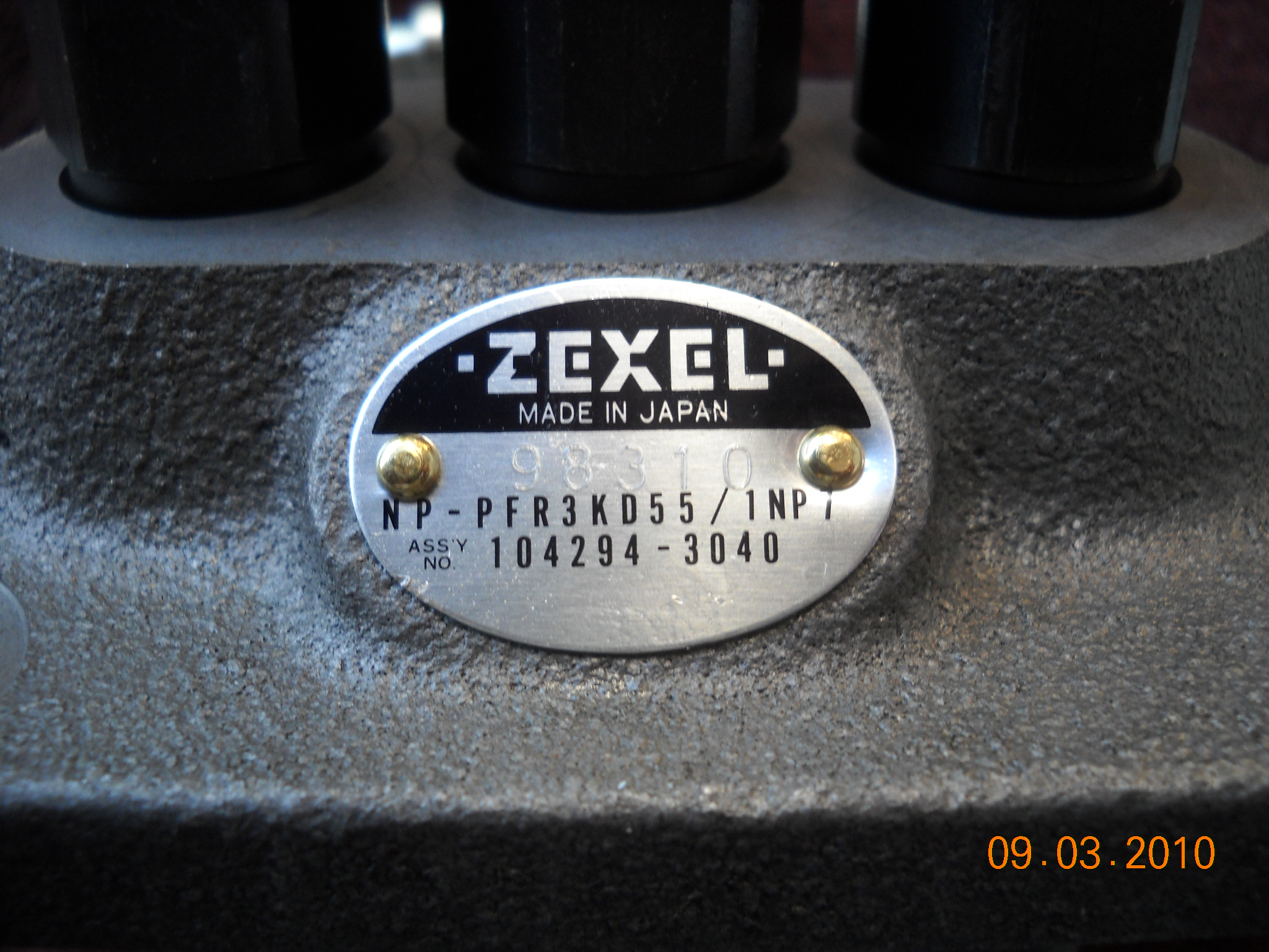

Here are pictures of my fuel injection pump prior to installing it. I tried 2 used pumps but they both failed to work properly and were really wore so going new was my last option. My original pump was corroded very badly and impossible to repair or rebuild. My tractor sat outside for 15 some years. before I got it.

I got my new pump here Oregon Fuel Injection, diesel fuel injection pump, turbo, injector and diesel performance product specialist. . It was a special order but it came straight from the manufacturer, Zexel. Its model number is NP - PFR3KD55 / 1NP7. With what you are trying to accomplish really has me confused. 2-3 extra hp isnt much. What are you trying to get better power out of? the hydraulics? the PTO? :confused: 2-3 hp is only 21 hp at most. the difference betwen 18 and 21 is very insignifigant. With hydraulics you can add shims or something to that matter that would better your hydraulic preformace.
