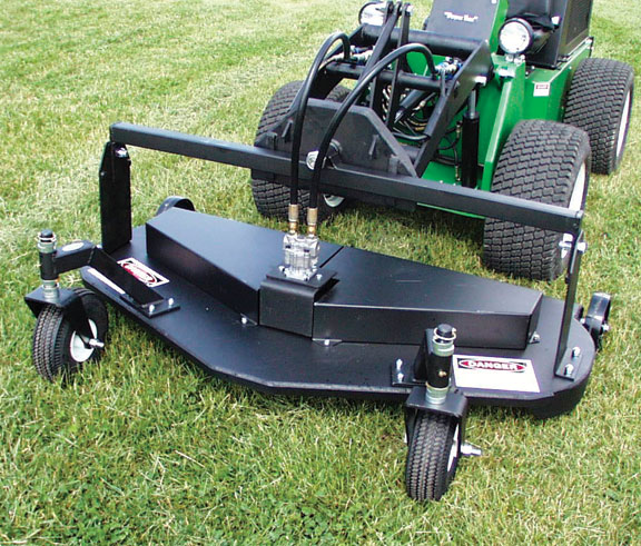

If you have 31 HP, you can run a pump pumping 15 GPM's. That means you can transfer about 26 HP to a hyd motor. That deck will probably run on 10 to 15 HP. It will depend on where you are putting the hyd motor as to the size. Are you wanting to turn the drive shaft with a hyd motor, or mount a hyd motor directly to the deck?
Do you have any pictures of the deck showing the pulleys.
This is how the Power-Trac decks look with a hyd motor. It is probably something around 3 to 5 cu in cu in. This valve will let you control the speed of the motor.
https://www.surpluscenter.com/item.asp?UID=2009120107180253&item=9-4169-10&catname=hydraulic
I would select a hyd motor that will develop about 15 HP, and work on the pulley ratios to get the speed the deck requires.

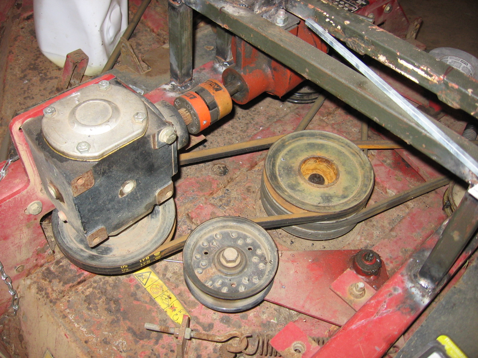

I took a couple of pics tonight. The pulleys are 6 1/2" pulleys, on the gearbox end and then to another 6 1/2" pulley that has an individual belt going to both sides of the deck. The pulley on the gearbox is splined and takes what appears to be a B or a C type belt. My bro said max RPM at the gearbox is 2700 rpm. So I would guess :confused: that the 1800 rpm I thought I remembered from before is probably a good base to start with.

I did not realize that you already has a hyd motor mounted. Do you know what the pressure and displacement of the hyd motor?
I am converting a bush hog mower into a hyd drive unit, and knew the rpm was 540 from the tractor, so looked on Surplus Hydraulics for a motor that matched up to the shaft rated at certain HP. One like this.
https://www.surpluscenter.com/item.asp?UID=2009120118352695&item=983-1034&catname=hydraulic
I am in the process of finding more of that out. It is a hydreco model 1510c3c1 . I was told by my dad, who bought it new, that it could be either a motor or pump. I did contact Hydreco directly to inquire about specs and was able to get specs from them on their superceded part as this model is no longer in production. However their superceded model is not recommended for use as a motor, so I am waiting to hear back from them on if that applies just to the superceded model or the one I have as well. Like I said, I had mounted the motor before when I was trying to use the mix and match what I can find for free method and it can come off real easy if determined that I need something else. I do have a huge motor from a hydrostatic drive unit, but I would imagine that that would never be able to spin fast enough to be usefull. I also may have access to what I am told is a 1800 rpm motor off of an old dirt stacker/conveyor from a screen machine.
