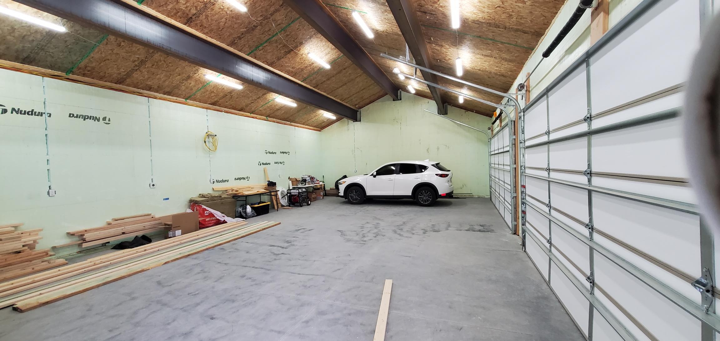

For my insulated detached garage (1,200 sqft). I was thinking of getting a 1 ton ductless minisplit unit to help cool it in the summer and provide a little heat in the winter, if needed. Would the 1 ton be undersized for an insulated garage? (R-30 walls/R-40 roof/R-8 car entry doors) I'm in Zone 4B (High Desert)
Which option should I go with:
A – 1-Ton - SEER2=24.00, HSPF2=9.00, Able to heat down to -22F = $1,200 for the unit
B – 2-Ton - SEER2=17.00, HSPF2 = 6.7, Able to heat down to 5F = $1,200 for the unit
The 2-ton unit is not as efficient as the 1-ton unit, hence the pricing difference. Which would be the best unit for the garage?
/ Detached Garage - Ductless MiniSplit #2
Look up load calculations for HVAC and run the Calc. You need a lot more info, like number of windows, directions of the windows, and most importantly the height of the garage as the volume of air matters. You need a large unit for a 16’ high 1200sq ft garage than an 8’ high garage.
/ Detached Garage - Ductless MiniSplit #4

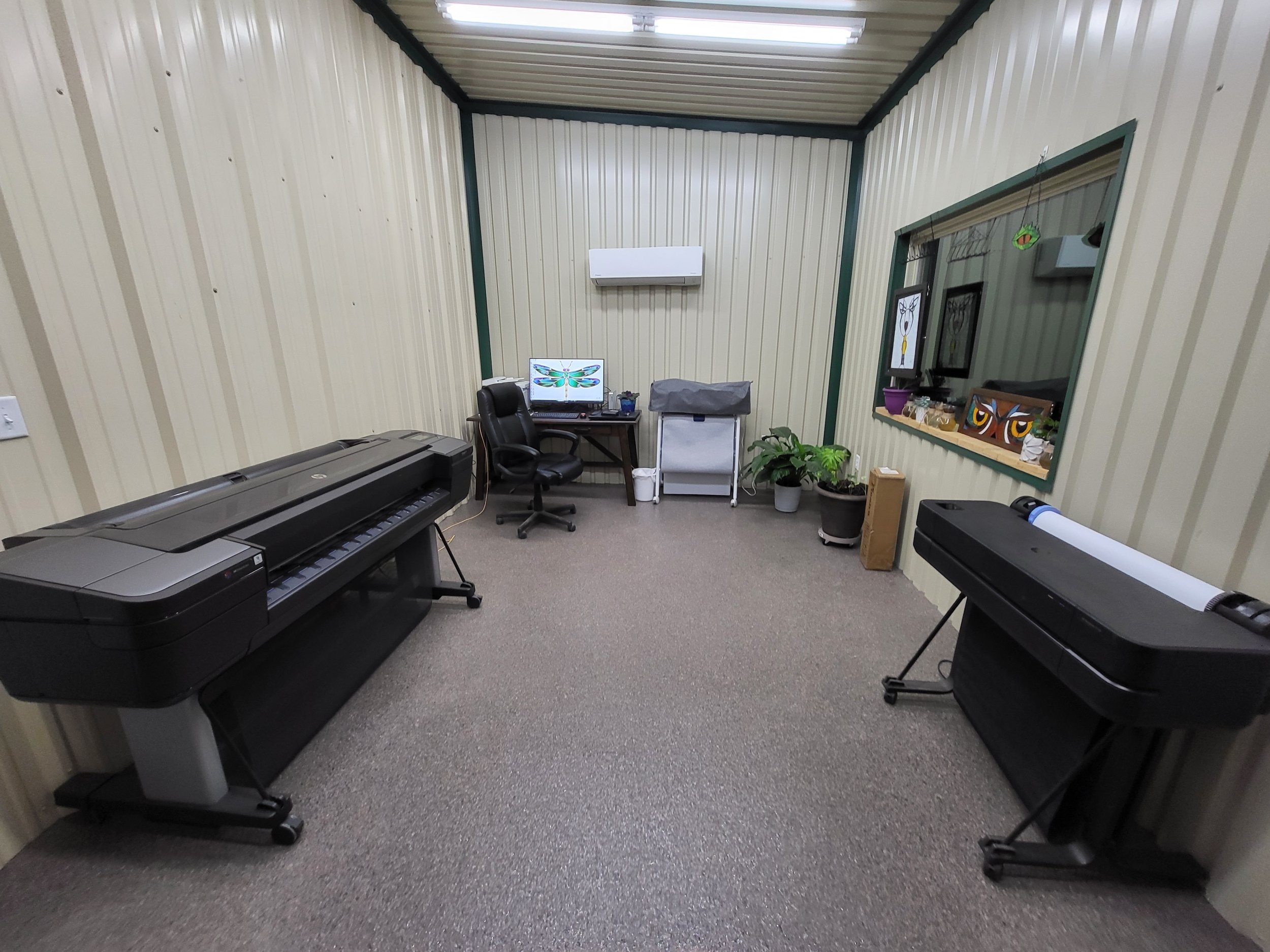

I don't think you will have enough capacity if 12,000 BTU = 1 ton, as I have been told. We have a 30'X40' insulated metal shop with a 14'X20' wood framed insulated room inside for stained glass work. The HVAC company put in a 12,000 BTU Daikin mini split for that room. Added on to the west side is our our 12'X20' shop office. It is insulated with metal walls outside and inside. The HVAC company used an 18,000 BTU Daikin mini-split because of the higher heat load. The main shop has a 50,000 BTU electric heater just to keep the plumbing from freezing in the winter.
Appreciate the info.
Last winter the garage never got below 58F.
There are NO windows and the height of the garage peak is 16' as a gable so it starts at 10' and peaks at 16'. There are TWO insulated (R-8) car entry doors (18x8) and an insulated side entry door (R-7).
The garage walls are high-mass (concrete) so the R-Value is R-30 but studies show the Effective R-Value can be as high as R-50.
I think I will go with the 2-Ton unit...

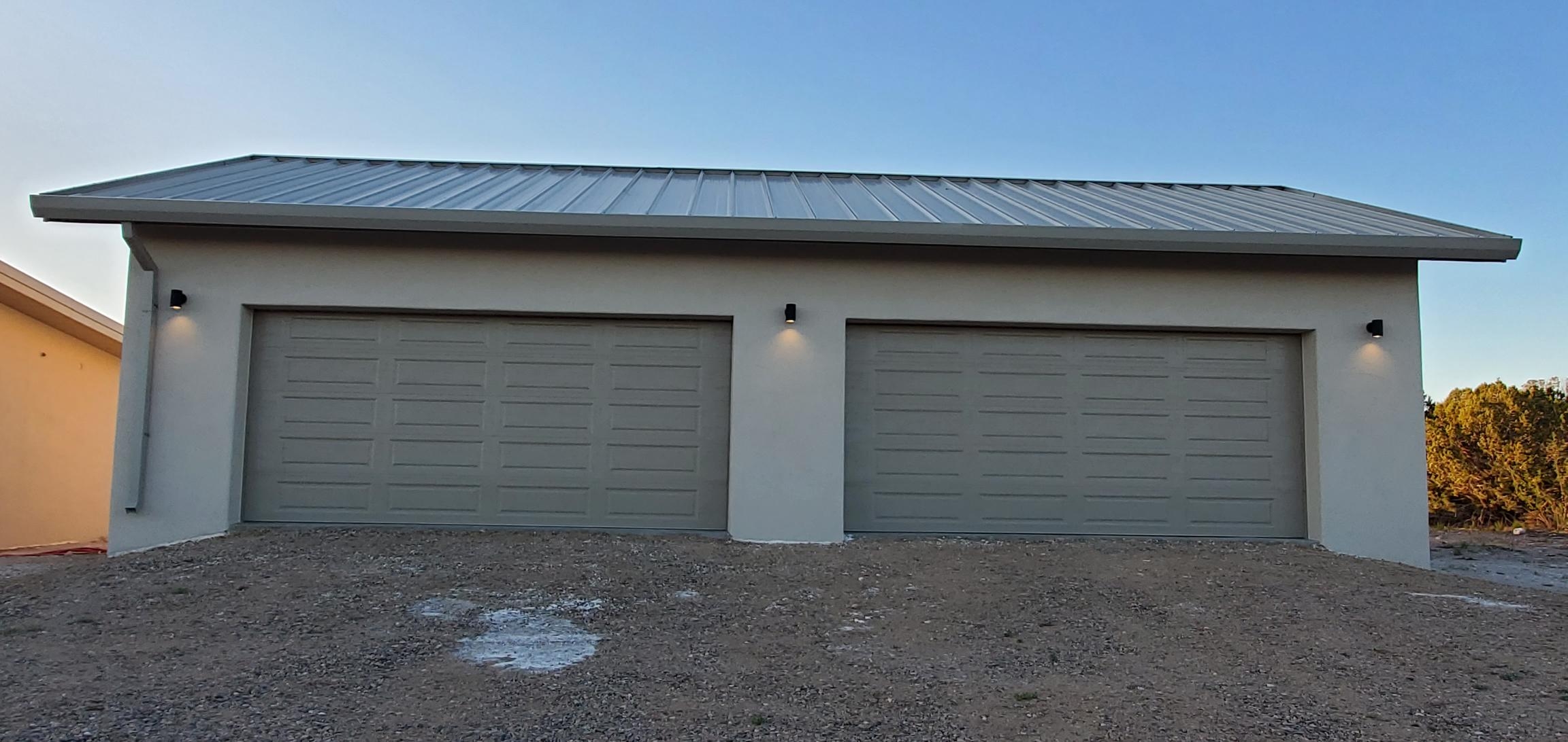

Nice garage. Looks like a long span for those beams, what size are they?

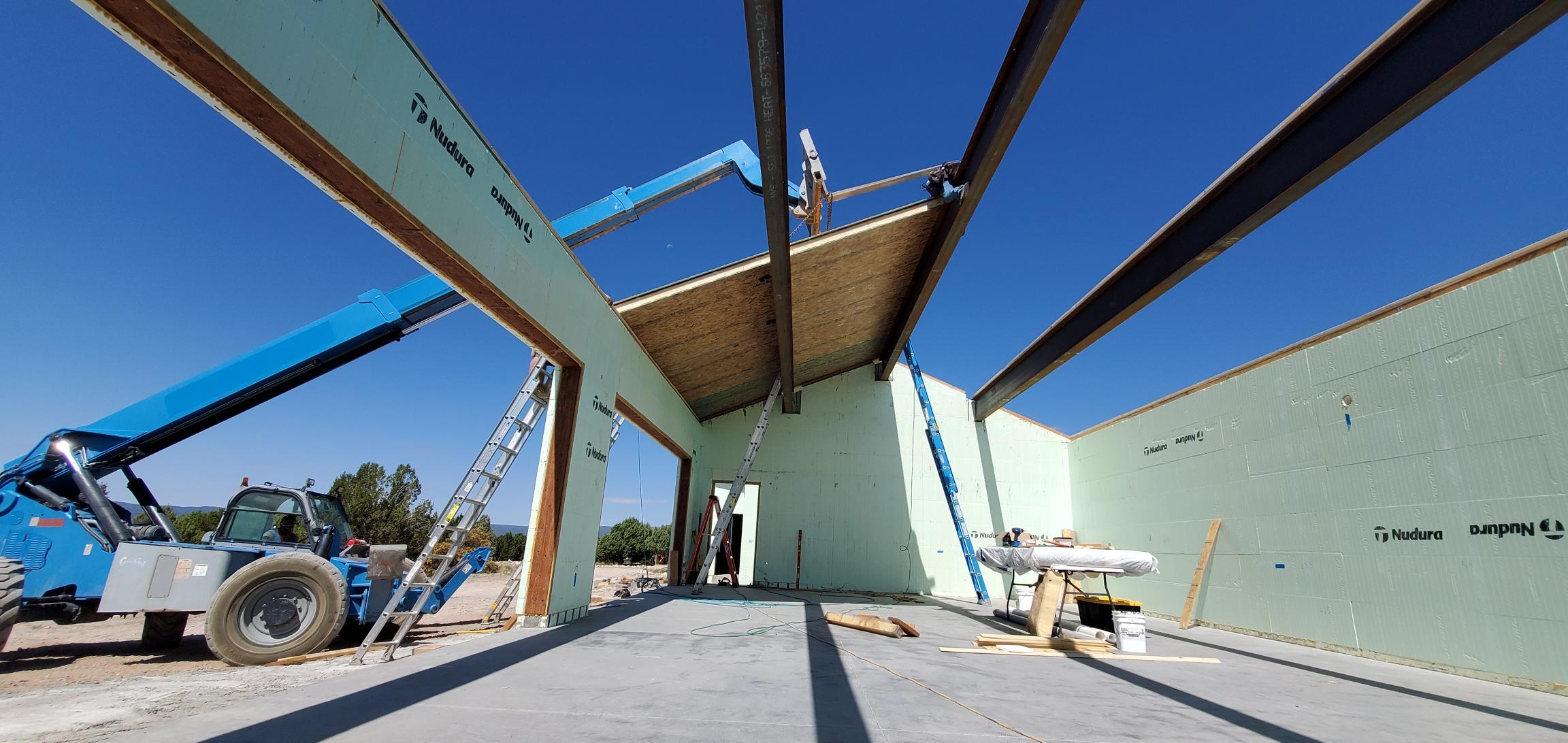

Span is 48 feet.
Beam is 21" tall x 6.50" wide with a thickness of 0.45 at the top and bottom plates and a web thickness of 0.35. Yield strength of 36,000 psi. The beams weighed 2,110 pounds per beam. Price was about the same at $2,200 per beam.
Steel plates were embedded into the wet concrete during the wall pour. The beams rest on these steel plates and were welded down to the steel plates.

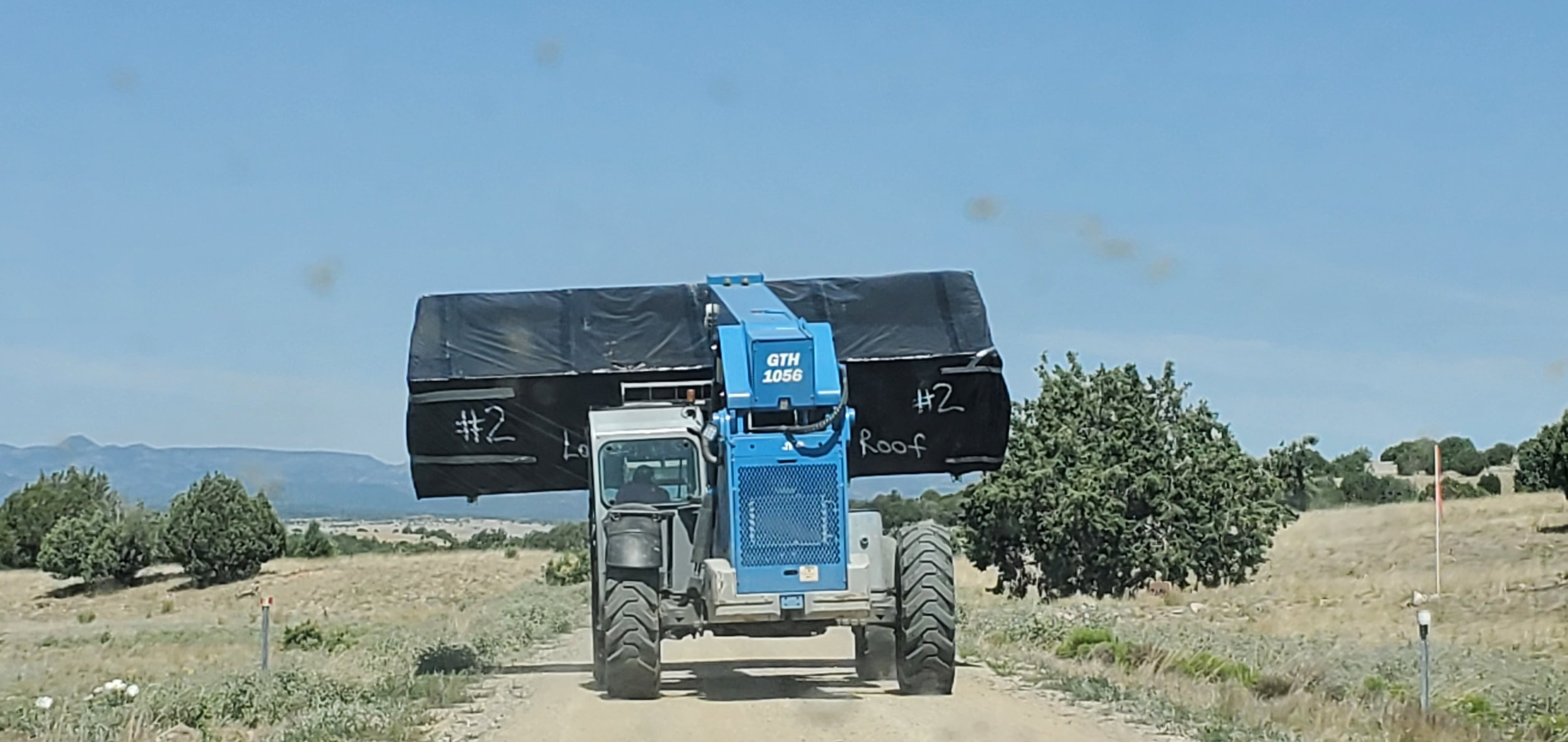

(y) No problem. I didn't want any mid-span supports as that would get in the way of having an open space and require footings inside the garage. So the engineer called out for these beams to span that distance without mid-span supports. These style of beams are used in NYC skyscrapers.
I can't get a 53' semi truck onto my rural lot so I had to unload the beams at the street and then use a telehandler to drive each beam, one at a time, over 1 mile to get to my site. It was a little unnerving having that beam in the air while going down the road.

@Pettrix Wow. I'm sorry that you didn't shoot video of moving the beams! That is a lot of mass and inertia, and the photos make it clear that it has to be up in the air some of the time to clear the shrubs and trees.
It is a gorgeous garage, and some thing to be proud of.

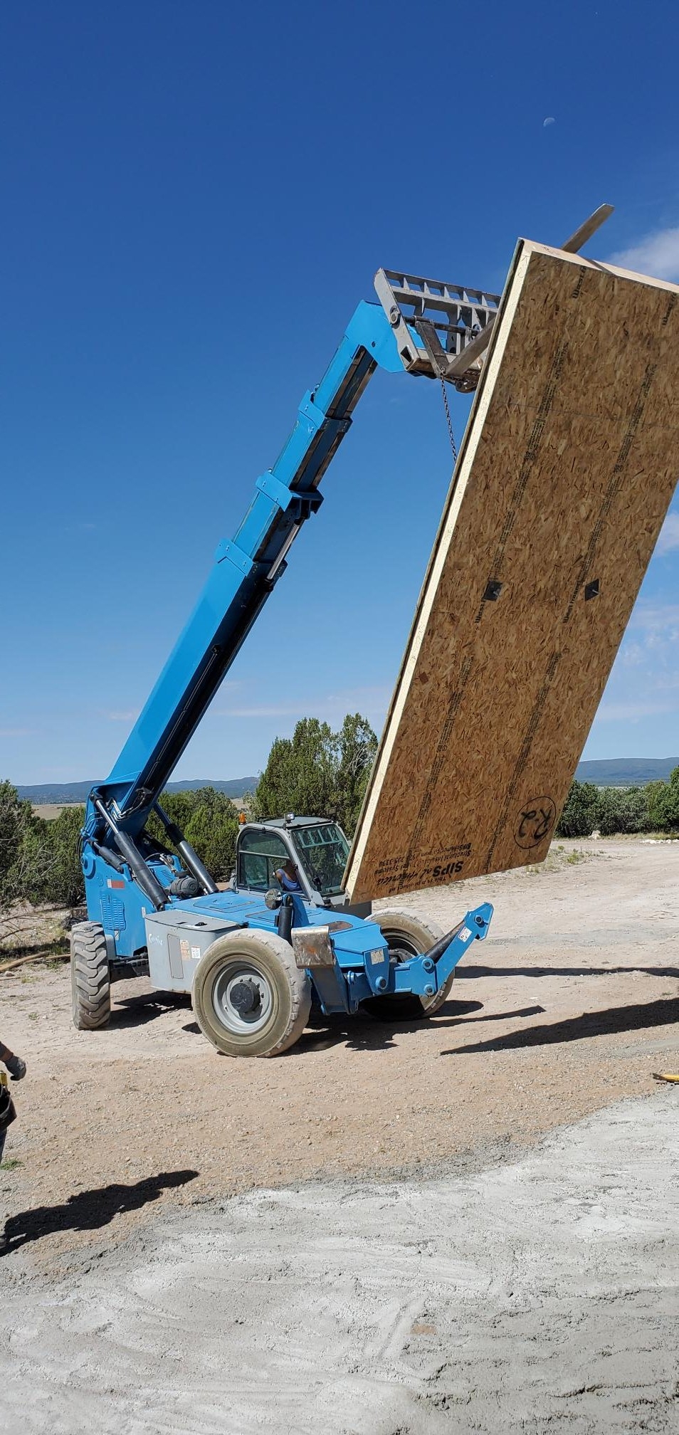

Thanks! The garage has taken a lot of work and money to get to this point. I work full time and then work on the garage after work and on weekends. So it has taken a while to get to this point.
The beam had to be lifted up over 20' at times to clear the juniper trees. That got scary as being so high up in the air, the wind gets it and it starts to move around. I was fearful the beam would fall. We had it strapped but it got sketchy at times. The telehandler has a wide base so it's pretty stable but everything has it's limits.
I also used polyurethane SIPS for the roof. We had the garage beams and roof installed in just 1 day. Once the beams are in place, the SIPS panels are labeled and go on pretty quickly with a crew of around 8 people. They get screwed down into the wall top plates (4x6 wood) and the steel beams had wood top plates installed on them for an anchoring point. The SIP screws are 9" in length.

I did an ICF (6" concrete core with 5.50" of EPS) wall and polyurethane roof SIPS. There are basically 2 types of SIPS (polyurethane core vs polystyrene core). The polyurethane is stronger, has a Class A fire rating, and has higher R-Values but it does cost more. I used SIPS of America out of Missouri. Panels are 6.50" thick and get a R-40 value.
All panel connections are T&G, double gaskets, foam/taped and sealed on both sides with SIGA tape. It makes them air tight at the connections.
Another nice thing about the SIPS is that they give you an overhang without having to frame out and build out soffits & fascia. Once the panel is installed you have a 24" roof overhang that is ready to go. I then had it covered with metal fascia and soffit pieces. There is also no need to run soffit vents, which is important in wildfire areas like mine. Embers are enemy #1 and any soffit/gable/ridge vents are an access for embers.
Building design should be specific to geographic locations. Concrete and steel are your friend in wildfire areas. Overhangs work great in desert climates to keep the sun off the walls but work against you in high wind/tornado areas as overhangs become a lift point to peel off roofs. Hip roofs work best in tornado areas. Gable roofs do not. There is no one size fits all when it comes to building. There are pros/cons to each type of material and design.
