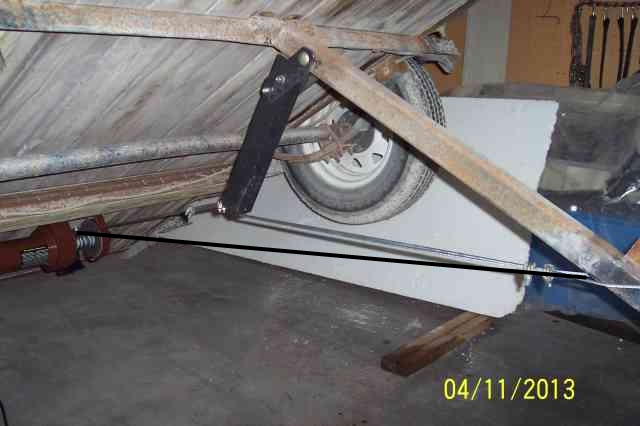

Here's what I've come up with so far:
The winch is a 3000 and, yes, yard and garden residue is probably all it will handle and that is my intention. The black lever added is a piece of 2" SQ aluminum and, yes, it does increase the mechanical advantage considerably. The cable passes thru a small hole in the backside end of the lever and the clamp behind it ensures that the lever will be tucked up under the tongue for road transport and held by the winch.
I'm concerned that I won't be able to get sufficient dump angle because of the 2" ball hitch bottoming out when the tongue is tilted at an angle to the towing vehicle. Will have to do some testing and perhaps some further mods.
I appreciate the thoughts and suggestions. Keep 'em coming!
Edit: I have looked at some of the designs where guys have mounted a post on the front of the trailer with a sheave at the top along with a winch down below. They appear to work well but I don't care for the idea of the long post sticking up in the air.
Edit 2: I did remove most of the extra cable from the winch drum so that it gets more leverage on the cable by applying the load at a smaller radius. Makes me wonder how winches are rated--with a full load of cable or down to the last few rounds on the drum. Makes a big difference although they are probably greatly over rated anyhow.
/ Designing Electric Dump On Trailer #11
I don't see how the winch pulls the lever down to the starting position, or do you have to push it down by hand?
Notice the black line that I added, you are losing mechanical advantage once the cable gets above a straight line.
But it may not matter, because after the back of the trailer hits the ground, you will have to back up the tow vehicle to get more dump angle, since the winch won't drag the back of the trailer forward.
Winches are rated on the first layer.
