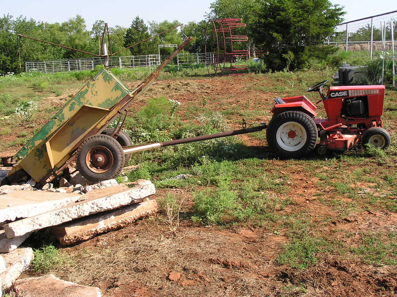

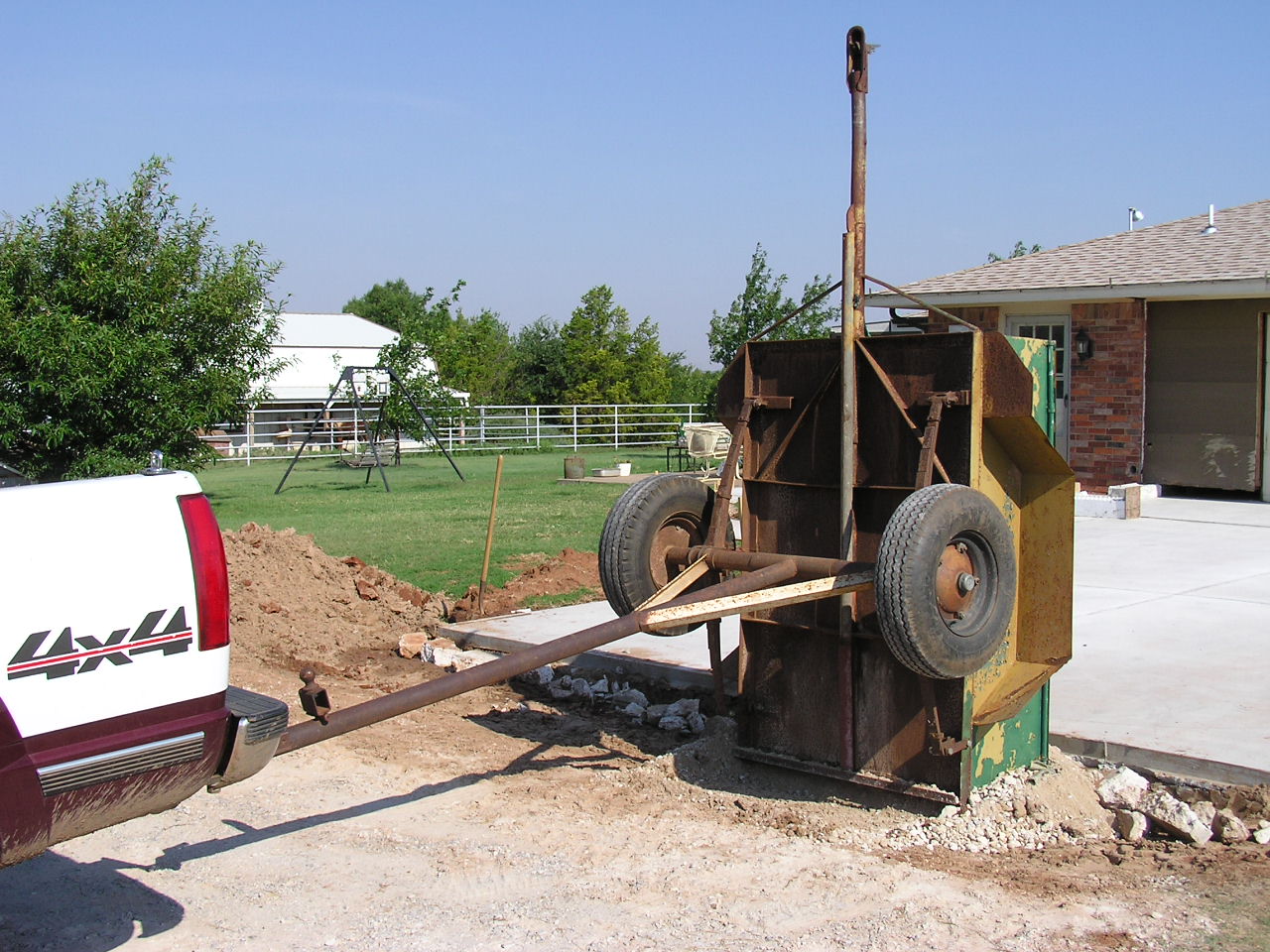

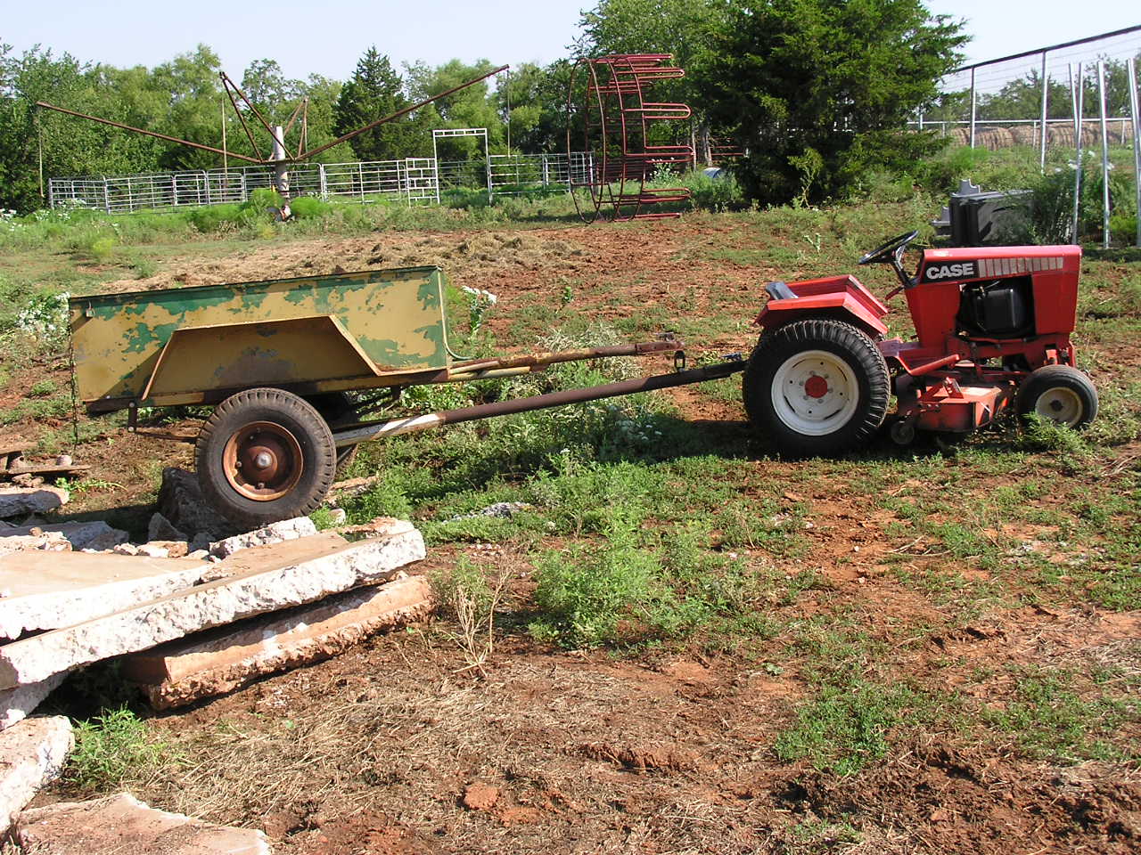

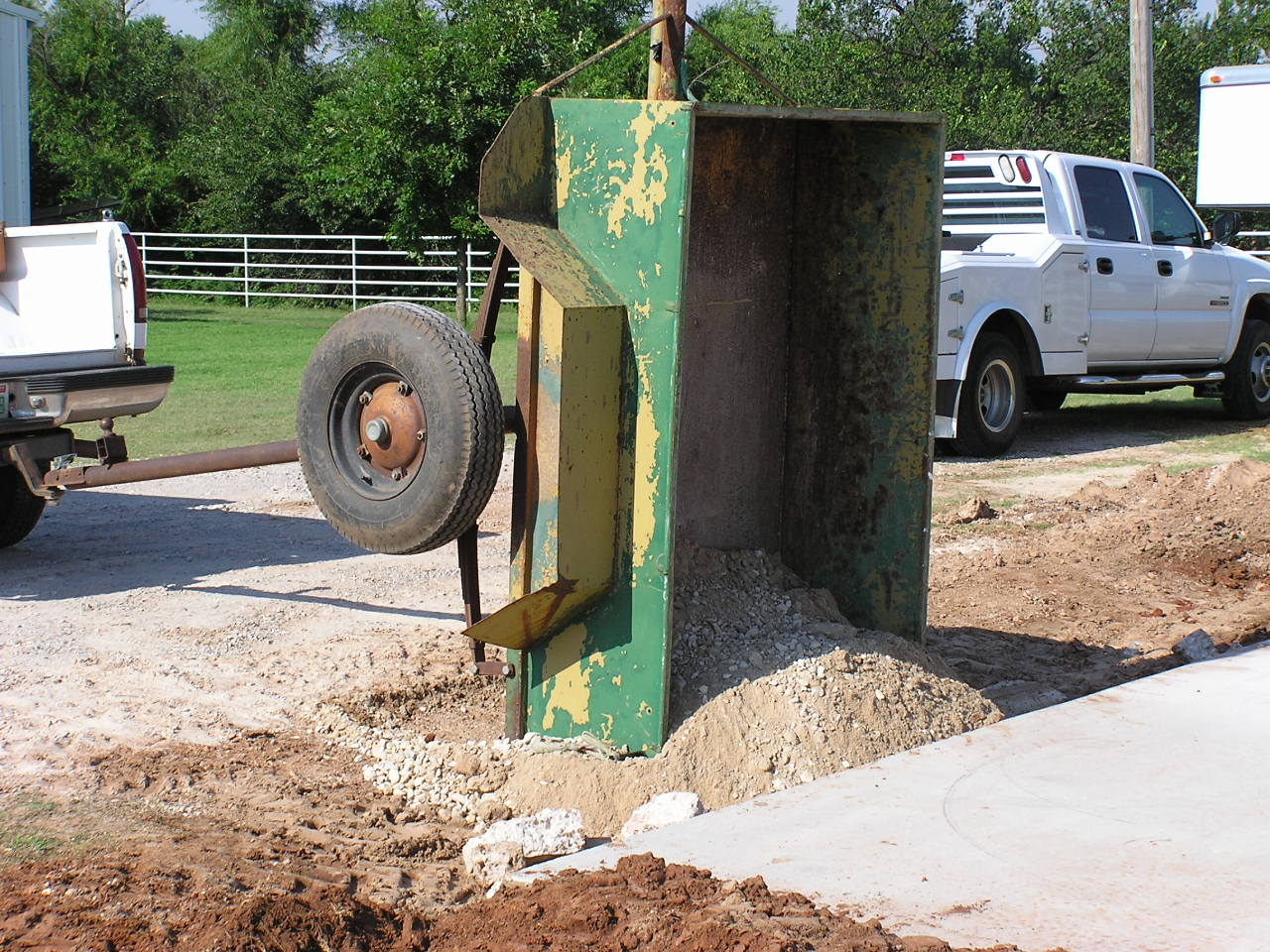

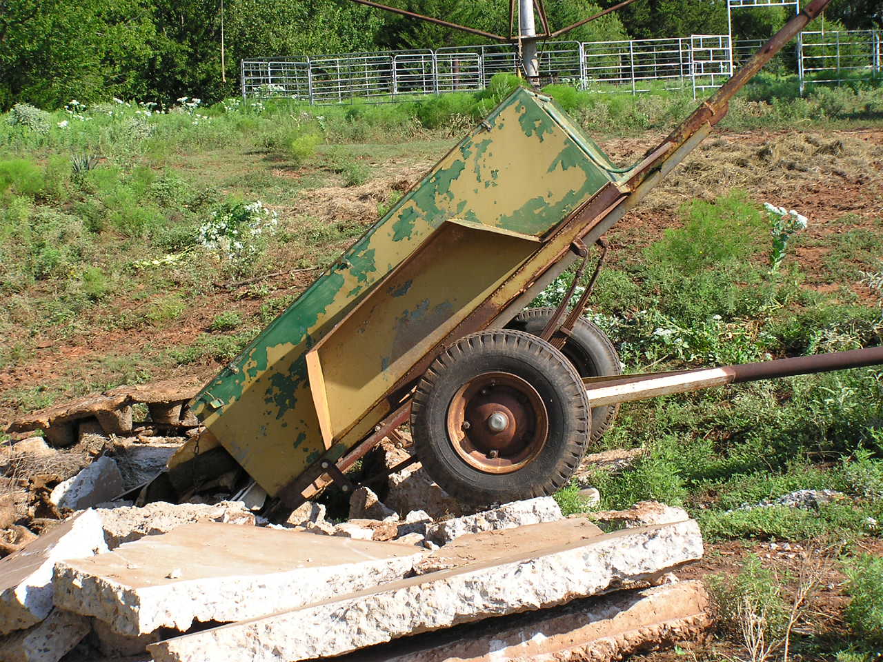

Like this.
I have had it completely upside down when on the higher front hitch on the MF 240D tractor.

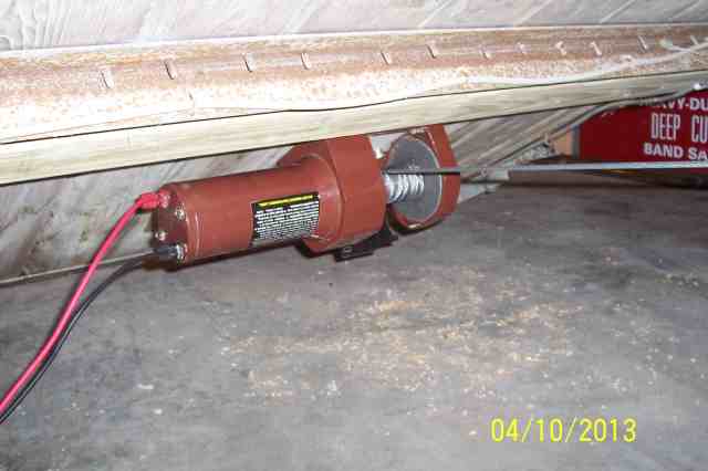

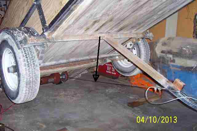

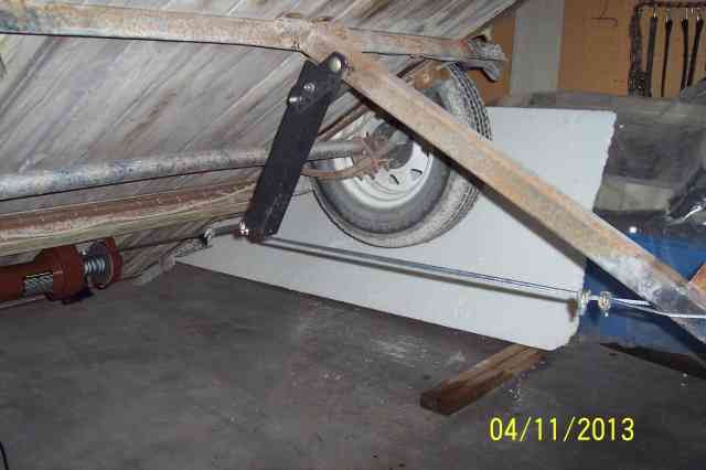

This is a prototype/mockup of what the winch/lift will look like under the 4x8 trailer. The geometry works out fairly well but haven't tried it yet with a load. It does make the HF 3-ton winch groan and slow down when starting the lift but the lever arm (shown with the arrows) increases rapidly as the trailer pivots on it's rear end.
I'm considering adding a drop-down lever arm attached to the tongue. It would drop down when the pin is pulled letting the trailer tilt back to the start position of the winch lift. The drop down lever would have a pad on the end for the cable to seat against during the lift.
The tongue pivot is a little hard to see but consists of a 1" diameter pin welded to the tail end of the 2x2 tubing tongue. It pivots in two bushings welded to the trailer frame. I'm considering improving this by widening out the pivot with a v-shape at the rear of the tongue. (To give the tongue more lateral stability.
Any thoughts, suggestions etc on what might be done to improve this approach?

you need a new pivot point on the belly of the tongue ....
right now you have a straight pull on the rear of the box to the tongue ... put a "block" between the cable and the tongue... it will change the geometry of the pulling forces ..... think of 2 people holding the ends of a rope, a small child can press in the middle and pull the 2 adults together.

As your pivot point is pushing the bed up, the further ahead of center point the less strain you will have on your winch. A snubbing device would prevent trailer from going completely over in case of a rollback.
   / Designing Electric Dump On Trailer #9
that looks to be a 2-3000 pound winch. There is no way that that wich will lift a 4x8 trailer to dump filled with material at that angle at all. maybe grass clippings. That trailer will easily hold 2 yards of dirt which can weigh over 2 tons. Even if you put only 2000 pounds in that trailer, the way you have it set up would be like trying to pull 4000 pounds or maybe more. For the wich to use its capacity, It would be have to be mounted at the front of the hitch with a boom pole welded just before the bed along with a couple pullies so it is lifting the front of the bed

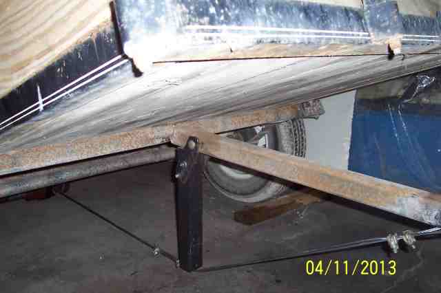

Here's what I've come up with so far:
The winch is a 3000 and, yes, yard and garden residue is probably all it will handle and that is my intention. The black lever added is a piece of 2" SQ aluminum and, yes, it does increase the mechanical advantage considerably. The cable passes thru a small hole in the backside end of the lever and the clamp behind it ensures that the lever will be tucked up under the tongue for road transport and held by the winch.
I'm concerned that I won't be able to get sufficient dump angle because of the 2" ball hitch bottoming out when the tongue is tilted at an angle to the towing vehicle. Will have to do some testing and perhaps some further mods.
I appreciate the thoughts and suggestions. Keep 'em coming!
Edit: I have looked at some of the designs where guys have mounted a post on the front of the trailer with a sheave at the top along with a winch down below. They appear to work well but I don't care for the idea of the long post sticking up in the air.
Edit 2: I did remove most of the extra cable from the winch drum so that it gets more leverage on the cable by applying the load at a smaller radius. Makes me wonder how winches are rated--with a full load of cable or down to the last few rounds on the drum. Makes a big difference although they are probably greatly over rated anyhow.
