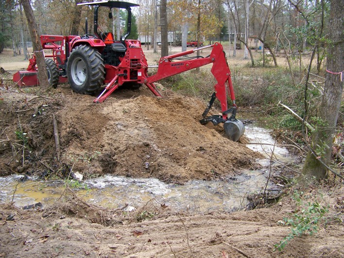

Horsepower to horsepower, Mahindra is a more heavily built tractor. I don't have gravel, but sand and water in my gully and that spells backhoe. Since you will be playing with gravel, check the loader lift weights on Kubotas and then Mahindras.:) You will be surpriseed at the weights a Mahindra and KMW loader will lift.:D Whichever way you go, get the skid steer quick attach bucket option. :cool:
hugs, Brandi
