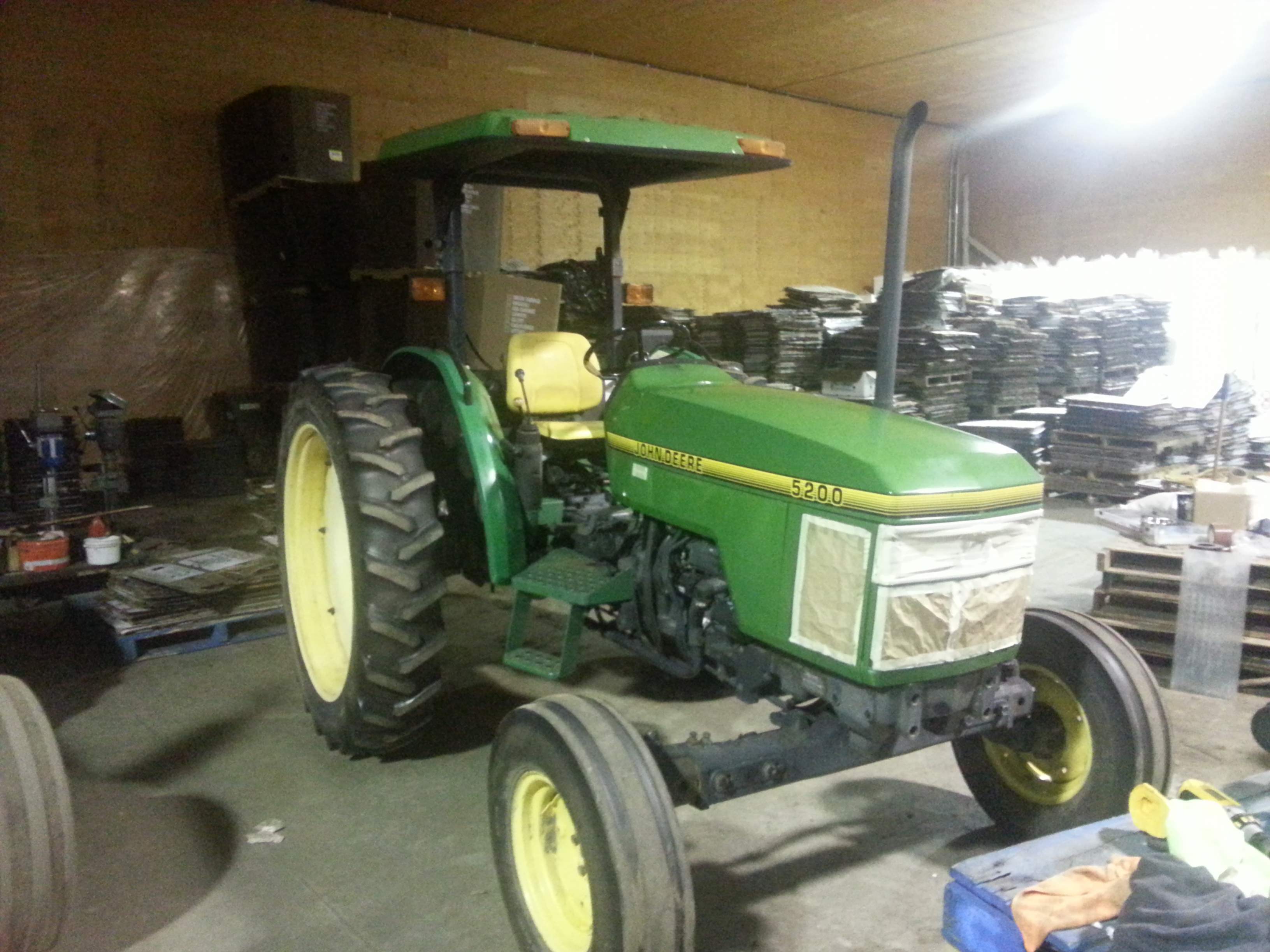

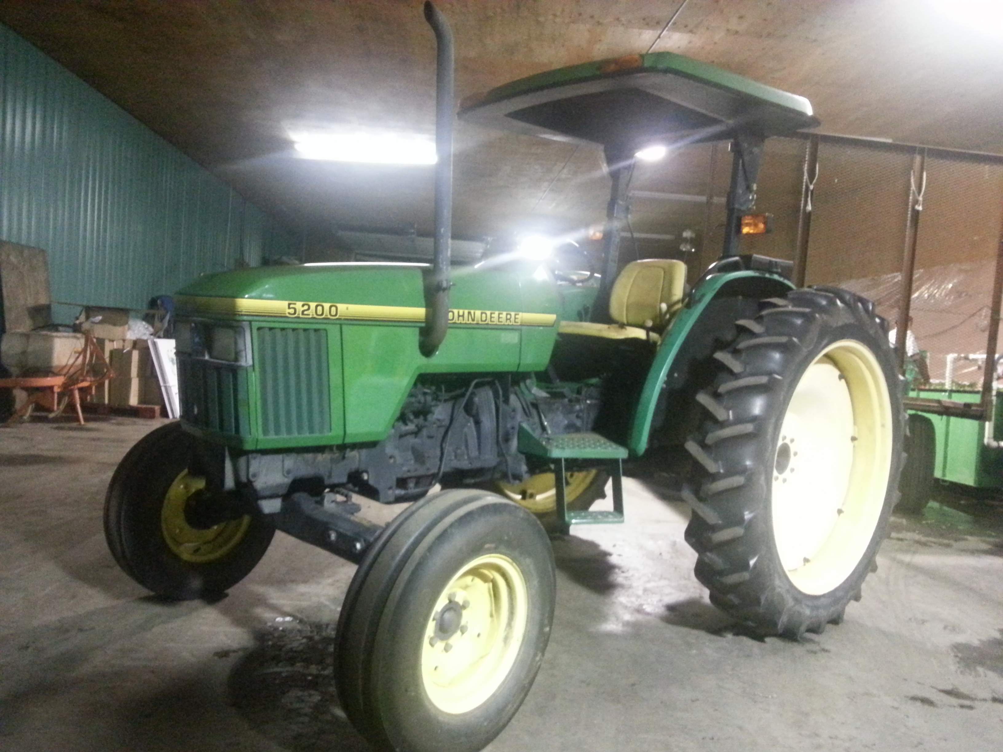

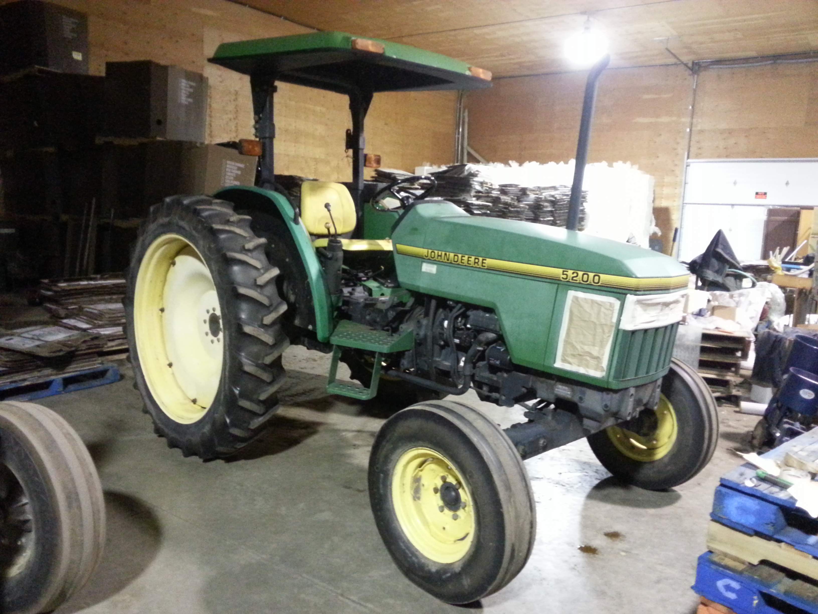

Here's a few of photos of the 5200 being all cleaned up for once in over 15 years. Hope you guys enjoy.
I used Meguiar's DA Power System with Ultimate Compound, Ultimate Polish and Ultimate Wax. I used the compound 1 time on all the body parts. Then polished 2-3 times, fenders only 1. Then finished up with wax doing 2 layers on the hood and panels and fenders one time. Before this I power washed with a 3200PSI Cold Water, then I used shop towels rubbing the surface (lots of elbow grease) :( to remove water spots, oxidation to make it easier with when using Ultimate Compound. Possibly will do the canopy in the winter. For now, its good enough for me.
Picture 1: Cleaning up and small preparation.
Picture 2: See it's all pretty again. :D
Picture 3: Cleaned all the tape off. Ready to get dirty again. :laughing:

Looks nice! Peanut butter works good to bring the black back to oxidized black plastic parts. Apparently it is the oil in the peanut butter.
   / Deoxidizing, Polishing and Waxing JD 5200
Thanks, the peanut butter will be a mess to clean up though!
   / Deoxidizing, Polishing and Waxing JD 5200 #4
Just a dab on a clean rag. Rub it in real good and then wipe off.
Although i'm a big fan of Meguires products especially for paint, there is one for black plastic from Mothers (Back to Black) that does a good job on old faded black plastic
