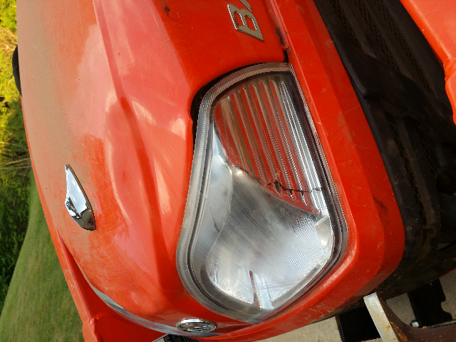

Today I was cleaning with my BX25D and a log hit the hood. Now I have a dented hood and cracked headlight. I am debating to live with the dent. Claim it on kabobta insurance or just pay for repairs out of my pocket. What would you do?

Sorry forgot a picture.

Thats a shame, you're going to have to repair or replace it If you want to tractor to remain in good shape, some people will say its just a tractor. I guess if you where one of those you would not even post about it.
Do you have a loan on it from Kubota and they made you buy the insurance? If so I would put it on the insurance. That is what your paying for.It's still going to cost you the 250.00 deductible.
Call Kubota get a price on a new hood and light, I believe it comes painted. Then you will know which way to go. See how close it is to the deductible.

I dented the hood on one of my previous tractors. I took the hood off, turned it over, set it on plywood and hammered it back out as best I could with a rubber mallet and small ball pien hammer. Then skim coated it with body filler. Sanded, primed, and repainted. Good as new. I was lucky and didn't have to replace a headlight.
If you have ever done body work it's not too hard to repair. If not, you can live with it or use your insurance.

wood block and a dolley / body hammers.. work it out without stretching the metal. a lil filler, some sanding, some glazing putty, some more sanding.. and then keep sanding till you are at 2000. primer it. resand 400, 600, 800, 1000, 2000
then shoot the hood. should take a pint.
that's a sunday project.

After putting in excess of 5000 hours on the old L2550, I have gotten to the point where I fix what impacts its ability to drive, pull, lift or dig. Anything beyond that gets repaired if it is "just hanging on"..
I know that flies in the face of most people on this site but it is a tool and spending $500 on a hood would not happen. Besides, my tractor would look totally stupid with a bright new orange part. :)
Turn it over and straighten as much as possible, light appears to be functional so that would stay.

It would be different for you to repair but the point I was making time is money also and just replacing the hood would be better then repairing since it comes already painted.
Unless the tractor owner has experience then it's a different matter. The dent is right on the crease and lines of the hood an inexperienced person will not spend the time to repair that crease correctly. Then you have the fact when you open the hood you would have to paint that too. If you left all the hammer marks on the inside and painted over it. It would look like crap. So a correct repair would be both sides of the hood done. Yes, Kubota makes some good paint in the can but it's not hard like the factory. IMO
I know you and I will spot that kind of repair and paint job in a sec. The only thing worse on a nicely kept tractor then the dent is a halfass body repair job. I think we all can agree on that.

Well, if it like my BX 2350 it has a plastic hood. You could try to pound it back out with a rubber hammer and see what happens. Picture doesn't look too bad. If you are lucky, plastic won't crack. Good luck.
