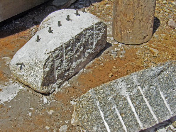

If you want to break granite in a non commercial type situation use a electric rotary hammer drill for the feather and wedge holes.:D
There is one poster here that has a hydraulic setup for splitting granite quarry rock.:thumbsup:

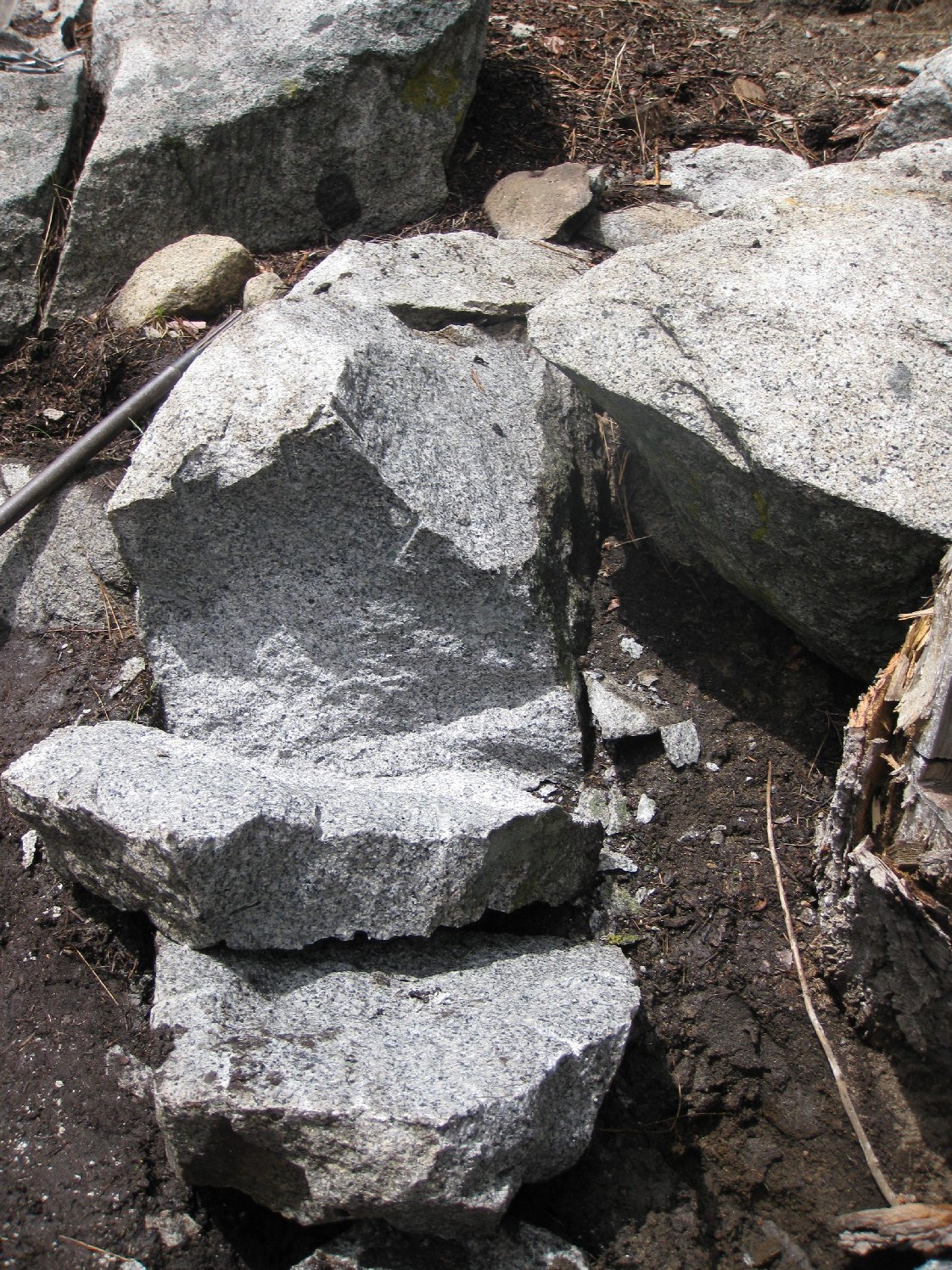

/ Demolition Hammer and Granite
Egon, Did you split the rock in the picture?
And did you use a rotary hammer, how long does the bit last? I had no good luck with drills, mayby mine are to old. I did years ago drill and dry pack steel for my foundation, with a star drill. Richard
/ Demolition Hammer and Granite #5
The rock, granite, was split by myself using a Makita 1/2 inch SDS ?? rotary hammer drill that came as a package with a 4-1/2 in. angle grinder for around two hundred and fifty or so.:D
The bit lasts me for at least a day or more? [ Thats not really giving you any proper information] Unfortunately I have not kept track of how long the bit lasts. :eek:
But I can say for sure that if you break off a carbide tip piece and not remove it a new drill bit lasts for about two whacks!:ashamed:
I don't apply any down pressure. Just keep the drill oriented in the proper direction.
Please note this is the first rock I've split and my personal knowledge is just above the zero point.
Did you have the hammer on or just the drill.
What size drill did you use?
Were you able to make thoes two slices with one drill?
That looks really good, thanks for posting that.
/ Demolition Hammer and Granite #7
Drill plus hammer.
1/2 in. drill
Carbide
one bit and drilled lots more holes.

Valley, Here's 3 sources for wedges & feathers.
http://www.trowandholden.com/store/agora.cgi?product=cat5
http://www.spartantool.us/html/splitters.html
Plymouth Quarries
Drill your holes only 1/4 - 1/2" deeper than the wedge/feather you plan to use. Granite has 3 directions of grain and can be split only two ways with the grain. As told to me by a long time quarryman: think of the flowing stream of rock as you would a tree trunk. If you've split wood you know you can split between the rings or across the rings parallel to the length of the tree but cannot split across grain perpendicular to the length of the tree. Granite is similar. Knock off a chunk with a hammer then plan your splits parallel to the way the piece broke off. MikeD74T

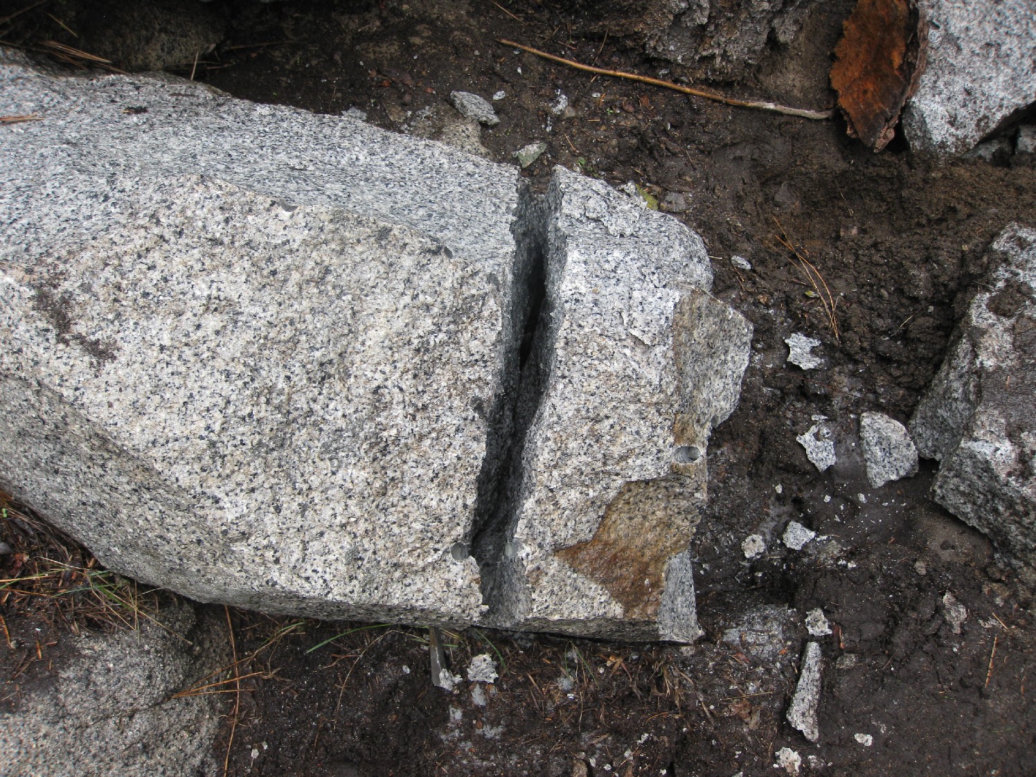

Take a look at this!
#16
sliced them off like bread. Its thrilling when they split.

/ Demolition Hammer and Granite #17
Glad things worked out for you.:thumbsup:
It is pleasing when the hammer stops ringing and goes thunk.:D

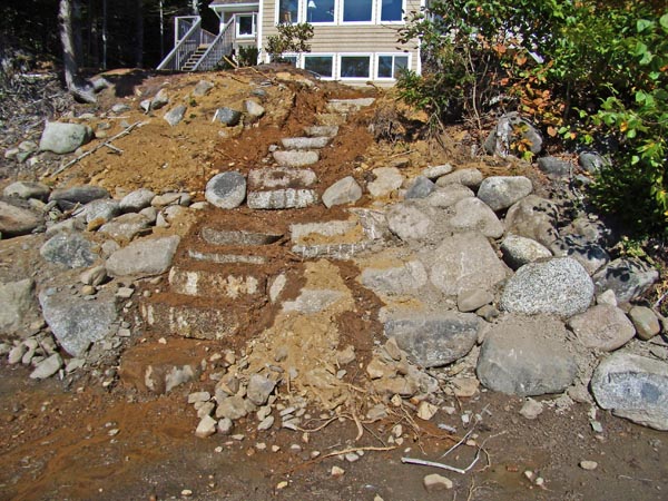

Thoes pieces will come in handy. I've been working on the monster bolder, there are several more smaller ones after that. They are in the way of the proposed greenhouse extention.

/ Demolition Hammer and Granite #19
Good thread. I have some red granite I need to break up, and wasn't sure how to drill the holes.. I plan to drill them in late fall, then fill with water and let nature do the work.
#20
We plan a larger greenhouse, some big ones in the way.
