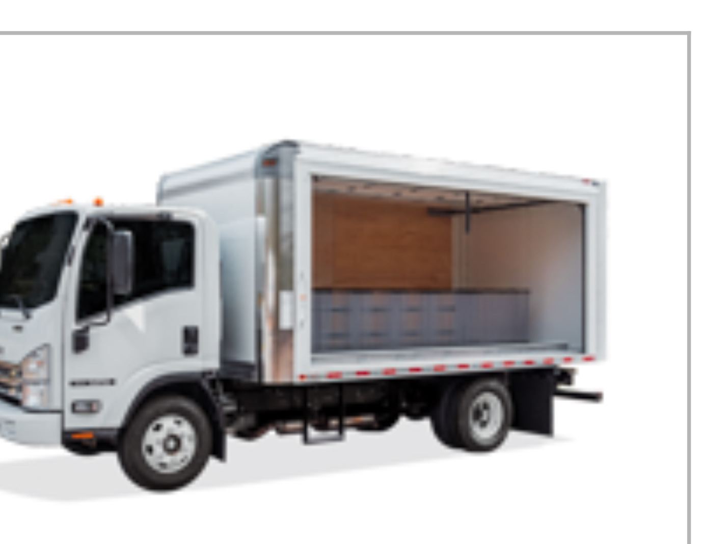

/ Delivery truck options #4
So I am assuming the power gate is of no value to you except for acting as a step at the rear of truck for unloading?
You need enclosed transport I assume given the nature of your product.
If that was me I would get another COE .... Hino , Isuzu etc. equipped with a 16 foot curtain side body and rear roll up door.
This way you would have the best of options. Being able to SIDE load long material with a forklift. Unload similarly or easily by hand off either side or the rear as you were accustomed.
Or if you wanted to get fancy get a combination van/ curtain side body. Normal fixed wall on driver side and curb/ curtain side
Send me a check and I can have it built in Canadian dollars for you. LOL.
Something like that only smaller.

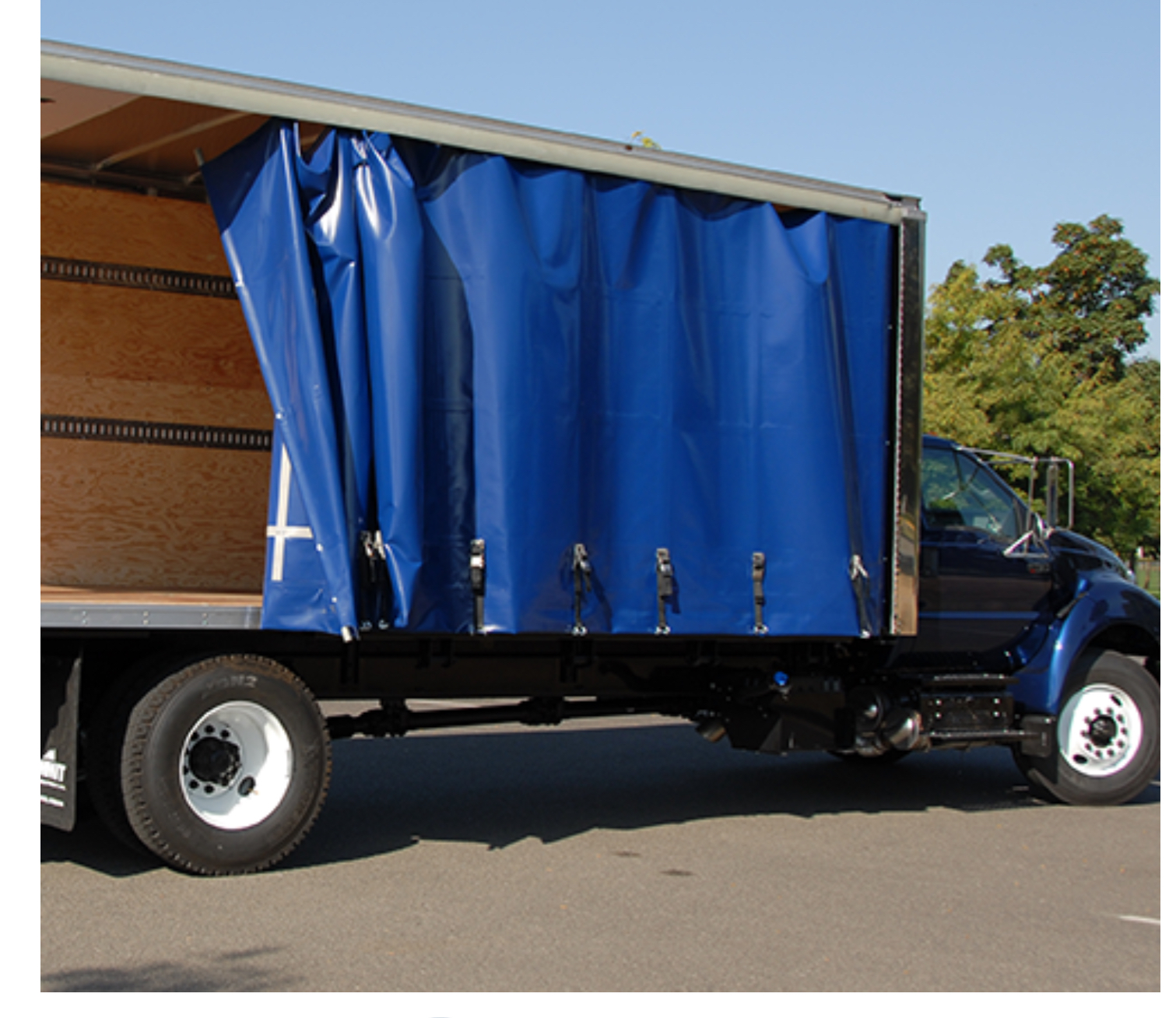

COEs are not known for being good in the snow.
I found another pic This is a glass windshield delivery truck and doesn’t have the curtain side but you get the general idea.

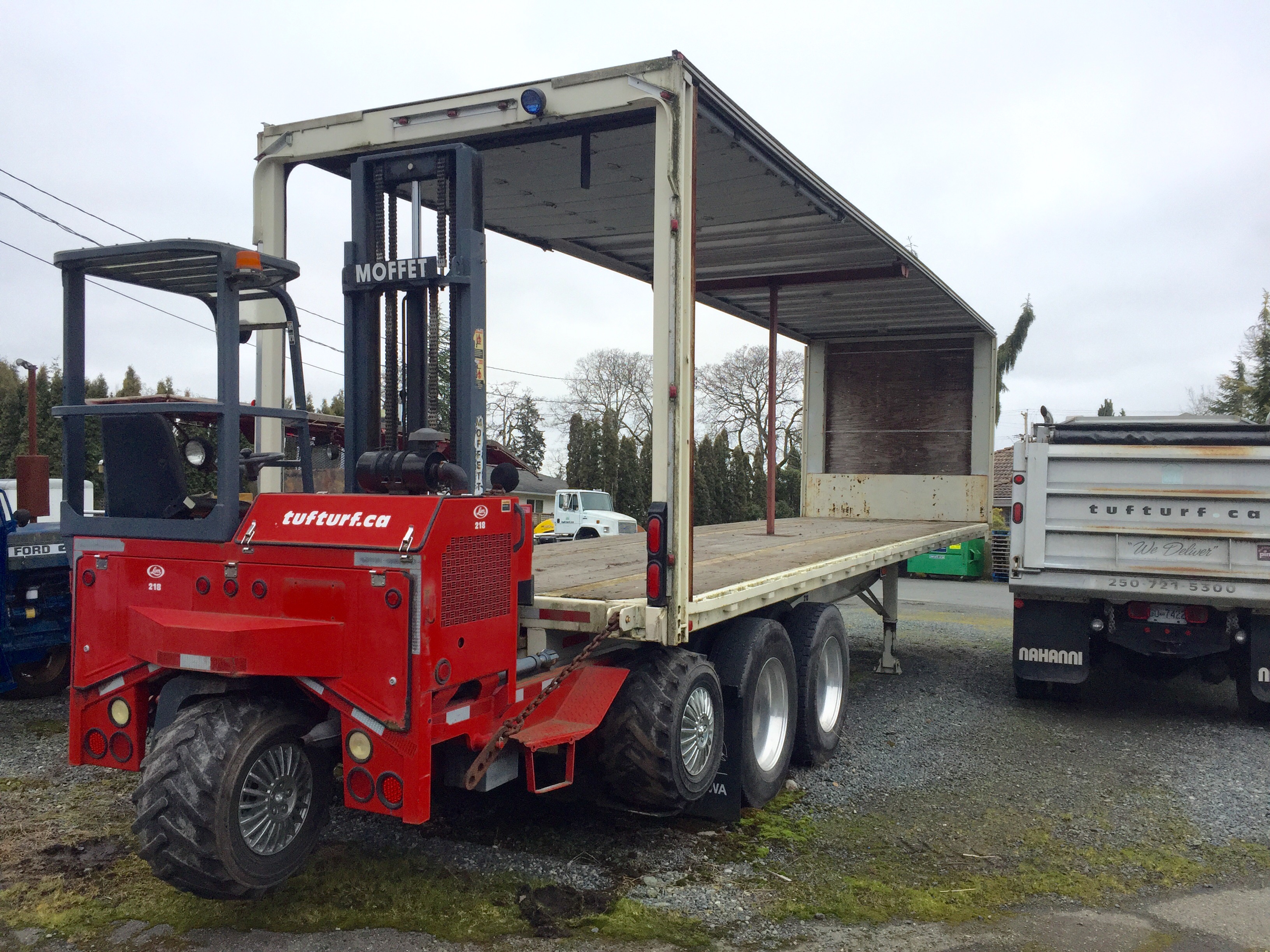

I sold this unit a while back. It would have worked for you also.
You would just have to ramp up production and buy an armored car for your bank deposits.
Somehow missed this post.
Ummm, yeah, sorta. Really too big. If we were shipping that much material per job, 99% 0f the time the receiver would have a fork lift on site, so the Moffett is not a help.
