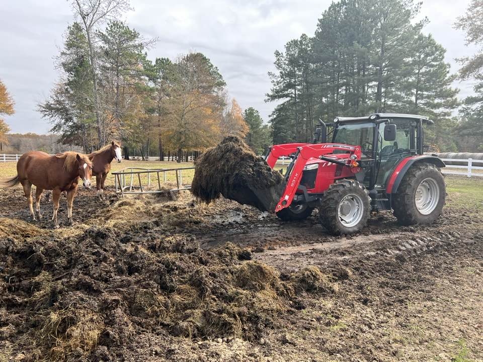

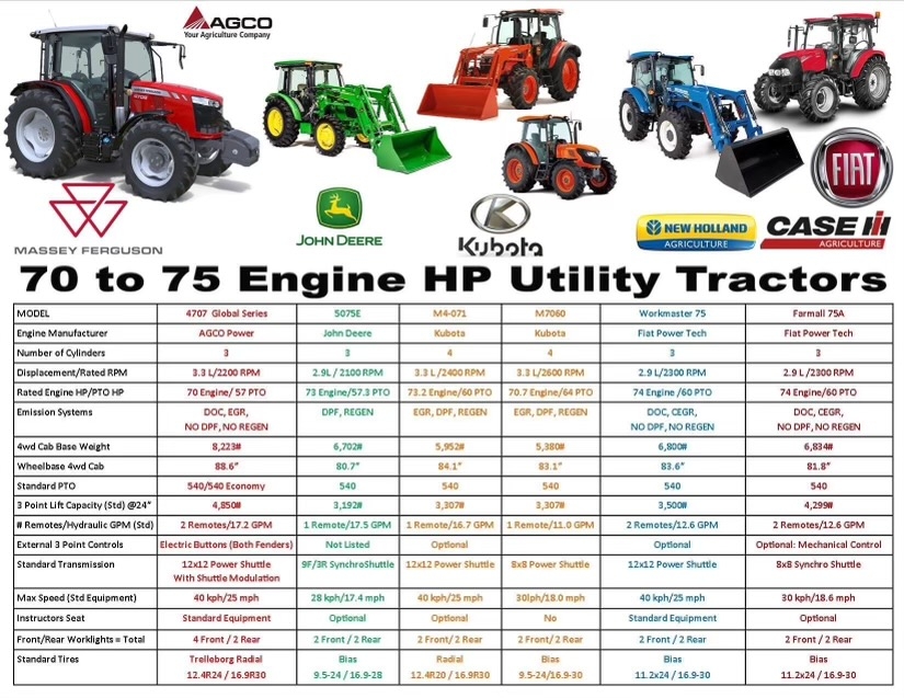

When I started lookin for a new cabbed tractor, I thought I wanted something in the 90 hp range so I could pull a 15 foot batwing and eventually a round baler. The more I looked, the more I read about DEF issues. Most people never have a problem, but a lot of people do, and when it happens, it can be really expensive. I also didn't want to have something that I was nervous about, or needing additional maintenance.
Over time, I adjusted my search to the biggest tractor that didn't have DEF. The two I liked the best where Case/New Holland and Massey Ferguson. Comparing them, the Massey Ferguson 4707 really stood out with a lot more features, more weight, and better financing then the others.

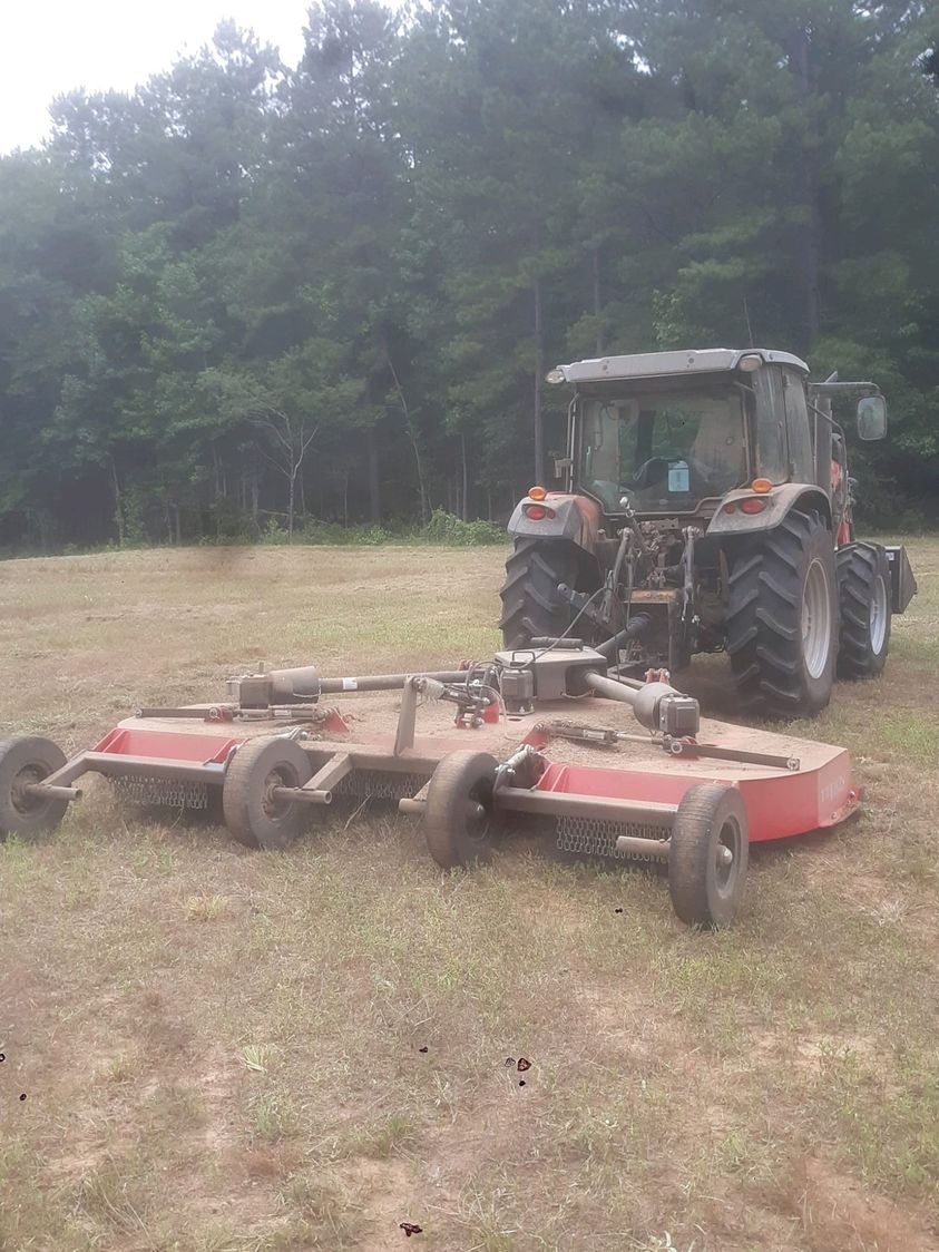

I probably could of gotten away with a 15 foot batwing, especially after I had everything mowed and it was just maintaining my place, but I went with the 12 foot batwing to be safe and know that I would have plenty of power. The 4707 pulls it through grass and brush that's over the hood. The smaller decks float over the ground for a very nice finish, and it sticks out past my wheels far enough to get to the edge of my pond without my tires getting wet.
I've had it for a year and a half now, and I like it more today then the day I got it. Nothing better then a few hours getting things done in it. Especially on a super hot/humid day, or when it's cold and nasty out!!!

That's what I am wondering Eddy, how are the Massey 4707 and Case IH Farmall 75's making out with just the diesel oxidation catalysts and no DPF or regens?
My friend just bought a Farmall 75A and he loves it, but still to new to see how it is going to be reliable.
   / DEF Tractors and Frequency of Use #19
I think for me DOC will be a non-issue. My 2019 WM75 has DOC, same as the 75A. No problems with it but I only have 160 hours on it. There is not even a mention in the operator's manual about emissions or how to operate it with DOC.
   / DEF Tractors and Frequency of Use #20
I keep reading about people with smaller tractors that Regen. As far as I know, my 70 hp Massey 4707 does not Regen. Why would a 40 hp tractor have to Regen? I could be wrong, I've only had it since June of 2022 with anything smog related happening. I just fuel it up, clean my filters, check my fluids and then put it to work.
